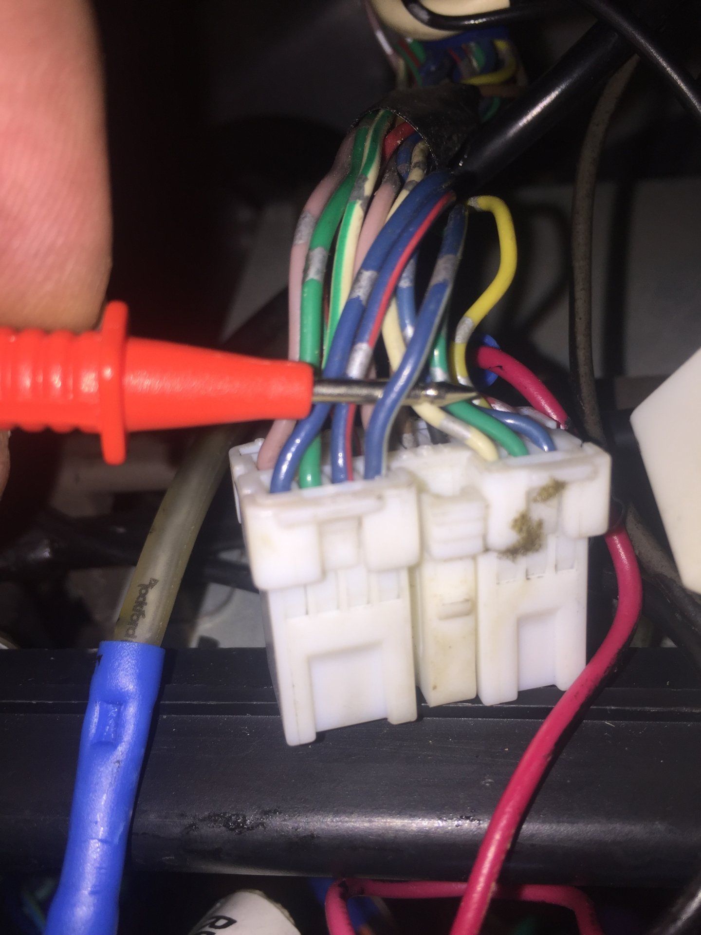

Her radio stopped powering up last week. Isolated the problem to the harness side Blue/White wire (pre-splice). Now to trace it. Tested the radio and it powered up fine. Odd thing - her radio harness ('97) goes behind the passenger side airbag and mine ('96) goes towards the DS, from what I can tell. Maybe I reversed those years but they don't go the same direction that I have found yet.

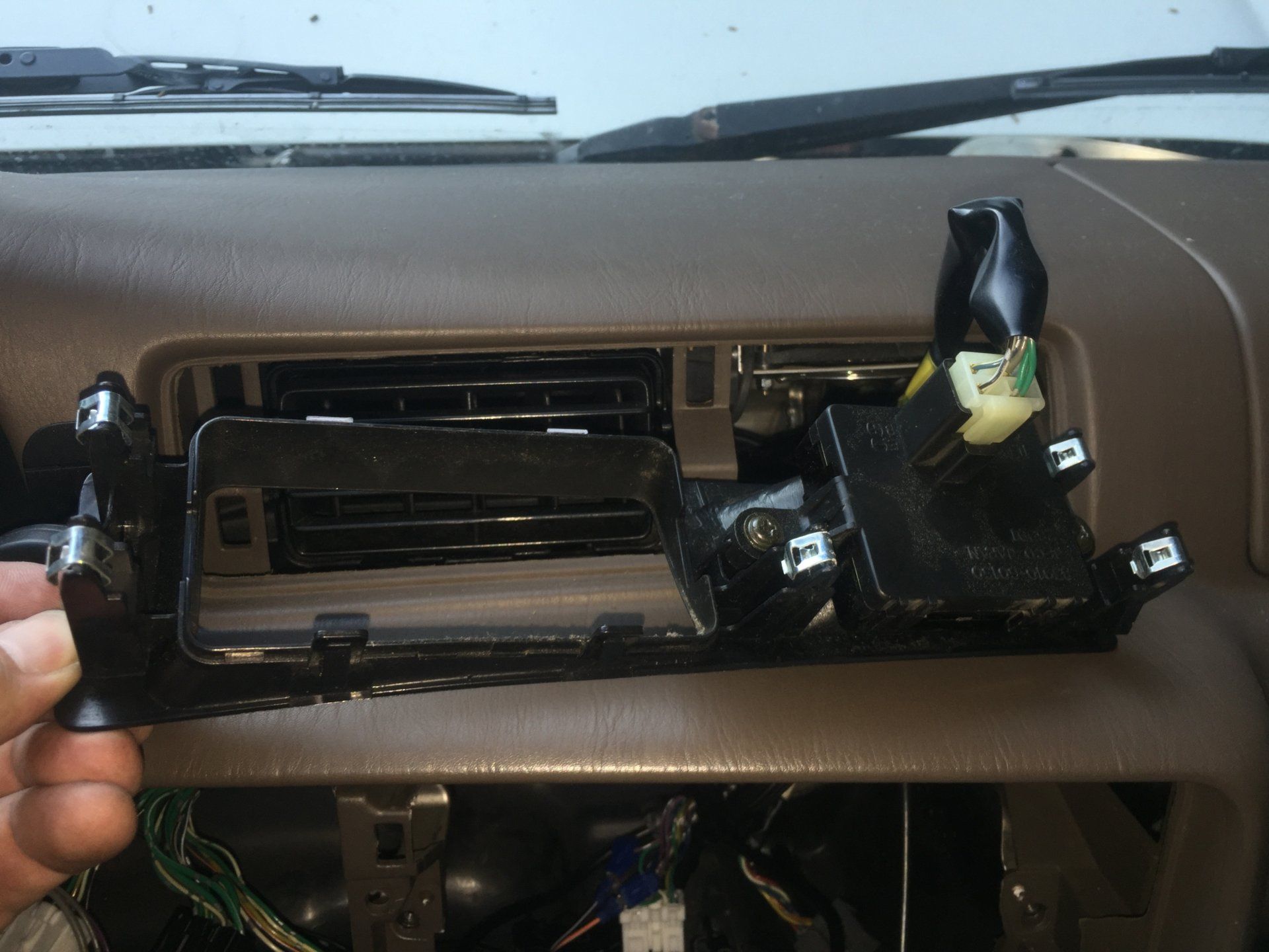

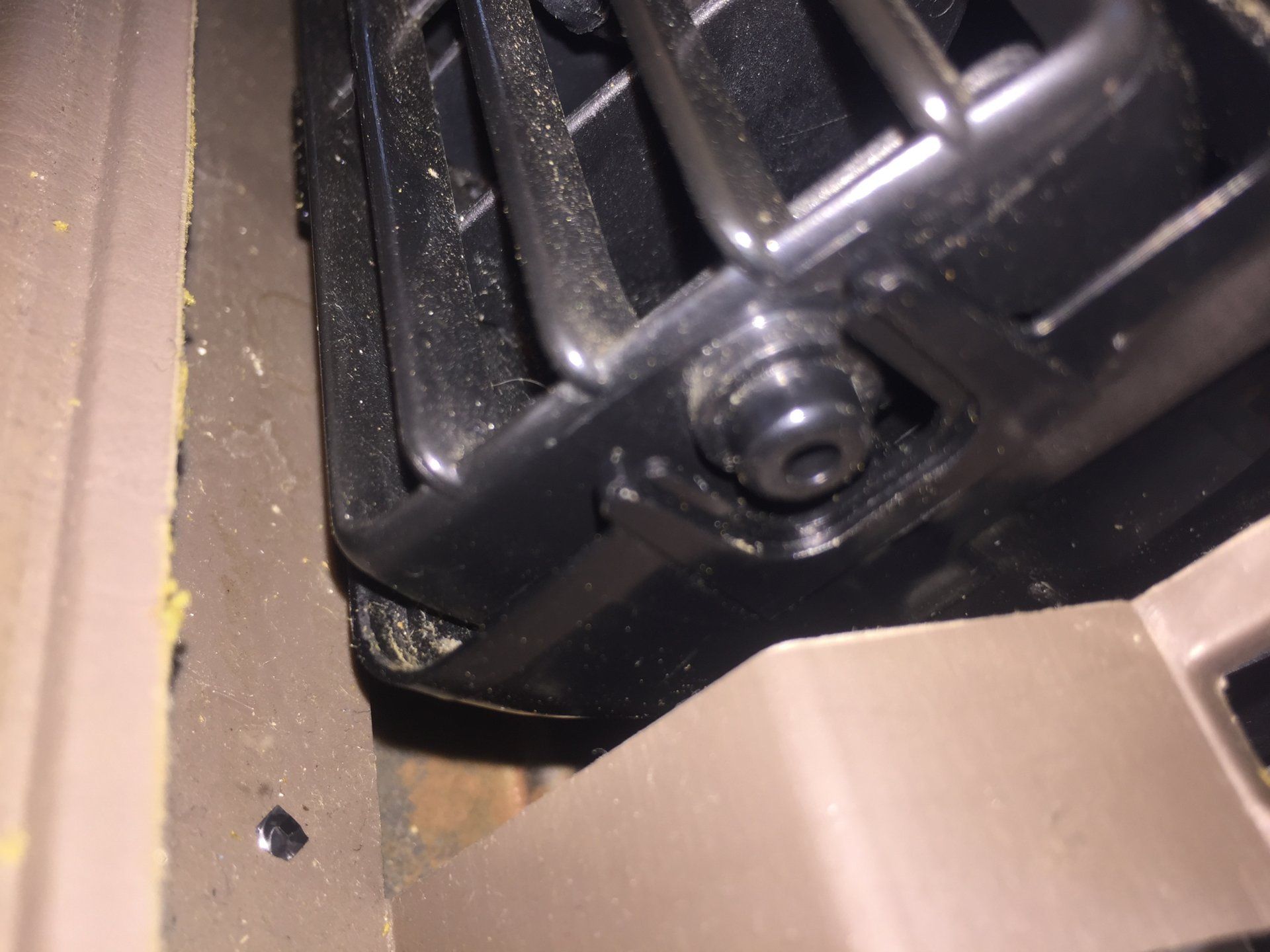

I removed my nonfunctioning '96 LX clock to find that it wasn't plugged in. Didn't matter. Plugged in, it just sits at 1:00...until you turn on the headlights, then it flashes in no discernible pattern . Now I know why it never worked since I bought it. Everything else that gets power through it works just fine. Oh...and all I broke while removing it was this...

Thank you for posting the shot of the clock and vent surround. I didn't know how it came out. Lately I've heard a rattle behind mine and wanted to put it for examination.
It’s a lot safer to go in from behind the radio and press the tabs out instead of prying it out from the front. Just beware that you stand a 50% chance of destroying the hvac vent no matter what you do.
