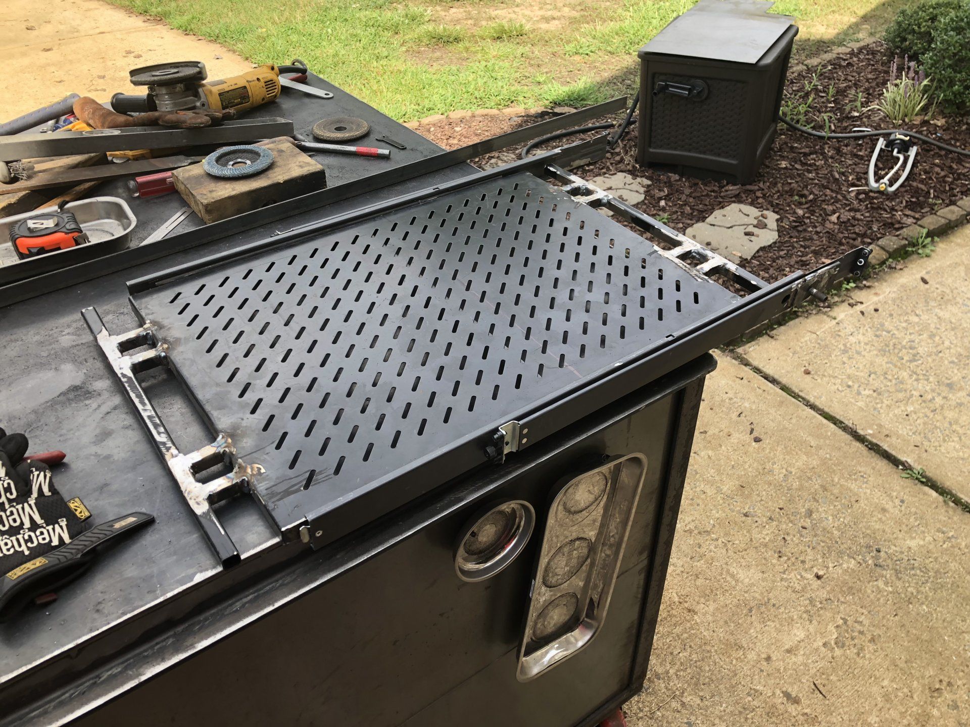

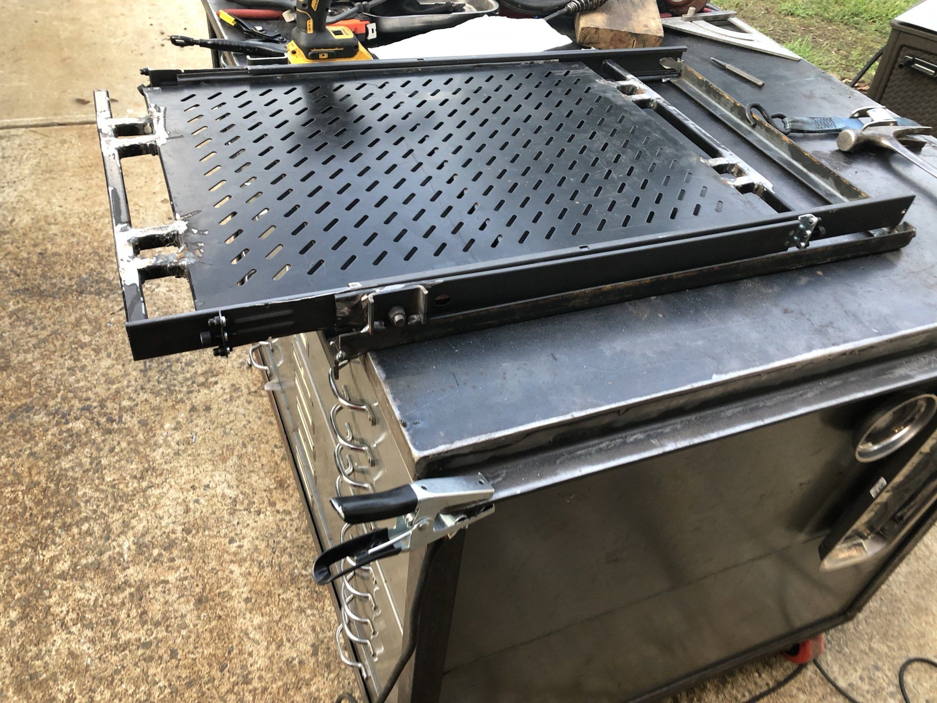

So i felt as i was to prepared for Logan's Run with the cruiser so i decided to start a last minute project on it, ARB fridge slide out. We planned on doing this last year before Logan's Run but we didn't really have a plan so that fell through so we just temporary used ARB straps to the floor. Well a year later me and my dad finally came up with somewhat of a game plan, but with him not being able to help with his shoulder and only his ideas and having to put it together is very interesting, So i'm kinda going into this blind. So far its going good and coming together but in my opinion it could be better... Tomorrow hopefully will have it finshed, but you all know how that goes when i say that:)

Badass! Why does it tilt down?
For easier accessibility to get into the fridge, so you can pull it out and tilt it down to sit on the tailgate to get into the fridge. Going to put a strut on the back to make it easier for putting it back into the truck
Very cool and looks great!!

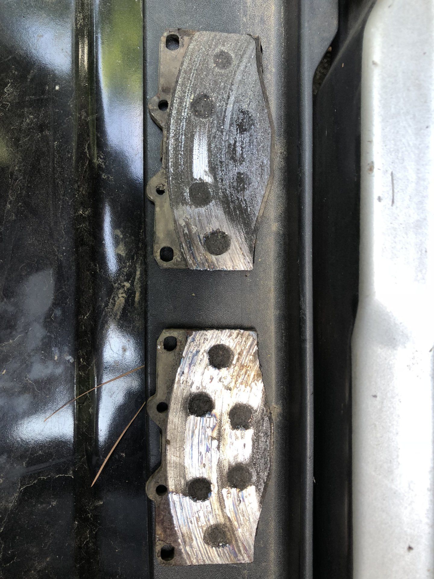

I did nothing so exciting as others. Pulled into Brevard Friday evening for a bluegrass festival and heard that horrible grumbling from the front that indicates metal on metal from the front...
Auto Zone was the only place that could have pads for the 77 by Saturday AM.
Picked up the pads and a few tools and tore into it. Found the outer pads pretty well toasted
Rotors were amazingly OK. Inner pads had 1-2mm left (thank God). Turns out the AZ pads were 4 outer pads. The inner pad has a slightly different shape. So I’m sporting new oysters and the minimally effective inners. And I’ll grind the other two to shape this week.

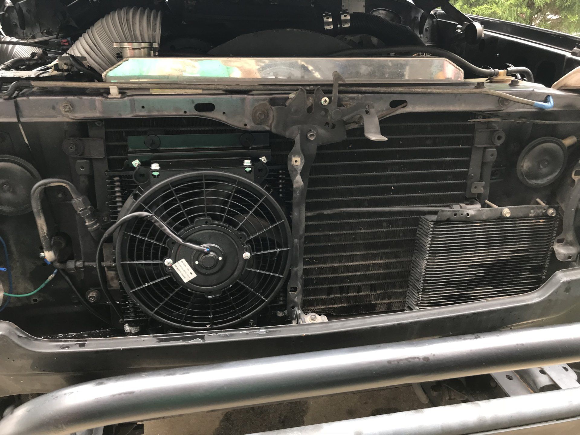

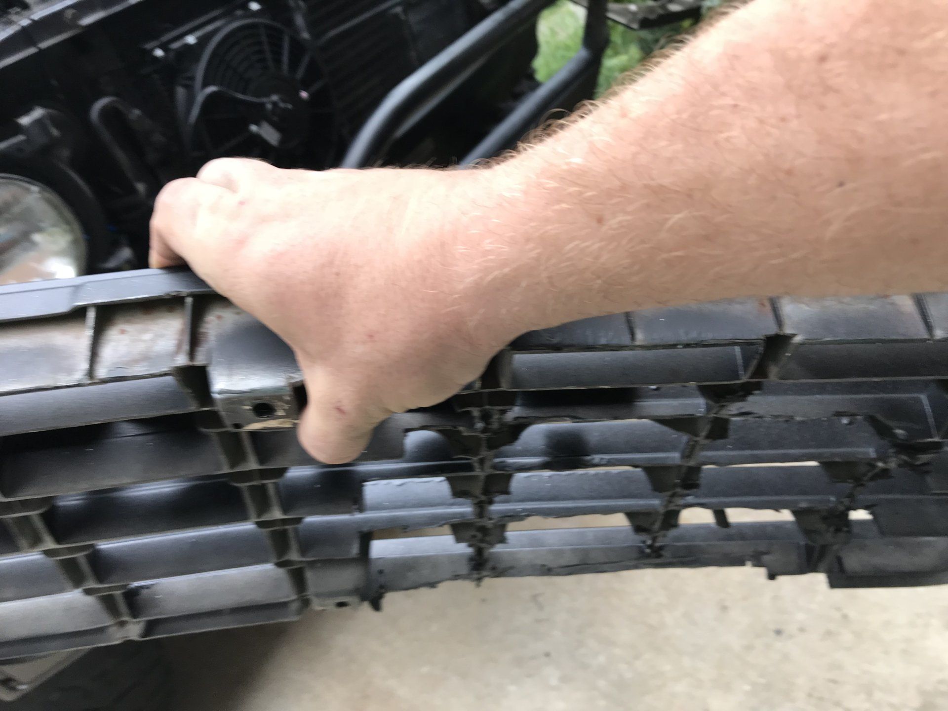

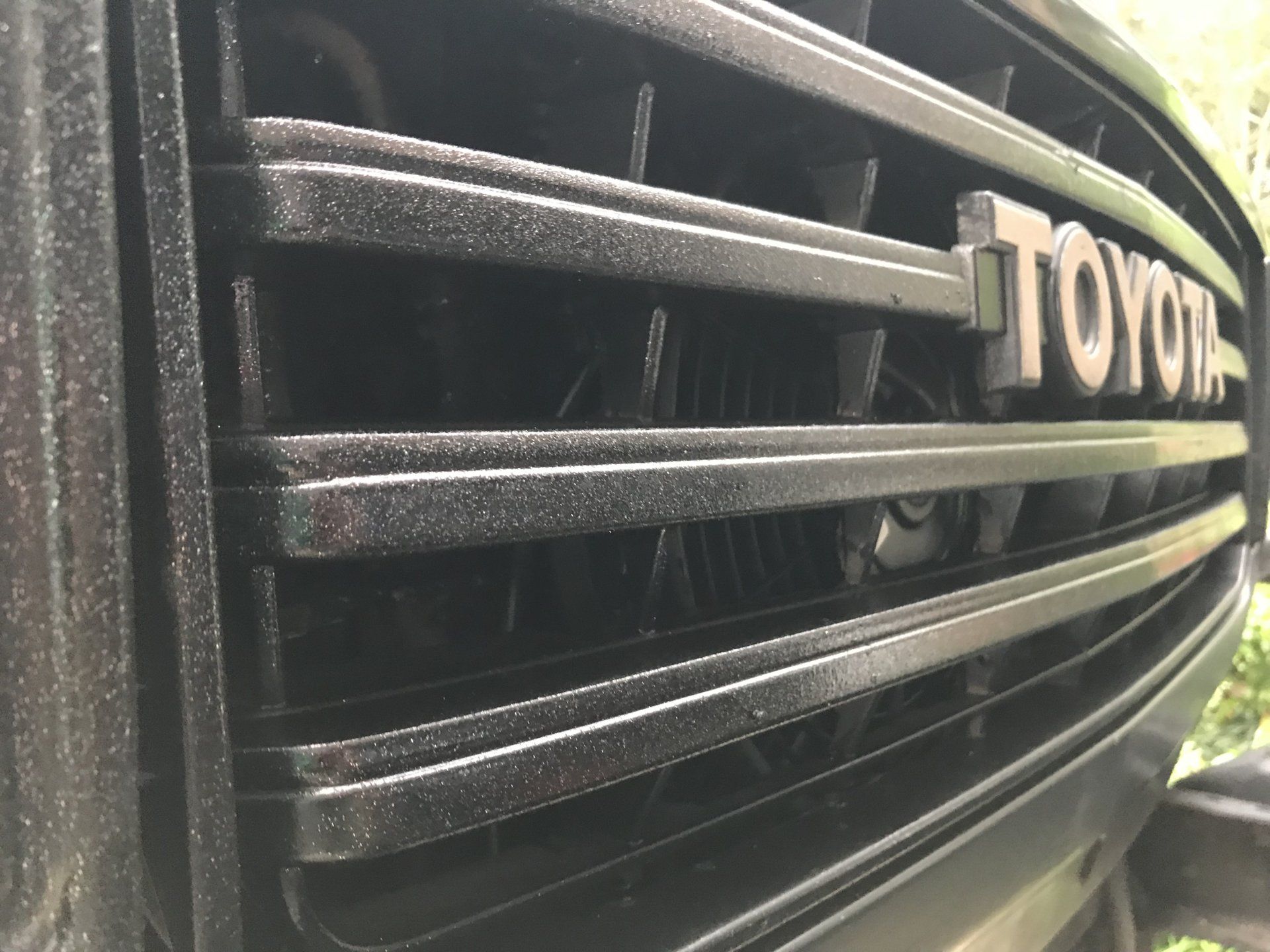

Basic but fiddly and time consuming crap: Replaced the small, no fan, poorly placed behind the cowl, transmission cooler with a higher up, larger, thermostatic fan cooled one. Took a lot of trimming on the grill to get it to fit. Had an old throw away grill to use, so it got a fresh coat of black metallic along with the headlight surrounds.
I ended up wiring it without the ignition so it’s gonna keep blowing until the radiator is below 145, regardless of the key position.

Got it all finished up today, just gotta add a lock for the slider so it doesn't slide out when driving.
