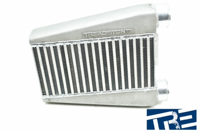

Ok here is what I would do.....
I agree with you that if you rotate the turbo to point directly at the TB you won't fit the MAF, BOV, etc that you would need in what would be about 6-7" of pipe.
I might just go ahead and rotate it down... point the turbo outlet down and bite the bullet and grab a cheap intercooler that has inlet and outlet on the same side. Something like this:
But in a 3" instead of a 3.5" so you can just slide it behind the passenger side of the grill. Route the compressor outlet to the bottom and take the outlet and bring it back to the TB. It will require you to cut a couple holes in the apron, you can see how this was done in the 6bt thread, he did a great job.
As for the water line you could gingerly take some (maybe 1/4") off the compressor housing once you find out just where you want to clock it. And cut and bend the water line out of place. For my build, I am going to cut it out completely, put an AN fitting on the 2 bolt flange and run hose.

I was planning on that basic shape of intercooler, but actually placing it facing up (top mount style) but behind the passenger side headlight. Like a top mount, but in front of and to the side of the engine, rather than right on top of it for better temps.

Yep, I am literally going to cut the pipe off right at the 2 bolt flange on top of the thermostat weld an AN fitting on and route a hose for the entire length so I can put it wherever I need to. Part of the fun of being the first to try things. haha. As long as you have a scoop or something for the intercooler, you really need some direct air flow. Ducted A/A intercoolers are about 73-75% efficient and A/A without airflow are as low as 20%.
