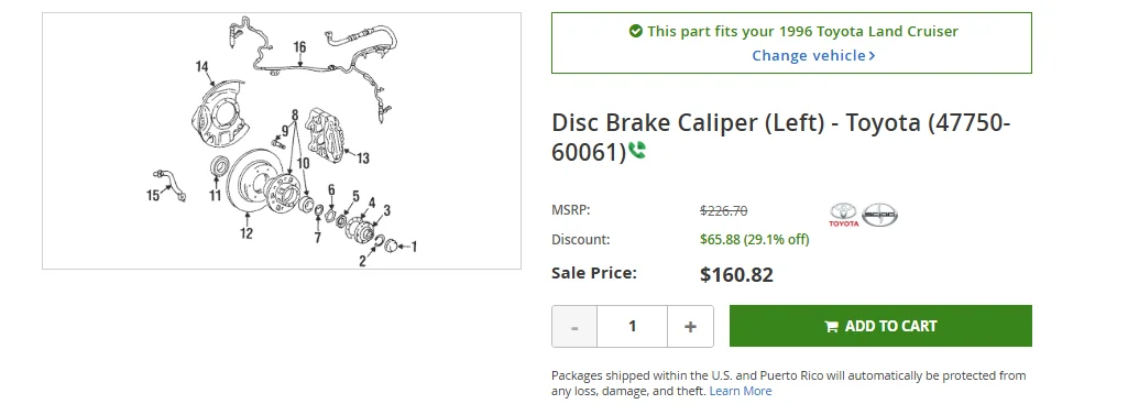

$160 for a '96

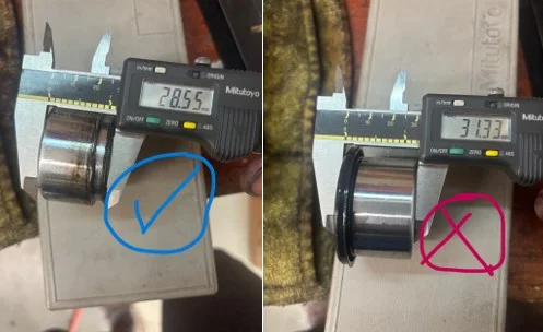

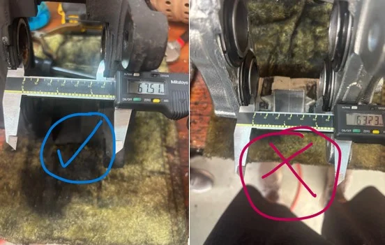

Public Service announcement
These reman calipers are a great deal, and look really good. However I was the lucky one that received one rebuilt with the wrong pistons, and pads would not fit. After much struggle I figured out the issue was that it was rebuilt with longer pistons.
Pictures for reference, and double check the measurements before you spend a bunch of time like i did ;)

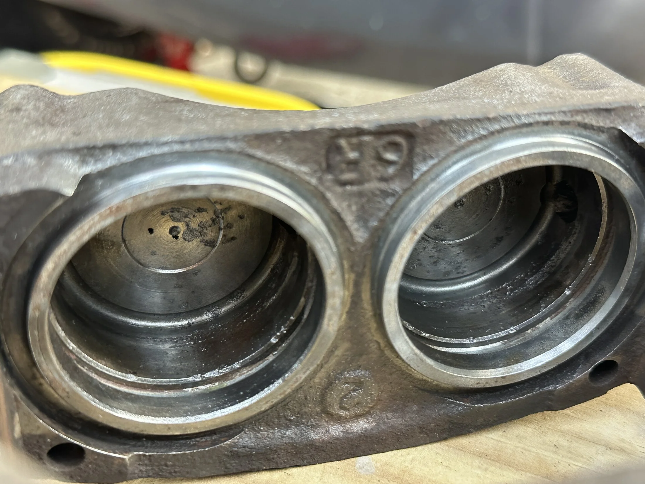

Think this a good place to ask - What about the early 1992 3FE FJ80 calipers? Saw a screenshot of @OGBeno saying 4775060030 is long gone/discontinued - Driverside LH Caliper. What are people buying these days? My brake caliper internals where the pistons live are slightly pitted - anyone tried a miniscule dab of epoxy on those pits?
Having a hard time finding a Caliper for the early 1992 FJ80's - any help will be super appreciated.
