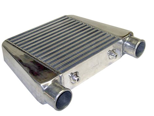

Did some "imagining" as to how things are going to fit together and realized I will literally need one extra pipe and 1 extra coupler (after returning another unused one) to make the intercooler happen. Total investment about $170?
I decided to just go for it. Thug life. I'll just scrap the idea of a non-intercooled "stage 1." I guess after all the trash talking, I couldn't end up without any CXracing products on this build. This is the intercooler I ordered: Amazon.com: CXRacing-Front Mount or V-Mount Turbo Intercooler 16.5"x11"x3": Automotive
I really wanted to make this one work ($50 cheaper), but it is just too long. ALUMINUM FRONT-MOUNT BOLT-ON TURBO INTERCOOLER V MOUNT SAME SIDE 19.75X13.75X3.5 I could chop an inch or two out of it and weld the end tanks back together (good to have friends in the bike industry), but I'm trying to keep this shade-tree :banana::banana: friendly, and I don't think most Mudders have a TIG at their disposal :eek: That and there are only so many favors you want to call in for a single project.

I'll have to talk to the dyno operator and see if he has the patience to let me swap it out between pulls. I honestly think it would only take about 5 minutes to make the change. You get 3 pulls for $120, so maybe one pull non-intercooled, then install the intercooler and two more pulls? Their literature is pretty clear on the "no screwing around if you're just paying for a baseline" topic, so we'll see.
I wouldn't even bother with that. If you do end up cutting your hood, just throw something over the vent, piece of cardboard, etc so you don't have air flow and really that intercooler isn't going to do much without air. If you want to I would do
Pull 1 with IC opening open and fan blowing front of truck
Pull 2 with IC opening open and fan blowing front of truck
Pull 3 covering the IC opening.
This would ensure the IC is hot, there is no air and you are about in the worst conditions possible.
I don't think you will notice much of a difference on your setup between IC and no-IC on the dyno. Make sure you have a very very weak spring in the wastegate!! You will have cooler intake temps with the IC when you need them, driving. You shouldn't get any pinging with 93 octane, and the stock computer going open loop as long as you stay in that 5-7psi range, but the intercooler is insurance. Usually the fans most dyno places use move no where near as much air as driving.
