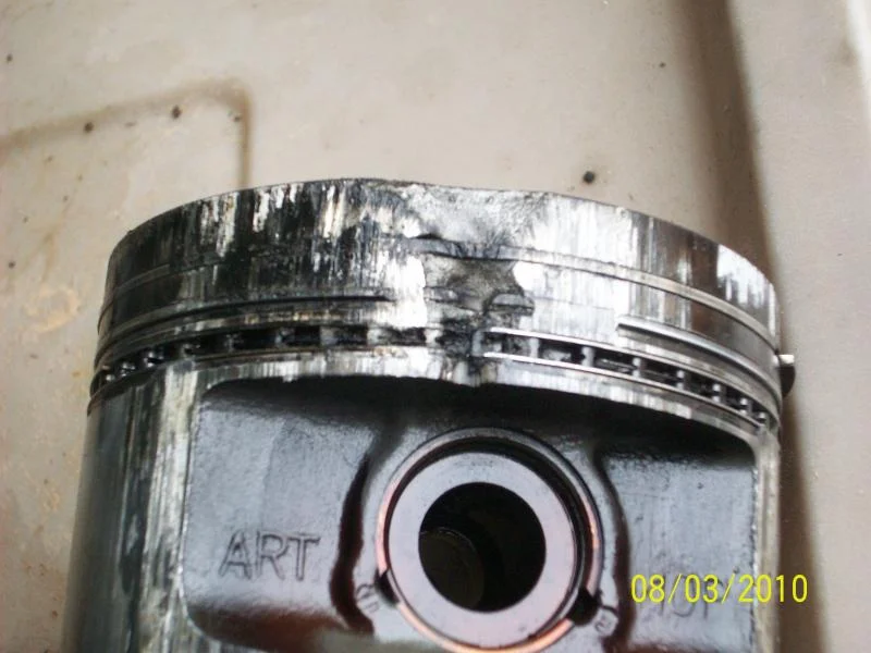

To me it looks like it ran lean. Melted piston equals really freaking hot.
Probably some detonation there too, but, none the less, it got waaaay too hot.
Again, IMO. I've used Uni-Chip in the past. I use "past" as in no one touches it anymore. For this reason.

Here's the melted piston.
Well you're entitled to your opinion ;) ...but for now there is no clear idea of what went wrong or why, so the jury is still out.
