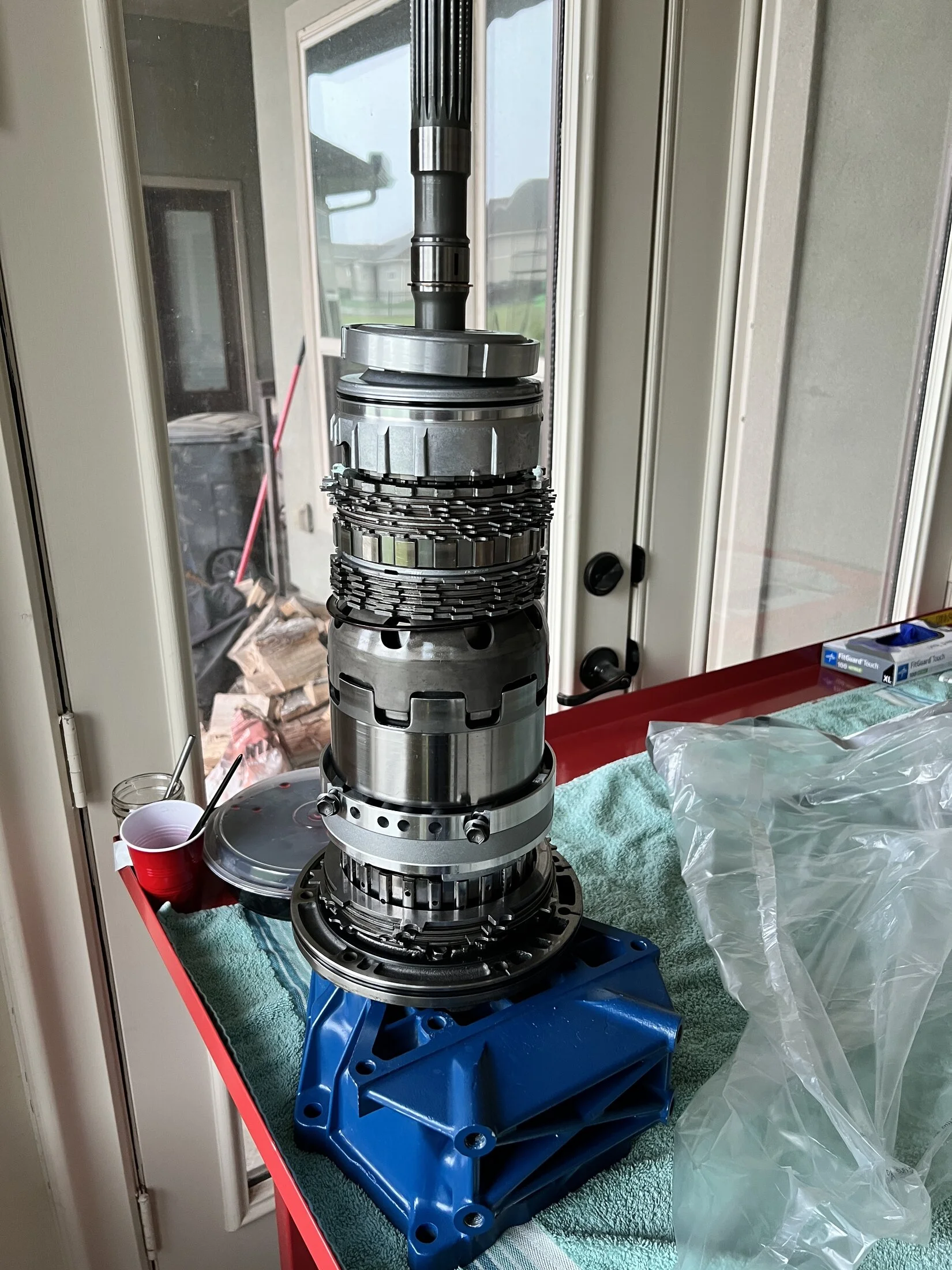

Today I started the installation process for the newly rebuilt components in my A343F transmission. This is for my 97 LC. I am currently on hold...
Following the FSM, right out of the gate at Step-4, you are instructed to install the rear planetary gear unit, the second brake drum, the output shaft, and the first & reverse brake pack. Once that is done, you are then instructed to measure the clearance of the first & reverse brake pack. The clearance is supposed to be 0.70-mm to 1.22-mm (0.0276" to 0.0480"). Well, mine came in at 1.65-mm (0.0650"). To allow adjustment of this clearance, Toyota offers a range of flanges with differing thickness. My flange is the #50 flange at 5-mm (0.1975"). So, in order to meet the specs, I need a thicker flange. The thickest flange they offer is 5.4-mm (0.2126"). If I use that flange, my clearance will be 1.27-mm (0.0499"), which is still outside of the spec by 0.05-mm (0.0019"). As I see it, I have only two options.
Option-1: Get the 5.4-mm flange and accept being slightly out of spec. My question with this option is, what issues could creep up with the transmission with a slightly too large of a gap in the first & reverse brake pack?
Option-2: This is a bit more radical. The plates in this pack are 1.8-mm (0.0710") thick. If I combined one of the plates alongside a 4.0-mm (0.1575") flange, that would give a total thickness of 5.8-mm (0.2283"). This would bring the gap to 0.87-mm (0.0342"), which is right in the middle of the spec. The question here is would there be any negative outcome from placing a plate directly next to the flange? I cannot think of any, but I am not a transmission expert.
Can anyone guide me here?

To answer your questions directly:
» 1. Your shift will lag (a very slight amount, probably not so much you'd notice) because the piston isn't on the clutch pack immediately.
» 2. I'd choose this option, personally, as long as there's no damage in the case, either the bottom of the bore or the snap ring groove above it.
Yes, you can alter the stack to make up the clearance. The only critical dimension is the spring engagement that the piston has to overcome. You have to keep two things in mind when measuring the opeating clearance:
1) how much piston movement is available, and
2) the stack height of the clutch/steel pack.
These two measurements, and the "gap" in the clutch operating window are all that are involved in the clutch engagement/disengagement. There has to be enough "reach" in the piston movement to collaspe the clutches against the steels, and there has to be enough "room" in the stack window to allow the spring retainer to move the piston away from the clutch pack so they don't drag against the steels.

I hav a couple of questions, before I let this go:
» Are you using Toyota clutches? When I rebuilt the last A343F I measured the clutch thicknesses in every pack and they were within 0.002-in of each other. I also had to replace several (most) of the steels and the new (Toyota) steels were within the limits of my micrometer to measure them against their nominal thicknesses.
» Is there any wear in the "bottom" (the rear inside face) of the transmission case?
Either, or both of these, would contribute to a larger than allowable measurement.

Thanks everyone. My new steel plates and clutches are from the Transtar kit. Since this pack consists of 7 steel plates and 7 clutches, a tiny thickness variation might easily explain why my gap came in a bit large. I still have all of them so I could make those measurements to check that. However, things are not quite so clear cut.
The FSM and various parts diagrams such as, EPCdata, are not always in agreement with each other or reality. This situation we are discussing here is a good example of that. On page AT-59 of the FSM, there is a nice drawing for this first & reverse brake pack. The problem is, the drawing does not match what was in my transmission. That drawing shows 8 plates and 7 discs/clutches in the Land Cruiser pack. Mine had 7 of each. I watched a decent video of an A343F rebuild and that transmission also had 7 of each. If you look at the EPCdata drawing, it shows 7 plates and 7 discs/clutches, which matches number-wise, but the order they show is not correct.
My Transtar kit had 7 plates and 7 discs/clutches, which agreed with what I removed, and so that is what I replaced in mine. But, when I discovered that the gap was a bit too much, I will add back 1 plate taken from my old plates. Doing that, I will get the gap right in the middle of where it should be. So, funny enough, when I am done, I will have 1 flange, 8 plates, and 7 discs/clutches, which matches the FSM...
The only remaining question is where to place it. My plan was to add that extra plate directly on top of the flange, creating a thicker flange. But oddly, the FSM shows that 8th plate going in at the top of the pack. In effect there are 2 plates back-to-back at the top. SO I will need to think about that.
