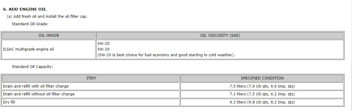

Yep. Engine actually takes ~9 quarts from dry… I learned 2 quarts is within margin of error for the 5.7 and by design. No loss of pressure even on hills and turns…
You are a lot more patient than I am. I don’t have patience for dealerships. I buy parts online and take to independents.
You have Toyota documentation to back that up?
The FSM agrees. @dcs111 gets a gold star. I was also unaware until I just looked it up.
