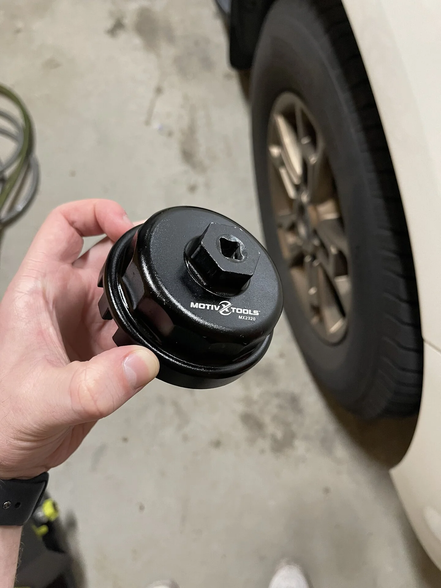

When I got my 2016 LC with 60k miles and did my first oil change at 65k miles, I used the MotivX tool to get the plastic oil filter off, and let’s just say it was a butt pucker situation where the filter housing cracked at the ribs and it was very close to me not being able to get the housing off. After that, I threw it in the trash and used the aluminum Venza filter after that. Plastic is probably okay if you are torquing it to spec yourself, but if anyone else works on your car (even dealers) there’s too much risk of not being able to get the filter housing off.

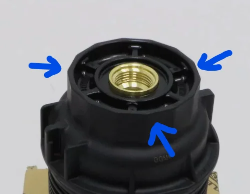

Just curious, how do you break the fins when the Motivx tool does not use the fins to undo the cap?
Ok, makes sense now Zill, thanks!

I honestly didn’t even know that filter was the MotivX one. But they have another which does grip the fins. I guess don’t buy that one if you are using the plastic housing. ;)
Yup, I have the same early version Motiv tool.
I came across at least one dealer tech post that said this style of early Motiv tool was prone to break the fins as you did when used with ridiculous torque. Where the OEM SST would not. Good to see that Motiv revised their tool.
When unreasonable torque is applied, somethings got to give. Just as possible that some of the failures were designed fuse points, so that more significant damage can be avoided. Something OEMs do with Failure Mode, Effects & Criticality Analysis (FMECA).
