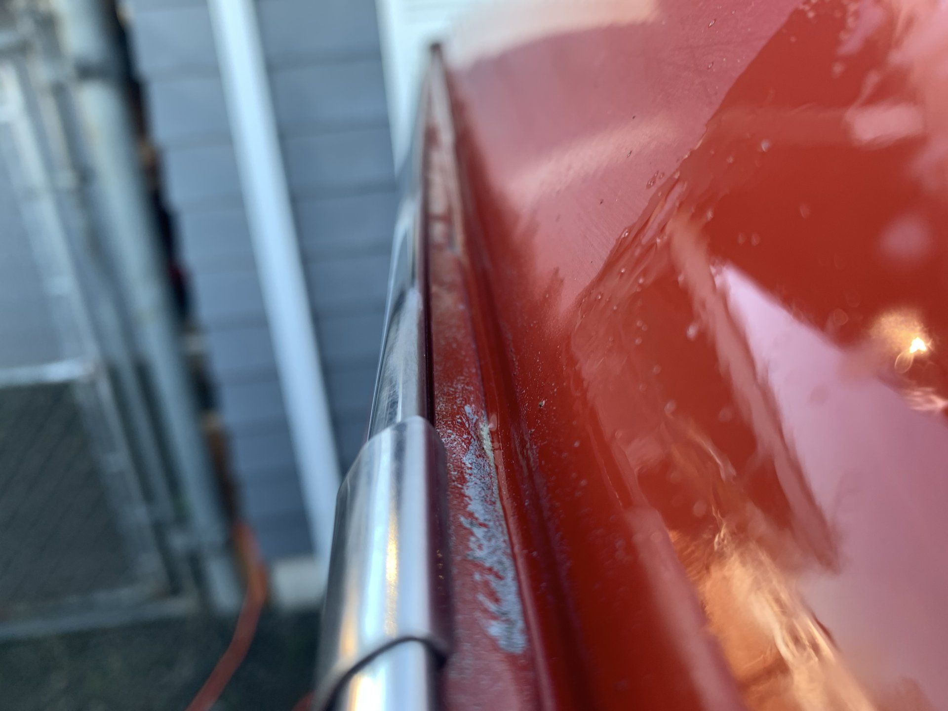

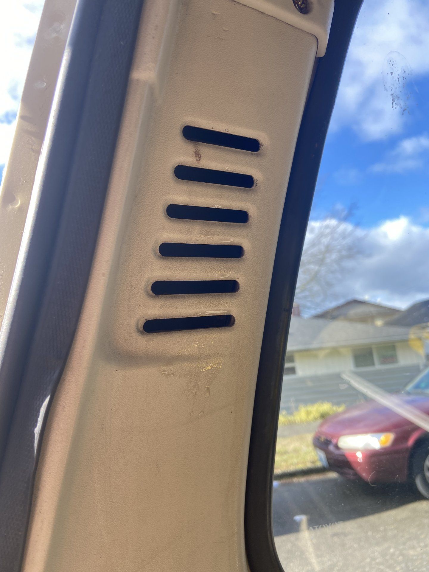

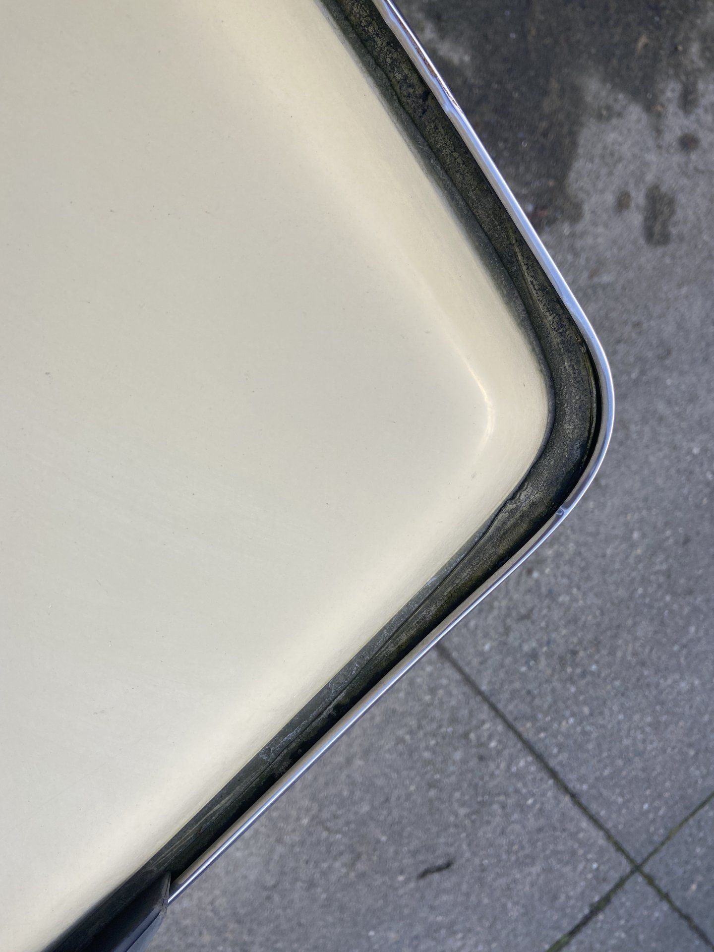

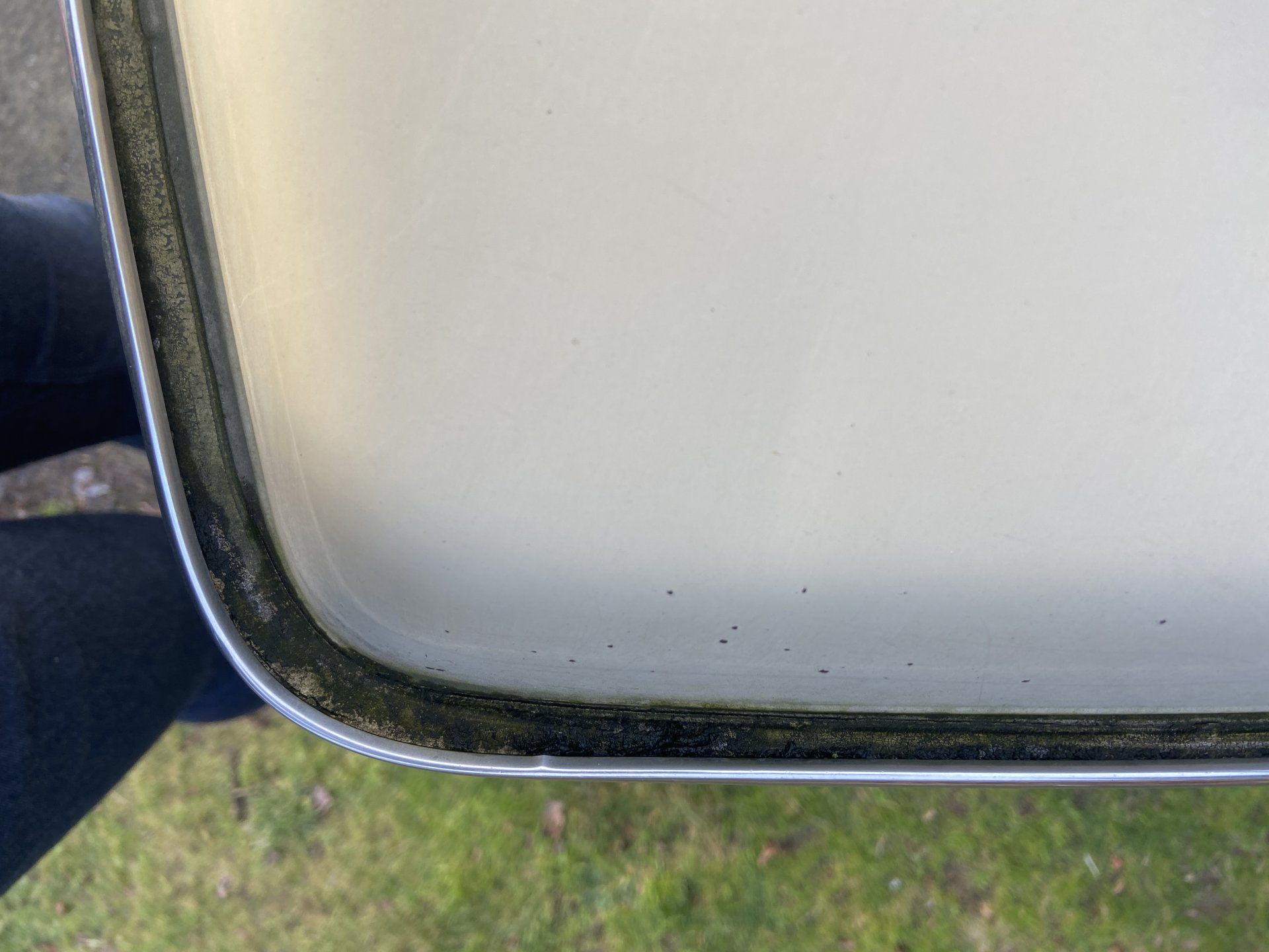

Before I shell out to repair the rust in the back of the truck I need to stop the leaks. Somehow water is dripping onto the rear floor through these vents, would this point to bad rain gutter seals? The sealant looks ok to me but I’m curious what y’all think.
I bet it’s the gutter. I thought mine was good, but I am convinced it is where the water coming in now that I have done some testing with a hose.

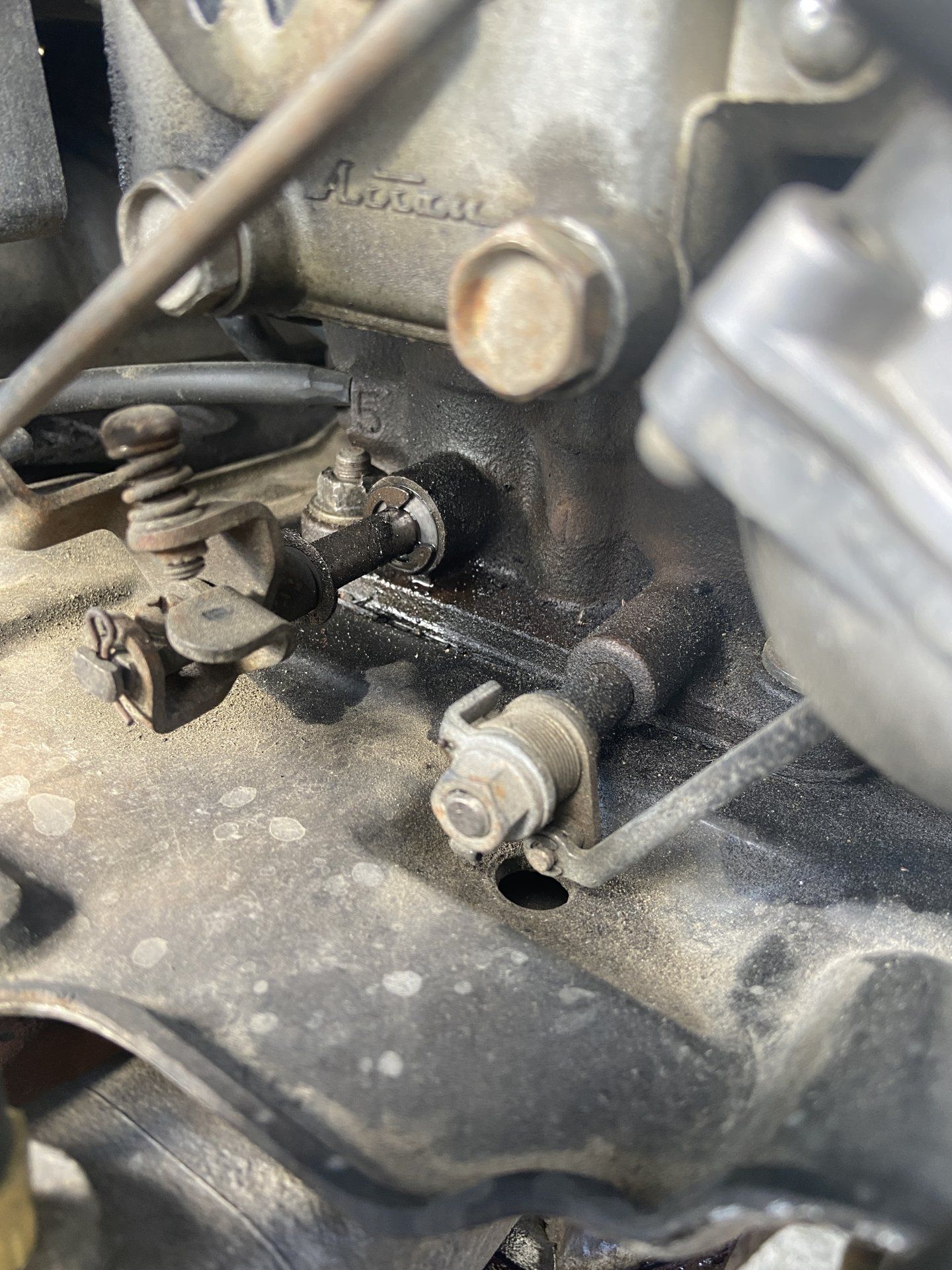

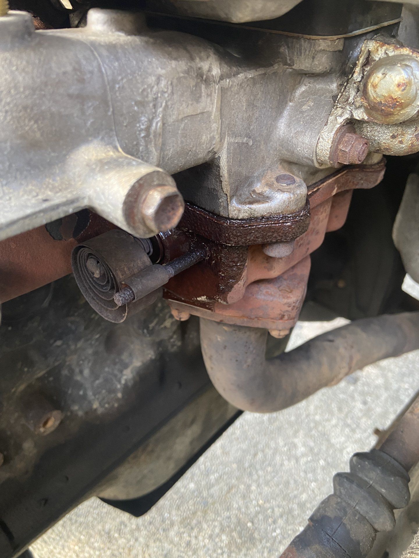

Is there a repair for worn / leaky throttle shafts? Replace the throttle plate assembly?
Thank you for giving me the right term for this part of the carb, I went through my FSM multiple times and couldn't find it. Some searching pointed me in @NeverGiveUpYota's direction and she has a few very helpful posts about having the throttle body serviced.
I wasn't able to reproduce that same gas leak today, it's possible that I just flooded the carb in that case. I'll keep an eye on it but a throttle body rebuild is probably in my future.

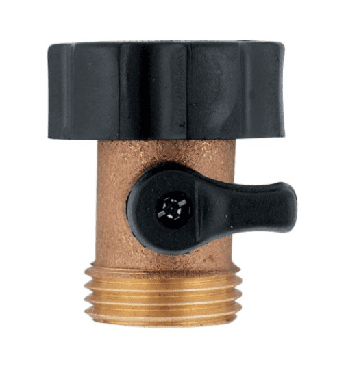

Today I'm going to flush my heater core. I get almost no heat through the front and have been relying on the rear heater to keep the entire truck toasty. I picked up a few parts from HD and plan to back flush with water, let some CLR sit in the core for 30 minutes to an hour (any opinions on timing?), back flush and forward flush with water, blow it out with a shop vac, and refill with coolant. 🤞 Here are the fittings I bought to make this easier, along with 10' of clear vinyl 5/8" ID tubing.
I brought an Audi A4 heater core back to life with CLR. First go I let it sit for 30 or so minutes, got some additional flow but still not good. Did it again and let it sit for 2 hours IIRC and then flush the heck out of it with hot water and that did the trick. This car had no heat at all so maybe yours won't take that long, but don't be afraid to add some time to it if necessary.
