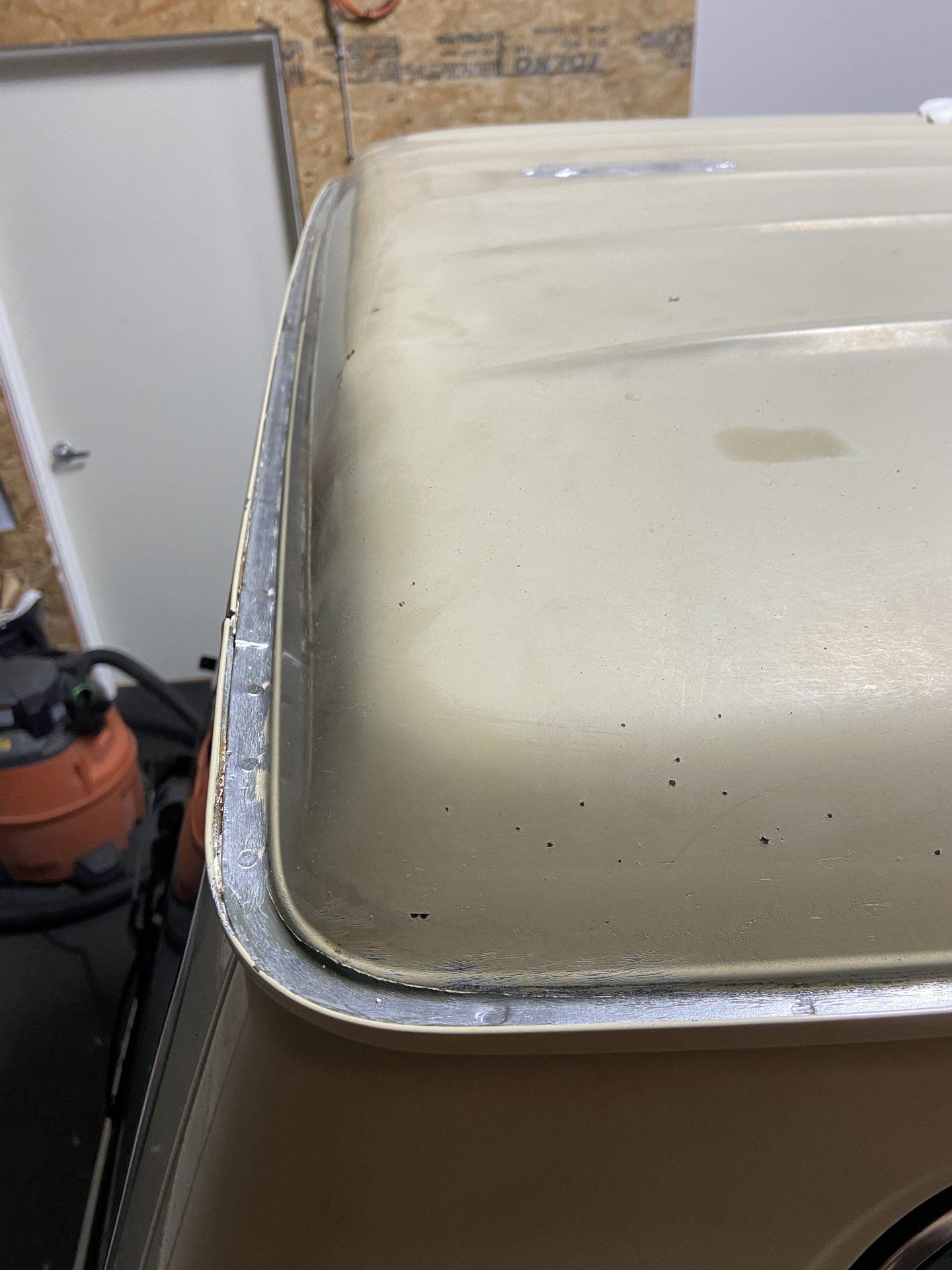

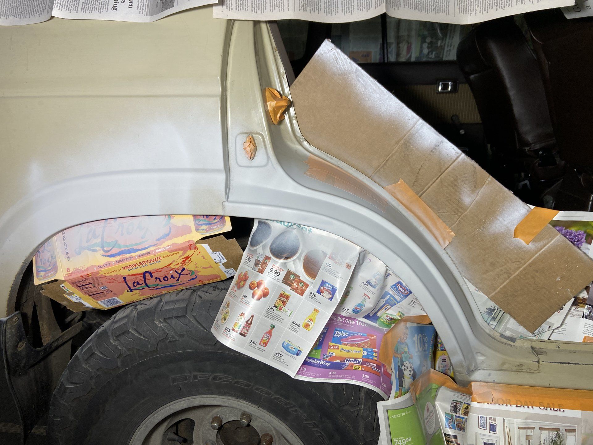

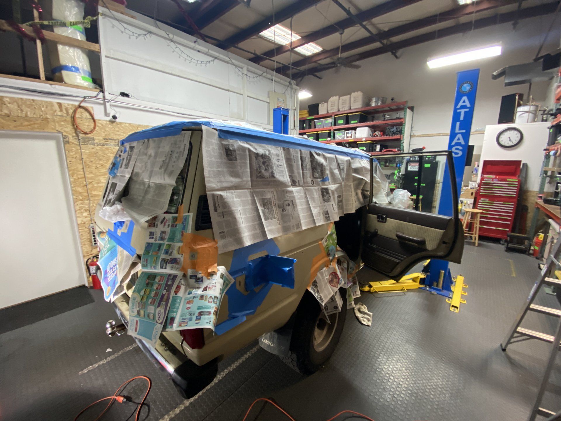

Last night I decided last-minute to tear into my gutters. The first half of this week is rain-free and I wanted to do it before I installed my new carpet. Still... I didn’t think it through. Several hours of work to remove the old stuff, 24 hours for rust converter to dry, 12 hours for primer to dry, and probably another couple of hours for the paint to dry (the sealant is fast, at least). Leaving the truck at the shop that long is a bummer but I’m working it out. Thankfully the shop has a fun little Mazda that I’m able to use to get home each night.
I bought some 2k primer for the job and I know the gutters won’t need all of it so I’m also going to hit some of the rust spots on the body as well. I sanded them with 220 grit sandpaper, wire-wheeled where needed, and masked everything off. Later tonight I’ll hit that 24 hour mark since putting down rust converter and can put primer on all of it. I have a rattle can of 464 that I’m hoping will cover the gutters and the random body spots.
The best news is that there’s almost no rust in my gutters!

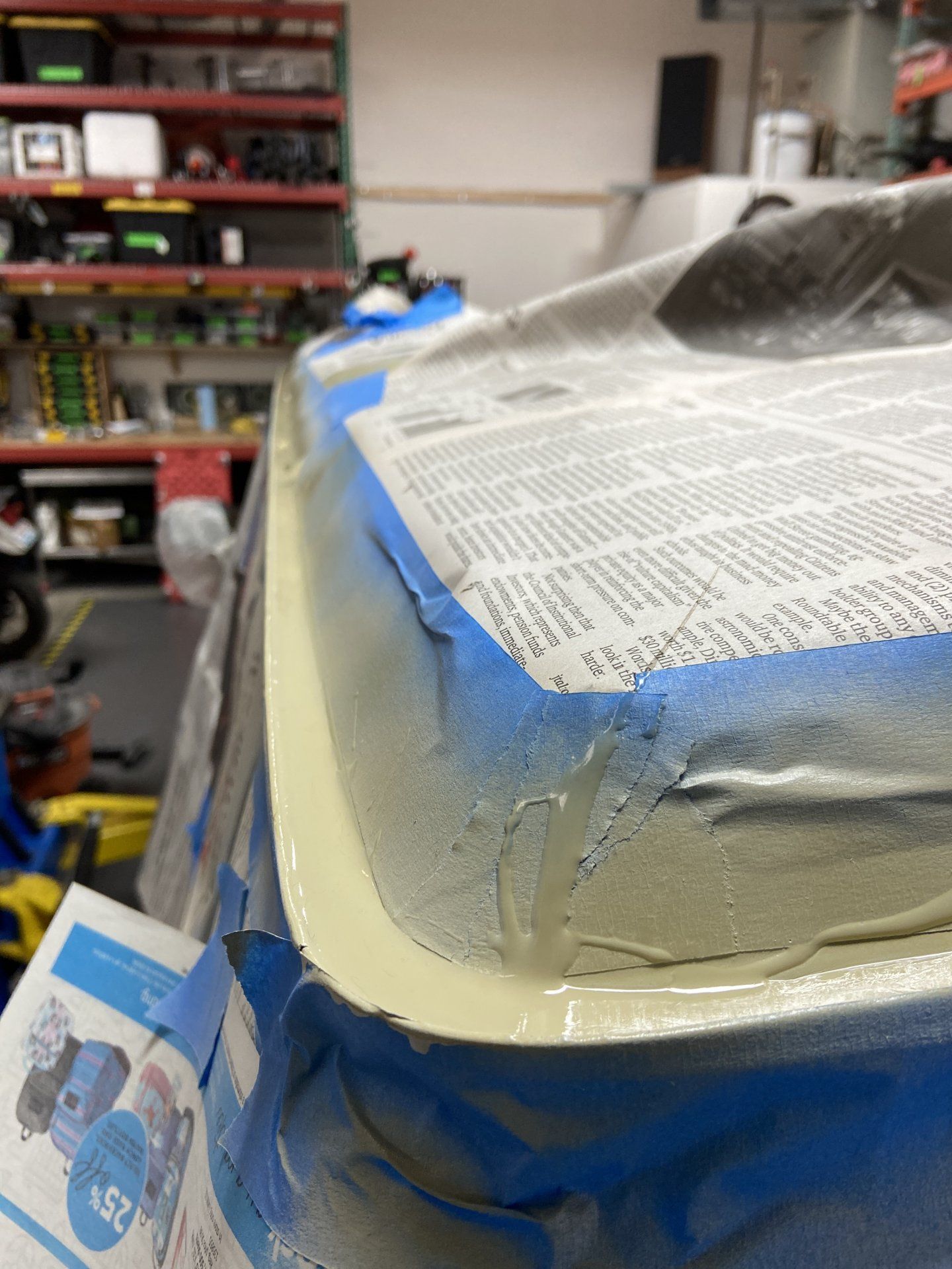

Today I finished the gutters! Mostly. 😅 I went too heavy on the sealant and didn’t have enough left for the A pillars. I’ll go buy more tomorrow and get it put in before the rain comes. The 3M self-leveling sealant (08307) is extremely easy to work with. I put some 464 rattle can on top and it looks great.
I figured that since I had paid for some short-pot-life 2k primer that I would also repair some rust spots on the body. It went well enough but I’ll probably sand them down a bit and put more paint on when I can, they’re a little rough. It’s obvious that they were repaired by an amateur but I’m happy enough with them for now. :)

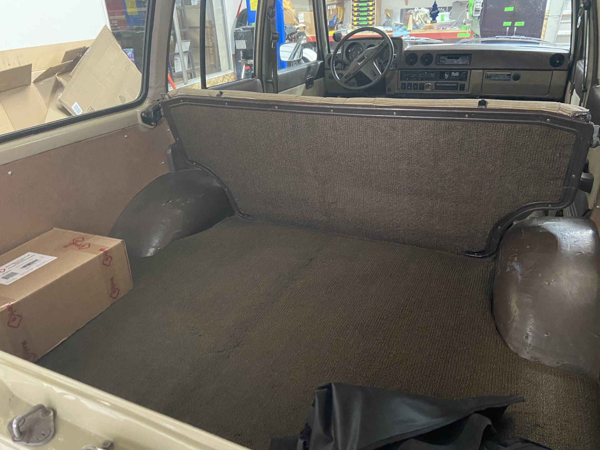

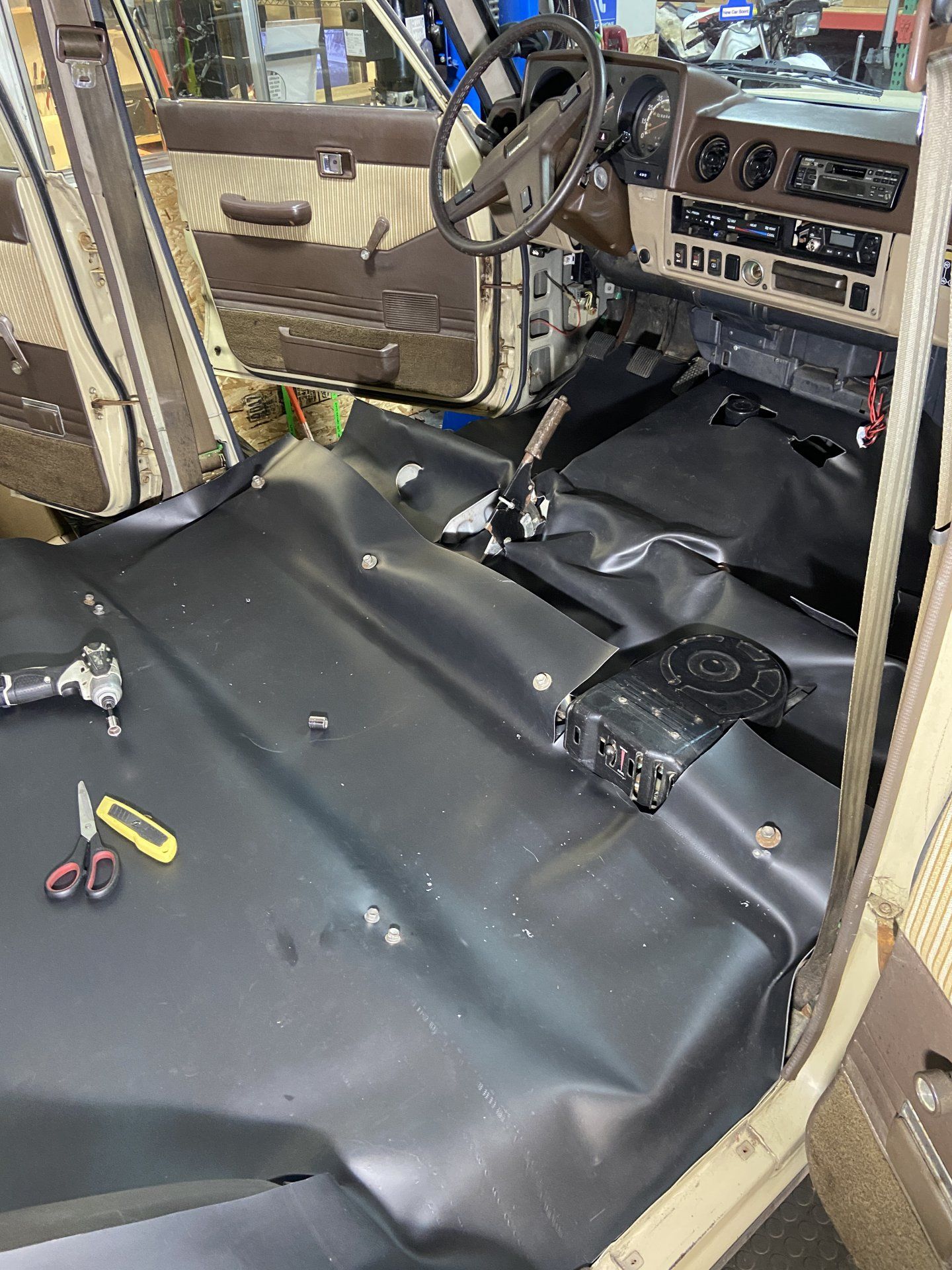

I'm aaaaalmost finished with the carpet. I made a few mistakes that I'll document so that others can carefully avoid them. I also haven't finished the sill plates yet... once I do that and fix some of these mistakes I'll post decent photos. :)
  1. I cut the hole for the rear heater too wide. Definitely start small, try fitting the carpet, and adjust as needed. Also consider cutting "flaps" around the sides to make it fit rather than making simple rectangular hole, you can tuck the flaps underneath the heater in spots.
  2. I bolted the middle piece of carpet down when it was too far to the rear. I think the seat mount molds lined up pretty well but the front of the parking brake opening is getting caught in the parking brake teeth when it goes up/down. I think I'll need to solder new holes for the rear seat mounts and console mounts in order to scoot the carpet forward a bit. This might actually fix my heater mistake and the "bad" holes for the seat mounts shouldn't be visible.
  3. I thought I could get away with lumpy MLV underneath my carpet. This is really only a problem on the front seat mounts. You can see the problem area in the second photo in post #448 above where the seat mounts and trans hump meet. I probably need to pull the carpet back, make some strategic slices in the MLV to get it to lay down flatter, and then re-do the seat mount holes to get the carpet to lay down better on the trans mount.
  4. I soldered out holes for the shifter boots. If you follow @dnp's instructions he never says to do this but I thought I was being smart. Fortunately I also cut the holes for my shifter boots too small. This is part of the reason why the carpet on the trans hump is not laying down well but it should also be easily fixed by cutting them out more to fit properly.

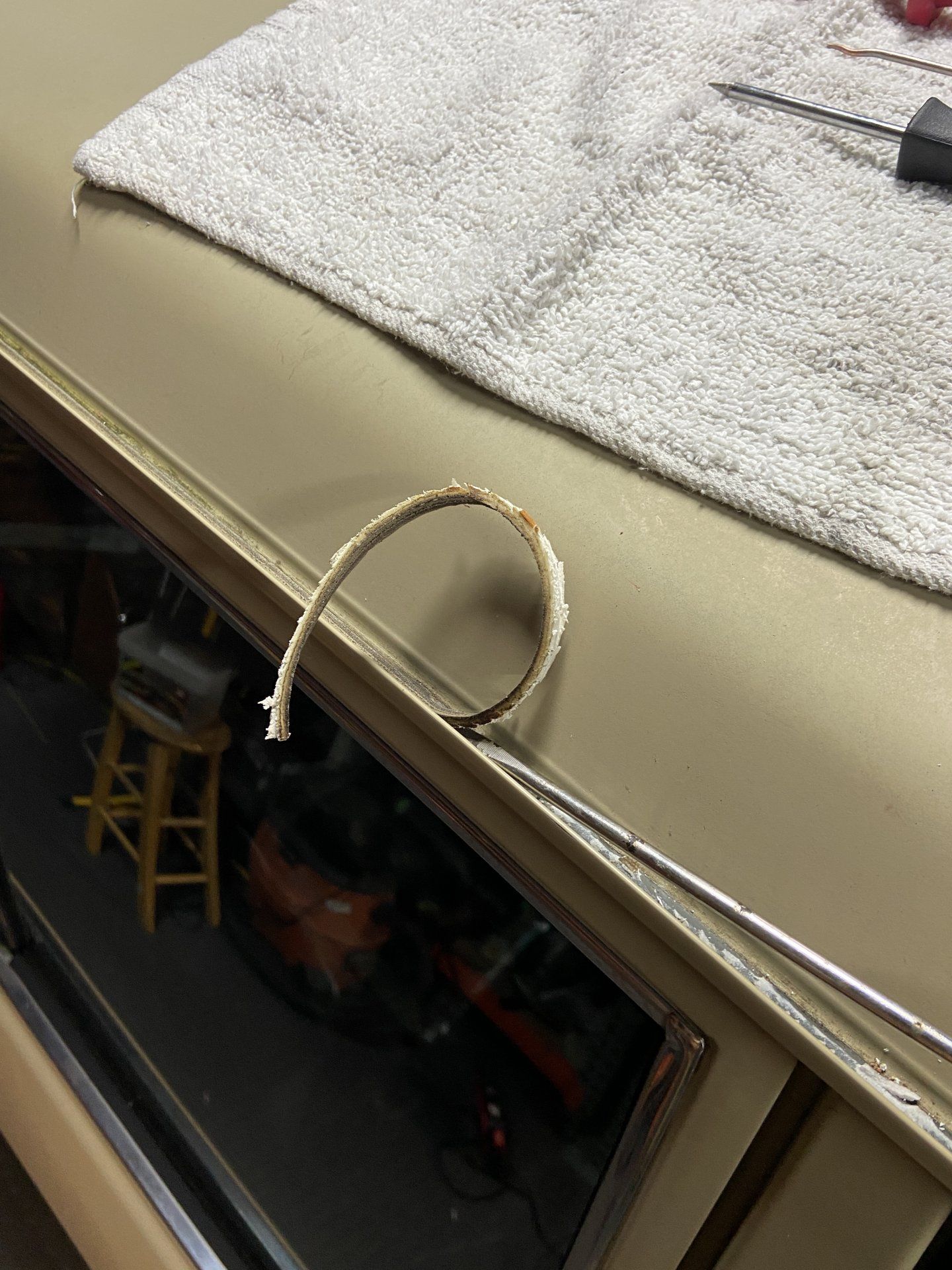

I also removed the three remaining mud flaps. They’re in bad shape and mostly just made the truck look worse if you ask me. I’m hoping to put some presentable aftermarket flaps on before too long. I’m pretty sure I’m priced out of an OEM set at this point. I cleaned behind them, used a razor blade to remove the butyl rope used to hold them onto the body panel, and degreased whatever was left.

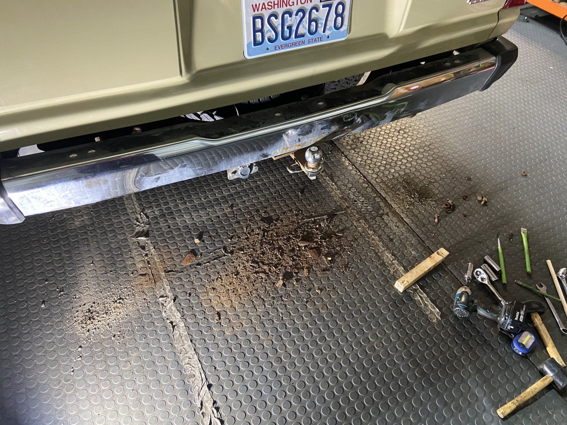

I also attempted to remove the trailer hitch from the truck. It’s surely not rated higher than class 1 and is only a ball hitch, no receiver. It’s completely useless now that the truck is lifted. Unfortunately I couldn’t get the rear tow hook off and had to give up for the night. I’ll try again later with a torch and a grinder.

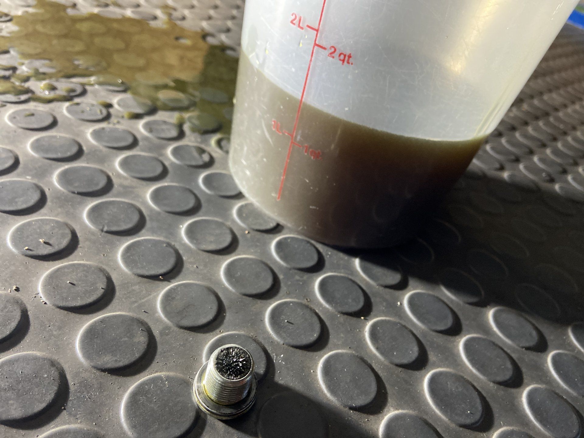

I replaced the oil in my transmission 9 months and maybe 5,000 miles ago. What would cause it to be this dirty after that time? Some of this migrated from the transfer case but that oil looked much cleaner. That’s the fill plug in the photo.
I had that on my rear diff after tying that purple synthetic crap. Went back to the regular stuff, problem went away. Your oil isn't purple though.

I got the old ball hitch removed and am slowly working on getting my new 2" receiver installed. I just need to round up the correct hardware and drill the frame.

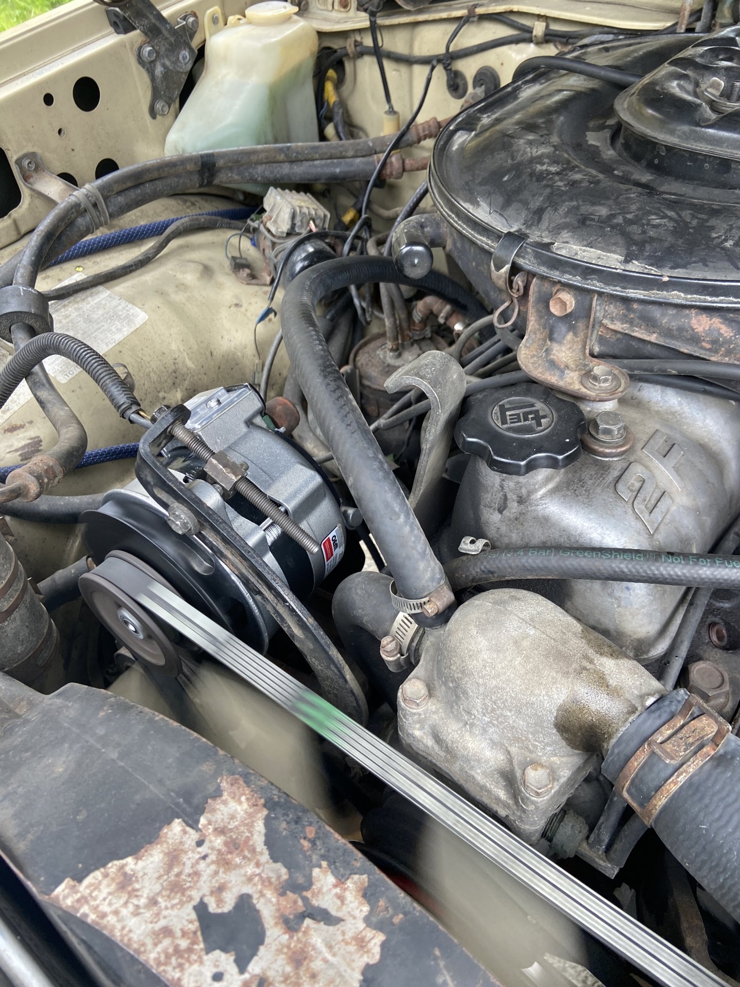

My voltage reading has been getting lower and lower over the last few weeks. I ended up pulling the alternator and took it, along with my spare, to Oreilly for testing. Turns out that they're both bad. We have a camping trip planned for Friday so I'm going to do my best to find another alternator to drop in before then. My battery is pretty new so I don't want to ruin it with a bad alternator.
With the help of a friend I got my RTT mounted back up and aired it out yesterday. It feels good to have the tent ready to go again! I don't think I'll remove it next winter, it's just not worth it considering that a replacement weather cover is only $150 from CVT.
This morning I picked up a “new” alternator from Blanchard Electric near Seattle. They ordered a reman from Whatcom in Bellingham for me earlier in the week and managed to get it back just in time for me to install it and drive 150 miles to camp this evening. It looks great and performs well so far. :) I need to do some cleaning in my engine bay, would love for more of it to look like this!
