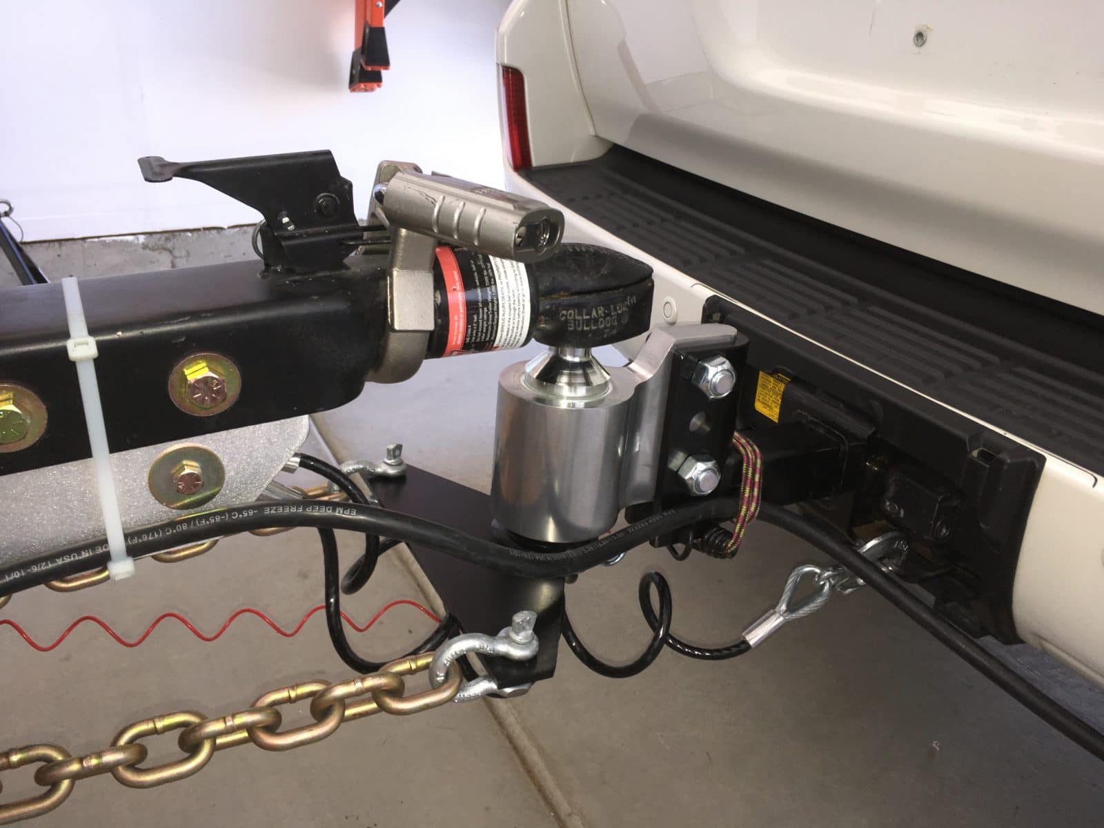

In regards to the Andersen WD hitch, I've used it before on a smaller 23' 5500 lb TT with my 100-series. I do really like it for smaller less weighty setups or rigs that need less WD. For that use, it works brilliantly. Hitches up easy, is super light weight, and looks great.
I would suggest against it for your new larger TT. The Anderson WD hitch achilles heal is the inability to do much weight transfer. It's great for transferring some weight and excellent for stability, but again, it not as effective at transferring larger weights. Our rigs, because of the short wheelbase and longer rear overhang really needs more weight transfer. Trying to do that will on the Anderson will cause the poly bushings and braking material within the ball shank to prematurely wear.
I've been extremely satisfied by Equalizer WD setup. But technology has progressed and there are new products out that one up the Equilizer, without adding complexity. I'd look into the new Reese Steadi-Flex which is very similar to the Equilizer, but with tapered bars. This addresses one of the primary disadvantages of the Equalizer being too stiff. Another great hitch is the Blue-Ox Sway Pro.
Thanks @TeCKis300. I had read some people saying they had 1000#+ tongue weight and the WD was great and the Andersen was amazing, and others who were complaining if you could get 200# transferred they were shocked.
My ProSeries has been fine but the dry TW on the Lance is >50% more, so I'm sure I will exceed the 550# max the ProSeries is rated at. The biggest complaint I've read about Equalizer/BlueOx/etc is noise, second being bounciness. I'll have to read up on the Reese.

Having run both the Anderson and Equalizer...
Anderson will porpoise too from my experience, though the design mitigates some of it. It's good for light weight trailers or rigs that don't need much weight transfer. Without enough weight transfer, the rear of the TV will sag, but more importantly, not enough weight will be translated to plant the front axle and assure front axle caster and stability.
My Equalizer is silent...seriously. They've added a plastic pad accessory - https://www.amazon.com/Equal-i-zer-95015150-Sway-Bracket-Jacket/dp/B007HRJNIE - that quiets things down without grease on the WD bars. And some grease on the hitch head in the proper friction spots keeps things running smooth. It's only noisy for those that run things "dry". I'm pleasantly surprised, but my Equilizer doesn't have much porpoising. At least no worse than the Anderson in my previous setup. I can't comment on the Reese or BlueOx as I've not used those.

I have an Oliver that is about 6000 pounds ready to tow, tongue weight 620 to 720 pounds, depending on what is in the front cargo basket. I have stock suspension and no airbags.
I use the Anderson (2 inch) and it works pretty well, I love the light weight and general minimalist design. It does a great job with this weight trailer, in settling the 200, no issues at all with a light front end. It is a factory option for the Olivers, and most owners either like it, or really like it; few are dissatisfied. Tow vehicles are mostly pickups, but those towing with mid sized and larger SUVs also report good results.
OTH the design does wear the ball, depending on the fit of the coupler... My trailer has a Bulldog and the inside of the forging is a little uneven at the hinge in back. The Anderson pushes forward hard on the ball with several thousand pounds of force when tensioned correctly. This caused my ball to wear badly at first, even though lubed. Anderson admits this happens, but they also say that the wear will stop after the parts seat with each other. This appears to be the case here. The wear was extreme for 700 miles, then it tapered off to nothing additional.
They have updated the angle of the ball and friction material, and changed the triangle plate, due to noise complaints (binding of the ball shank, causing a Spawn of Satan shriek when maneuvering tightly), and hopefully those issues are resolved. Mine is the original design and does not make any noise yet, with about 1600 miles on it.
I do suggest strongly that if your trailer is heavy, for you to install a 2 5/16 coupler on it and use the matching larger Anderson. The 2 inch is rated at 10,000 pounds and is perhaps a little inadequate at this weight range, simply due to the smaller surface (bearing) area. The bigger ball is rated at 14,000K. The larger diameter should help dramatically with any ball wear. If I have any issues with my hitch I will upgrade both the ball and coupler to the larger size.

A caution for the Equilizer. If your intent is to visit campsites off the beaten path, just know that the Equalizer has super stiff WD bars that don't deflect much. It's both it's greatest quality for stability on-road, yet a liability for uneven off-road terrain that can strain the trailer chassis and vehicle hitch. One will want to remove the WD bars (super easy) prior to off-road sections.
Interestingly, the LX570 has a nice interaction with the WD bars. I can set my WD more relaxed. Because at speed, AHC lowers the suspension which has the effect of increasing WD tension exactly when it's needed for higher speeds. Also, when I enter gas stations, or off-road, I generally will put AHC in H, which further relaxes the WD bars.

Just sold my Andersen Hitch and went back to the Equalizer.
I usually tow with the 18 Tundra but highway speeds were often times white knuckle rides due to the sway. Tail wagging the dog.
I am towing a 28 foot TT that weighs in between 5600 and 6500 depending on load.
The equalizer would prob work best with a 3/4 ton truck and light trailer combo.
I tried the Andersen with a Platinum Sequoia with AHC and it was horrible.

With my new(er) Lance 2185 trailer this year I moved from the Pro Series hitch to the Blue Ox. The PS was rated at 550# and my Lance TW is 780# so I needed a hitch rated at 1000#. I ran my Blue Ox on the 11th link, which got my front within 1/4" of unloaded and the rear within 3/4". Dead drop was about 3" in the rear with 5psi in my air bags, and since the Tough Dog rears are 240#/in springs that implies 700-800# on the tongue. A few observations:
  • It really does eliminate "sway". That doesn't mean you don't still get pushed/pulled around a bit by 18 wheelers, but it felt less than with the Pro Series and when you do get pushed/pulled your TV and the trailer move in lock step. That said I would estimate the Pro Series with single friction anti-sway eliminated about 90% of sway, so while it does feel a little better you're still towing a house with far more surface area than your TV.
  • I imagine that the Equalizer, Fastway, E2, and Reese hitches which all claim to eliminate sway perform similarly.
  • The Blue Ox is quiet. Aside from the occasional pop on really sharp turns (forward or reverse) it doesn't make any noise. Much improved from the friction anti-sway which creaked and groaned like crazy when making a turn
  • Also no issues straightening the wheel after a turn. With the friction anti-sway if it was tightened down a lot sometimes the steering wheel wouldn't quite come back to center until I'd drive a bit.
  • With my 2" Tough Dog lift the stock 9" drop shank from Blue Ox wasn't tall enough with my Lance, where the top of the hitch sits at 21" when level. I had to reuse my Curt 12" drop shank, which worked perfectly.
I would've liked to have tried the Anderson hitch, but given how I'm shifting several hundred pounds off the hitch I'm glad I went with the Blue Ox.
