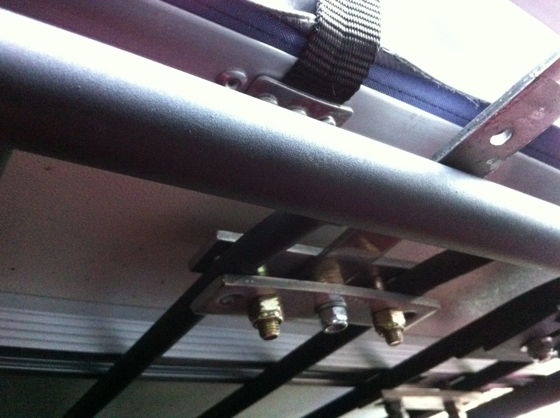

Finally got my tent mounted: Tepui Kukenam Ruggedized. Can't wait to test it out this weekend!
Since the brackets aren't long enough to span 2 of the slats on my Baja rack, I had to do this for the front brackets temporarily which I'm not thrilled about, but it seems to be holding fine after 3 freeway journeys:
The rear brackets I have around the thick bar:
Plan is to get some longer brackets made so I can have them straddle two of the skinny bars and not bend so much. Any other ideas?
I would def try and span two smaller bars with a longer piece. JMO and I clearly commented b4 reading your plans, lol

Yo Mike, this is Chris. The guy you bought the Baja Rack from. Truck is looking good! I saw you had the Tepui brackets mounted kinda funky. Did you fix that yet? I mounted mine with both bolts passing between one gap and the bottom metal plate would tighten across 2 of the skinny rack bars. That kept it plenty solid. You can see it in the background here.

Hey man good to hear from you! Yes glad summer is over, and that I recently flushed my heater core enough to get good heat!
I ended up making some new brackets for the roof tent so that each bracket spanned 2 of the roof rack bars. I've had it like that for about 4k miles and it seems solid.
