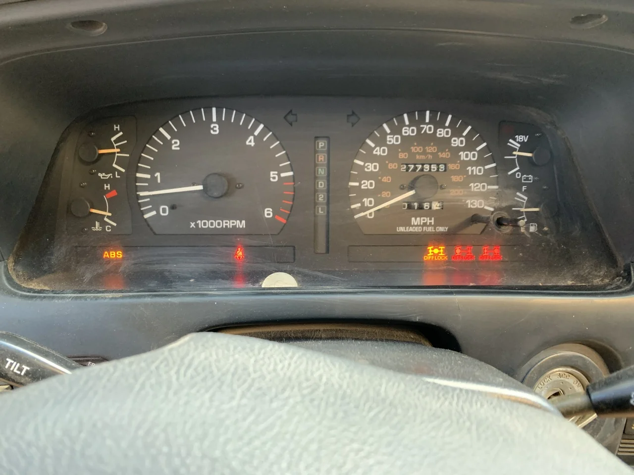

When I shift into 4WD LO, no cdl or abs lights on the dash. When I turn the key to the ON position, ABS shows up so I know the dash light works. I just drove it on snowy roads and locked up the tires, the abs module clicks and does its job but NO ABS light on the dash…. I’m going under it today to remove and clean the CDL sensor switch. Will jumper that wire and see if the dash light comes on for CDL. THEN I can see if the diff lockers actually engage.
Is the ABS light supposed to light up when you lock up the brakes on slick roads???

@ppc Ok that’s good to know! Thanks for reading and for your reply.
I did get the CDL sensor switch jumpered and got the center diff to lock. Then got the front and rear lockers to engage and disengage multiple times. The lockers got faster each time I did it. Pretty exciting times.

Jumpering the CDL sensor switch on the front side of the transfer case does not mean the center is locked. You're just faking the system which allows the front and rear to lock but the center needs additional testing.
Ok will do. Just noticed a PHH leak when I got back from the store. So that will be top of the list moving forward 😅
