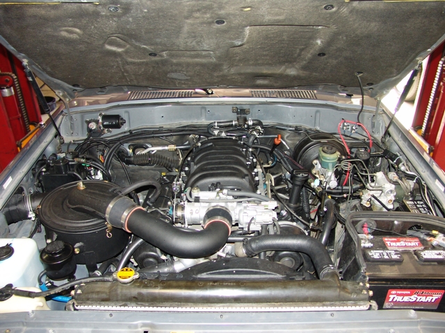

With the 2uz, what are you going to do about all the electronics on the dash like tach, warning lights, etc? I recall watching an old slee 2uz 80 conversion vid on YouTube years ago and it was a megaton of work to get it dialed in oem style. But then I’m presuming this ain’t that type of build.
I also understand that a made in Japan truck 2uz is different than a made in USA truck 2uz? Never chased this down myself since I’m not the type of owner with a proclivity toward heart transplants.
Pls disregard if too off course. Gracias!
P.S. fwiw my all new oem 1fzfe is measurably more powerful than the og 287k mile engine it replaced
I actually plan on doing as much of a full conversion as I can. Whatever updated electronics and features I can pull from my Sequoia and fix into the 80 is going to happen. I was a mechanic by trade (now in school for a career change) and automotive electrical is kind of my specialty. I actually enjoy looking at EWDs (I'm weird, I know). So yeah, anything I can adapt over, will be.
