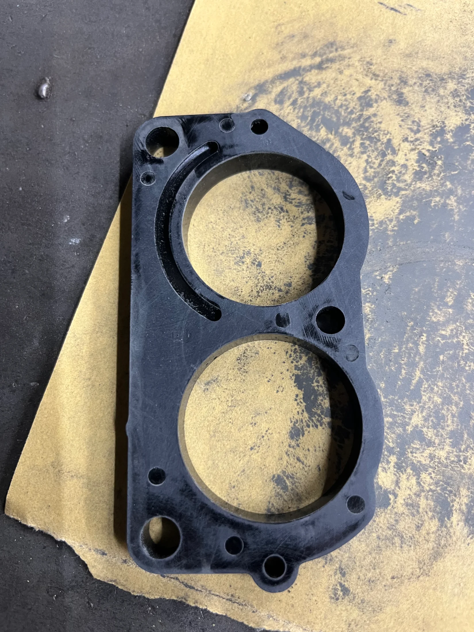

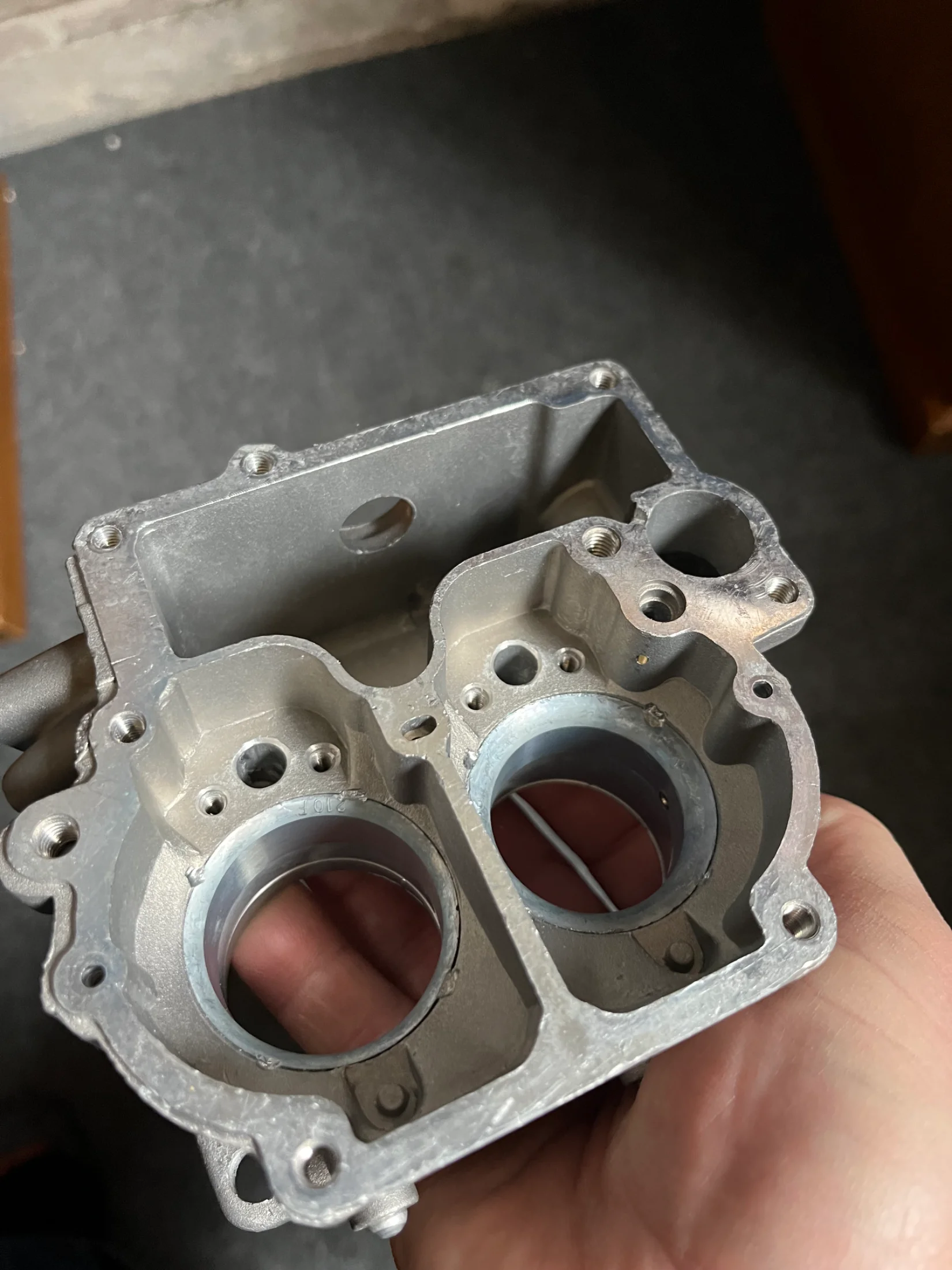

Rebuilding the carb is not that difficult. Get a kit from cruiser outfitters. On mine (actually a couple I’ve done), the mating surfaces weren’t flat, gaskets covering ports, etc.
Ok. May try that. How did you get the mating surfaces flat? Is there a good thread, or better yet, a video for rebuilding a 2F carb?

For getting the surfaces flat, I had a 12”x12” 1/2” thick piece of steel and put some 220 grit (I think) sandpaper wrapped on it and just gentle back and forth until it was flat.
You may even have some luck just tightening all the screws. I usually find a few loose or finger tight around the carb top. I think all of them I’ve done, the screws that go up from the bottom into the carb body have been loose.
