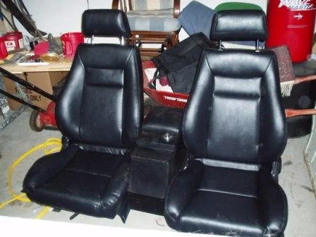

I didn't get any work done today, and my wife says I get mean when I don't get to work on my Piggie, so I went outside to put together my seats to see what will be replacing my old front bench. I didn't install the cup holders on the Tuffy console yet.
