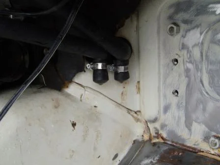

I got about seven hours in today. I removed the rear heater - lost a little under a pint of antifreeze. I did catch the anitfreeze that drained w/ a bucket. I have to figure out how to dispose of it now. I capped the T fittings under the dash with caps and hose clamps. The caps themselves wouldn't hold the anitfreeze. The clamps appear to be doing the job. I'll see once I start driving.

3) Rear heater caps - had to use hose clamps to stop flow of antifreeze. You will see a few drops of antifreeze still dripping from the caps - I had not cleaned up yet.
