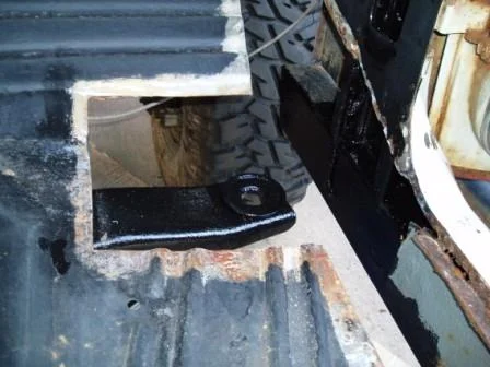

I got a good bit of work in this weekend but its hard to tell! I ran out of shielding gas and the only place to get a refill on the weekend was Tractor Supply 40 mins away. I ended up cutting about half a dozen pieces of sheet to fill in my holy floorboard. I POR'd the bottom sides the sheet and will POR the top after I weld them into place. I also POR'd a body mount, underside of door sills, and pretty much anywhere that was rusty and I could reach now but won't be able to when I close up my floor.
Here are a few pics.
Pic 1) Passenger A-pillar body mount cleaned up, POR'd, and door sill and bottom of A-pillar POR'd.
Pic 2) Driver's A-pillar body mount POR'd - also POR'd underside of door sill.

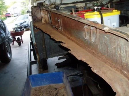

Today I pulled off the front passenger fender to get a good look at my rust issues...I have a bit more rust than I thought. It looks like I am going to have to trim some metal which shouldn't be a problem since I will have plenty of strength for the fenders w/ the tubing. I do have some rust through the inner fender well.
I'm guessing the best way to deal with that (before I POR everything) is to remove the windshield washer reservoir and the battery w/ tray and weld in a rough patch...shouldn't be a big deal...reinstall battery and washer fluid reservoir, POR rest of fender to stop the :censor: rust, then fab up the tub fenders.
Pic 1) rusty fender
Pic 2) zoomed in
