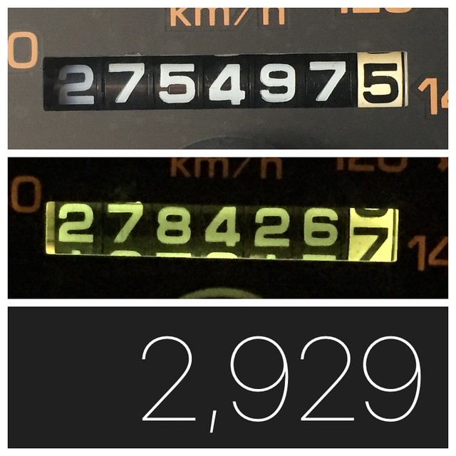

Just completed a 2,929-mile 10-day trip and the ol' 1992 3FE UNDERpowered ADV80 is still going.
I don't think this motor makes enough power to blow a head gasket... maybe the 3FE doesn't count?

The 3FE doesn't count because its an iron head. It expands at the same rate as the block. The 1FZ is aluminum and expands more than the block for a given change in temp. The difference in expansion causes a scrubbing motion between the head and block and weakens the seal around the combustion chambers. I believe the 1FZ HG failures are more due to heating/cooling cycles than number of miles on the engine. Lot's of short trips will kill a HG before fewer longer trips. Overheating the joint will absolutely kill it.
