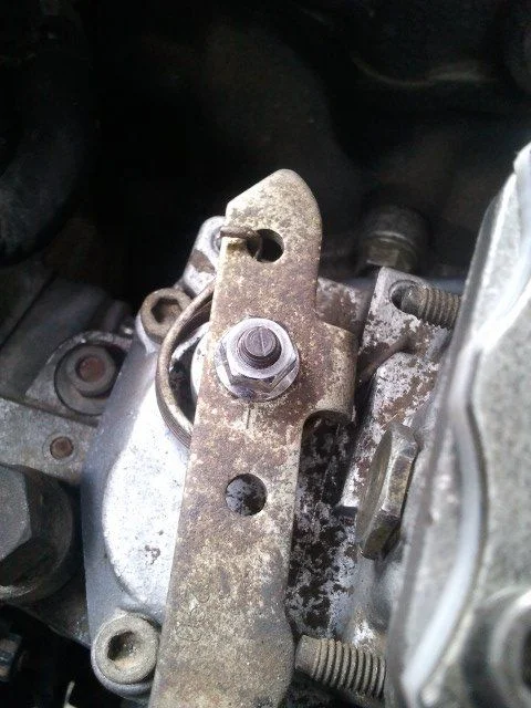

Can someone weigh in on what I've found on my injection pump linkage and the possible affects this may have on pump operation...
I've been working my way around tuning my truck and saw this early on but it didn't dawn on me how this may affect the internal operation. I haven't touched this but the nut is much newer than the rest of the pump which leads me to think it has been tampered with... On the subject of tampering, the pump also revealed a modified aftermarket aneroid pin too, so someone has played with it before, likely ATEB or in Japan.
In the FSM it states to line up the match marks and if there are none, make them and line them up when reassembling. From what I can tell the spring does several things which are all critical to operation.
What affect might I expect if I correct the alignment? It appears as though it will be equivalent to advancing my throttle 10 deg or so...
Thanks in advance(no pun intended)!
@ocean cable the marks are unrelated to timing. It simply sets the throttle arm position which is also adjustable with the min and max stop screws.
I thought that the spring tension against the governor would have some affect... no?
