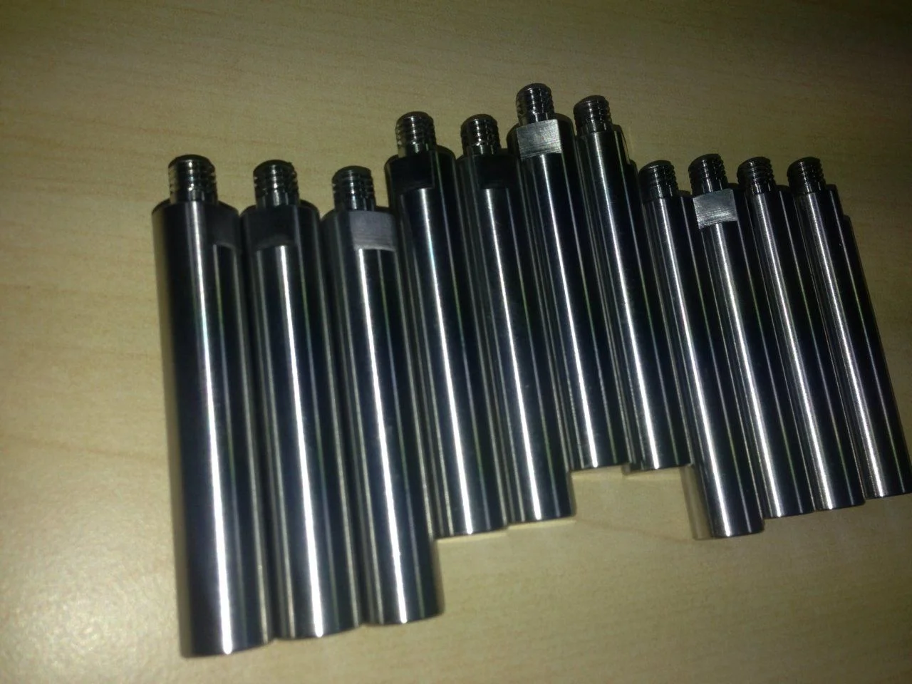

I have just sent my 10mm pin to a mate who has a first class machining company here in Perth to make me some blank pins. Would anyone else be interested in 10mm, 11mm, 12mm blank pins?
Out of the goodness of my heart to all Mudders :smokin:
No middleman, if he can make it cheap enough to sell heaps, I'll release his number to everyone and you can go direct. If that happens he will need someone to lend him an 11mm & 12mm pin as templates, which you'll get straight back.
