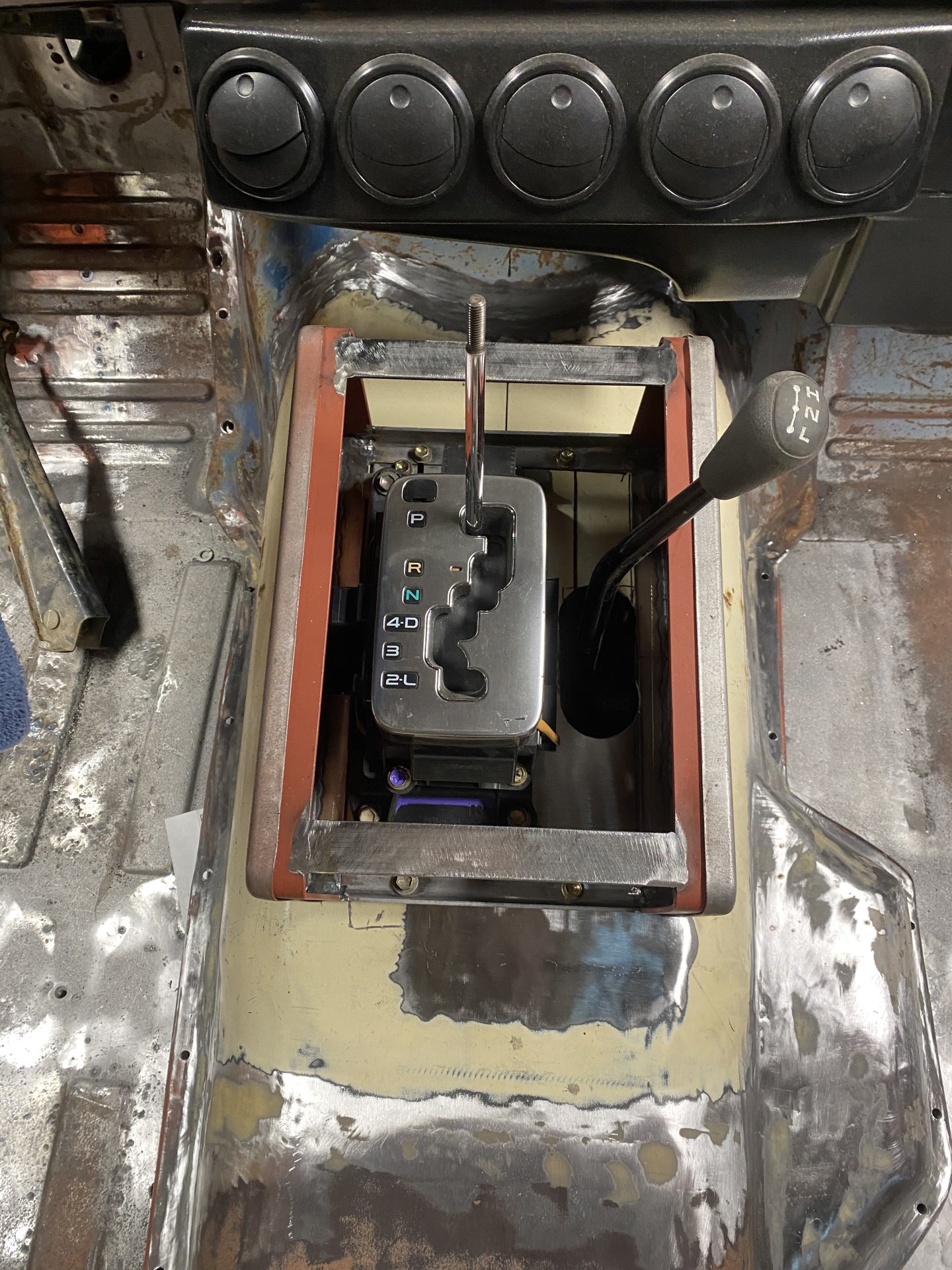

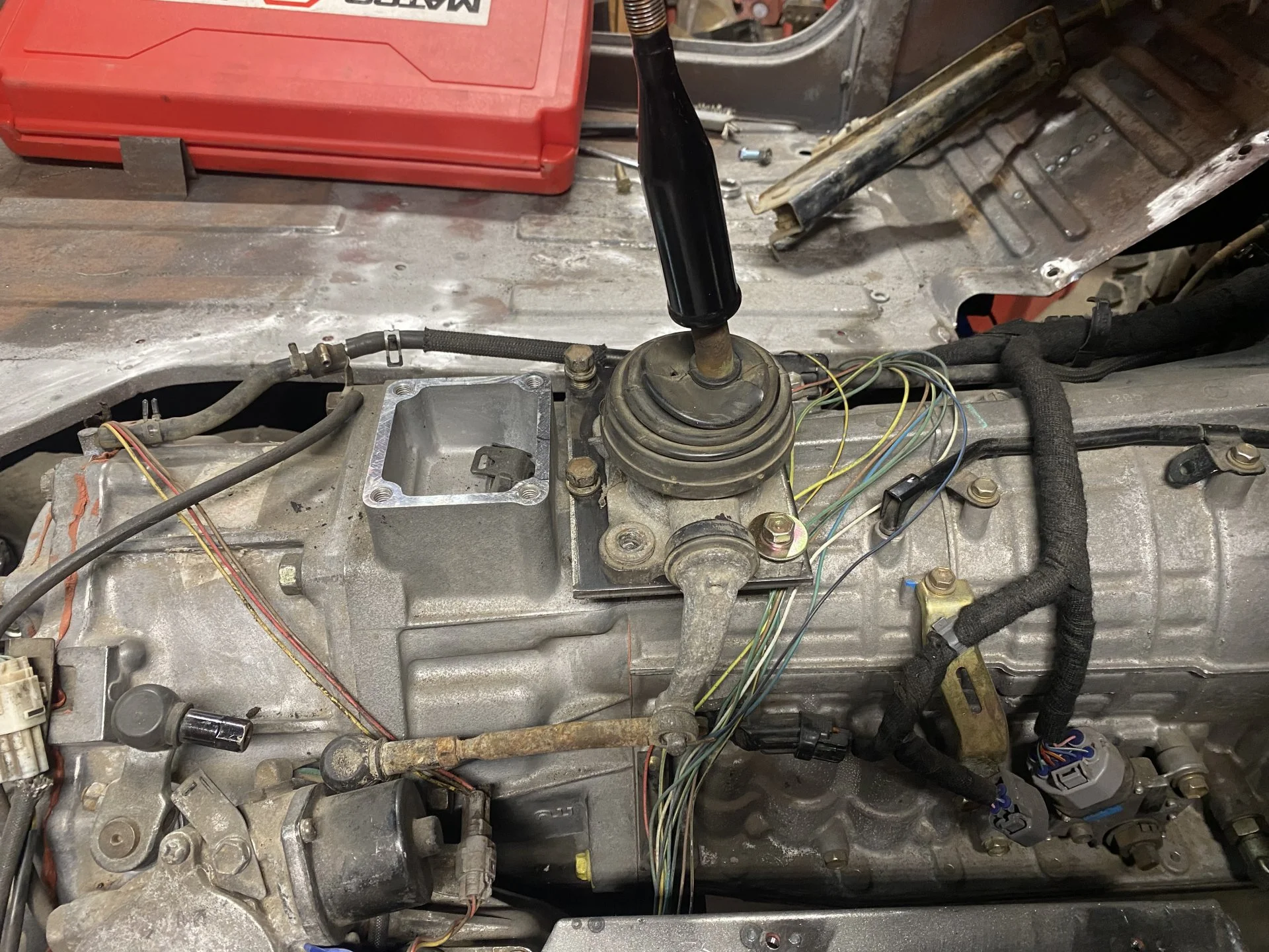

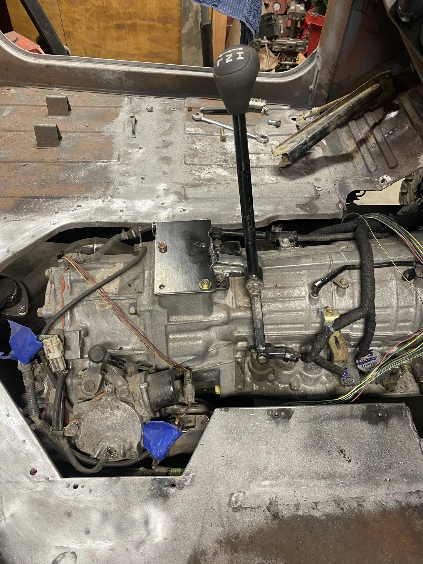

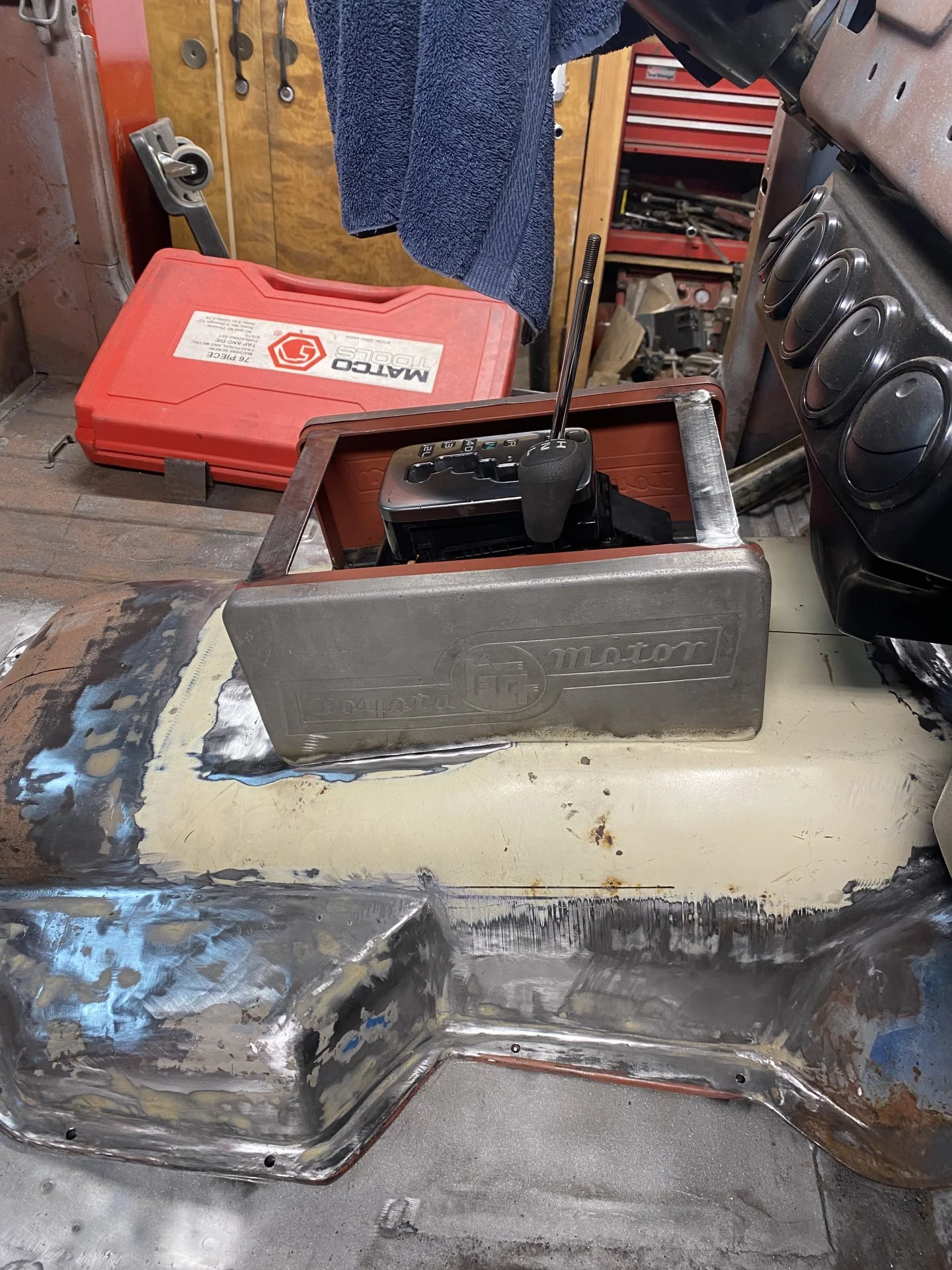

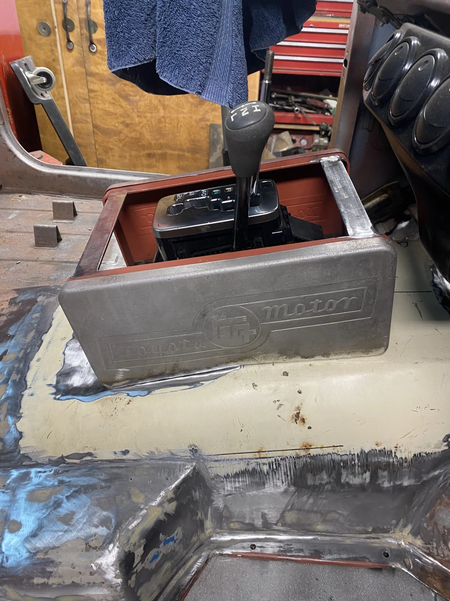

The transmission and transfer case shifter are in place. The shift indicator plate on the selector is set right about flush with the top of the console. I may have to space it up a little to be flush with the cover but it shouldn’t be an issue. There is not a lot space inside the console with everything in place.
I attempted first to use the stock 80 series tcase selector but even after I built an adapter to move it forward and lower it was too tall under the cover and the shifter lever was short where it came through the console (I do have an extension for it though). Because it would have come strait up it would have crowded the transmission shifter, so I decided to go with option B.

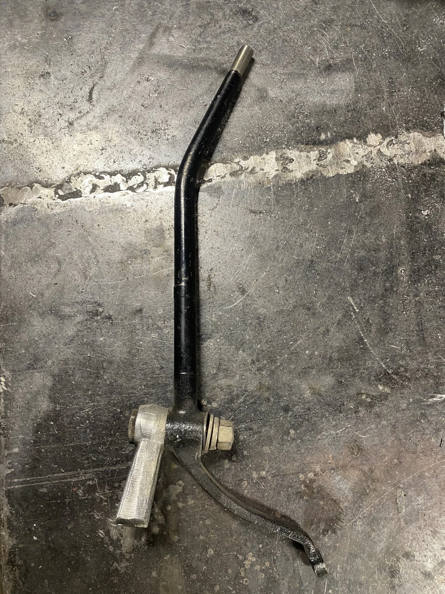

I had some shifter parts from a FJ60/FJ40 not really sure, that I thought could work. After some drilling, cutting, and bending I was able to fit the shifter where I needed it. The shifter had an angled bend towards the passenger side that turned out to work well. It opens up space for shifting the transmission, so I may leave it as it but straighten out the top a little. Bonus the 80 series tcase knob screwed right on.
Left it here for the night.

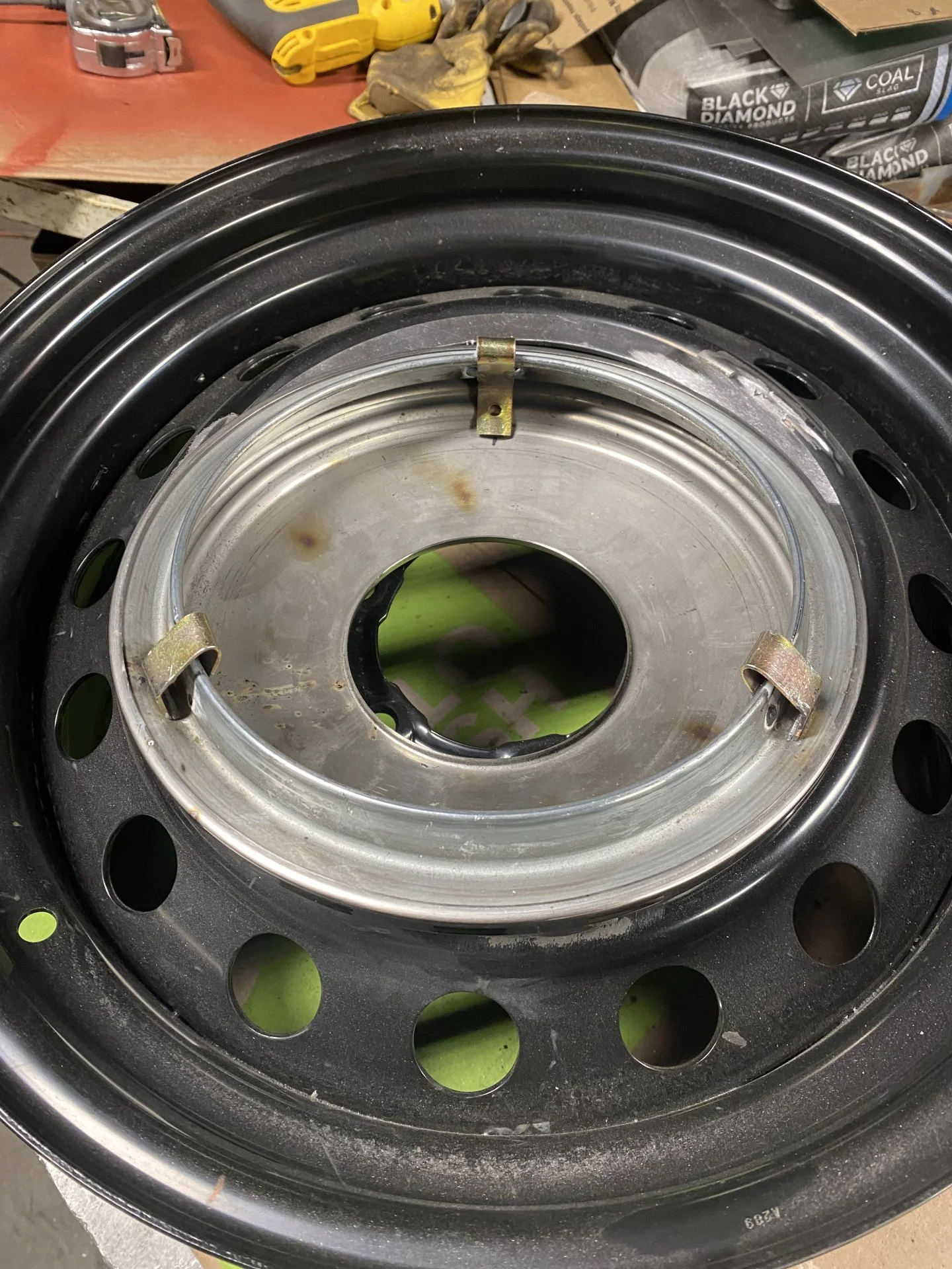

I have been working through an idea I have had for this project for a while and I think I found my solution tonight. I want to run 17” steel rims with acorns hubcaps and making the two fit together took a little while to find a solution I think I am happy with. I experimented with a few ideas before arriving at this current plan.

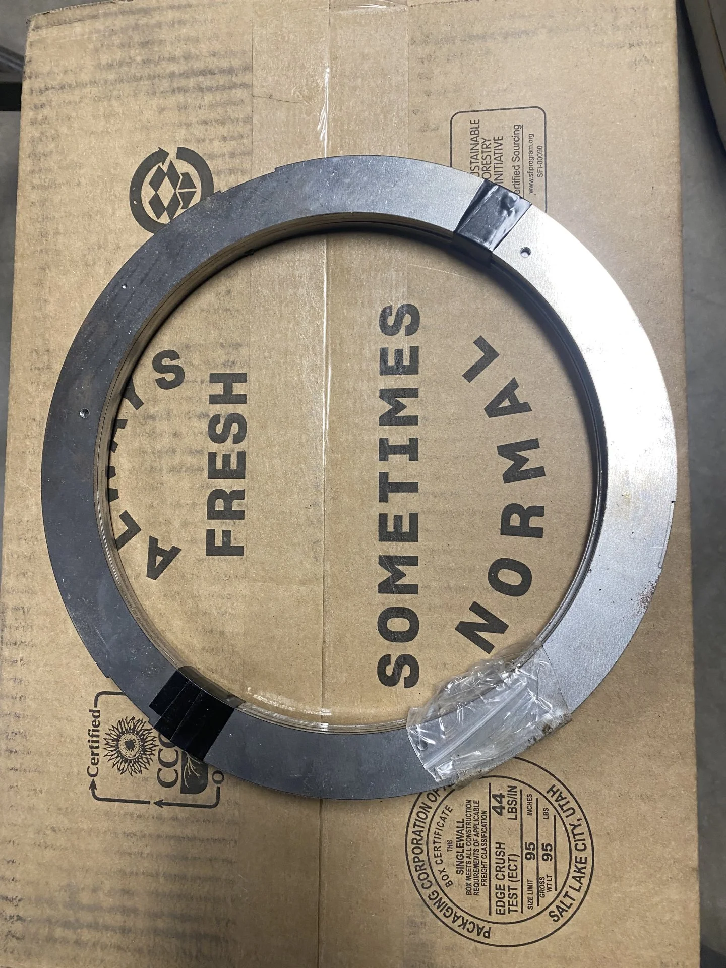

I bought a 17” fjcruiser steel rim to work with. I learned from another post that @cruisermatt sells a ring that is welded to the rim which allows you to bolt the later, non-acorn, hubcaps to. I bought a set of his rings with the hope of finding a way to mount the acorns to them.
After receiving the rings I found out that inner diameter of the flang on the acorn hub caps is larger than the later hub caps, so they wouldn’t sit flush on the ring mounting surface.

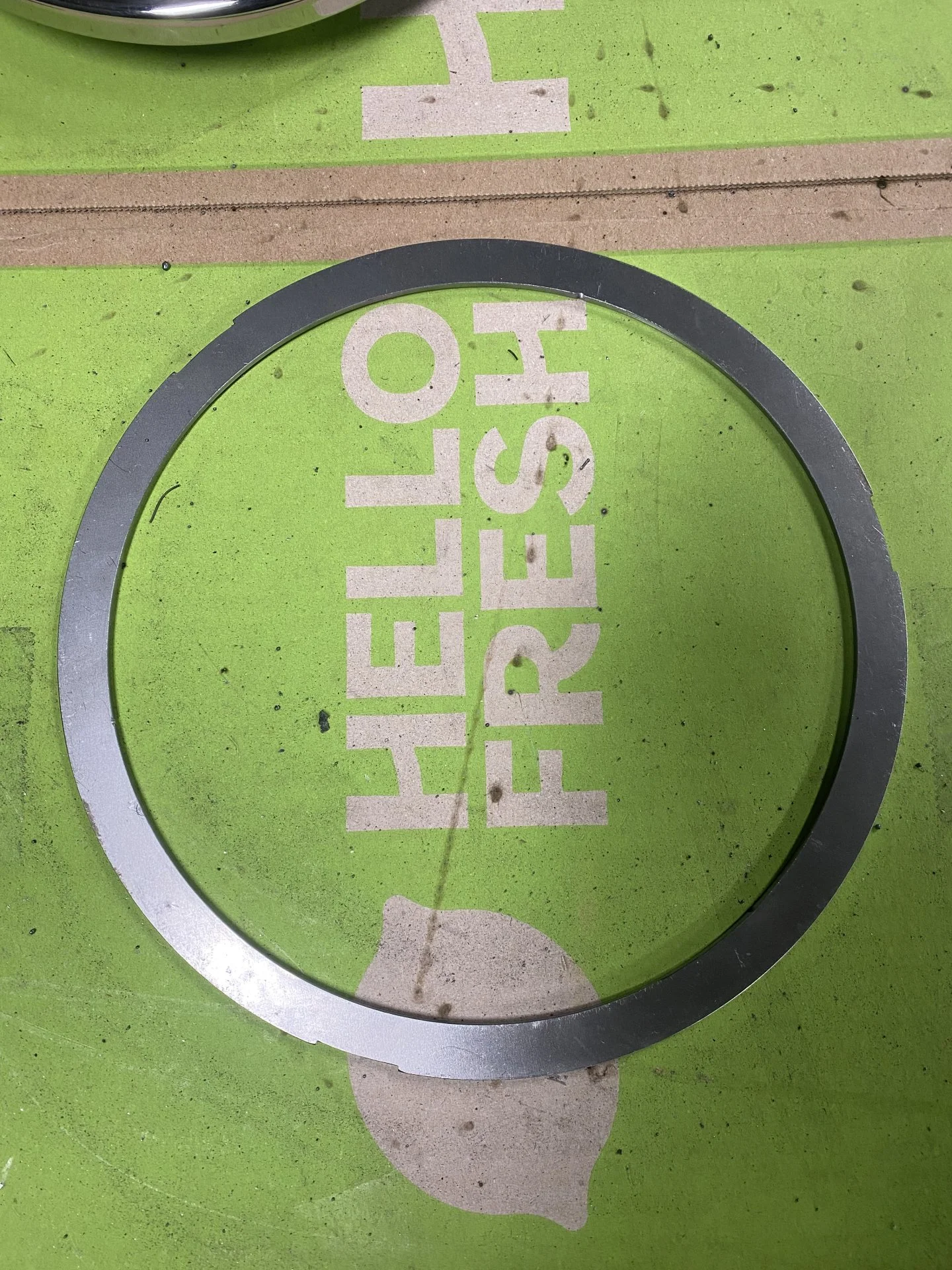

After a solo brainstorming session I found that I could enlarge the inside diameter of the rings and attach oem 40 series hub clips to the hubcap edge, so they would catch on the ring. This is the ring before modified.

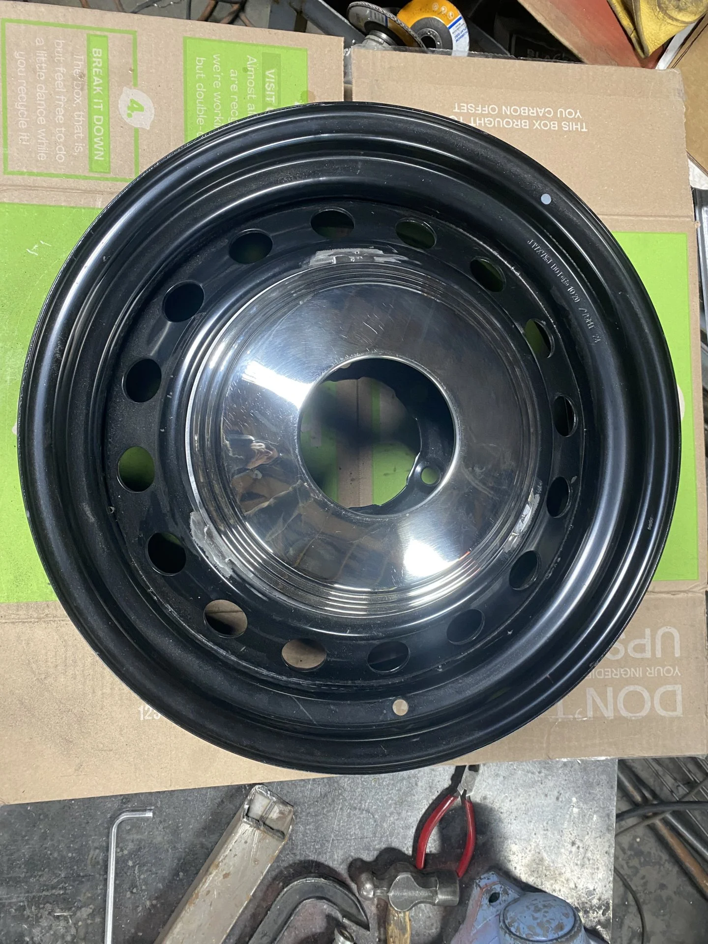

I took the rings to a machine shop and had the ID elarged. I got them back today and and mocked up the one rim I have.
The hubcap sits flush and holds well enough that I can pick the rim by the hubcap. With a couple good shakes the hubcap will come off. I am not sure how tight it needs to be. I may add three more clips, so there would be 6 per wheel to make it stronger.
I need to order 4 more rims add rings and probably have them powder coated grey. I think the grey would look good on this 45.

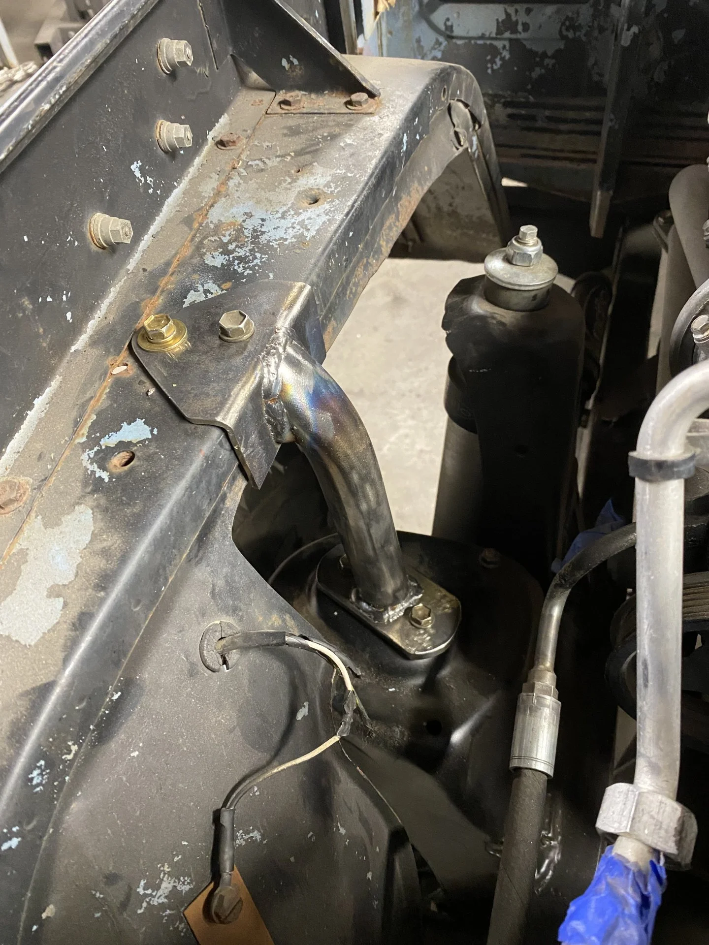

Not sure if I shared earlier but the inner fenders were roughly cut out when I received the truck. I knew I would have to come up with a way to mount them since the primary support was gone. Here is what I came up with.
I will probably add a bolt on each side of the tube support but want to wait until I decide how I want to recreated the inner finder skirt

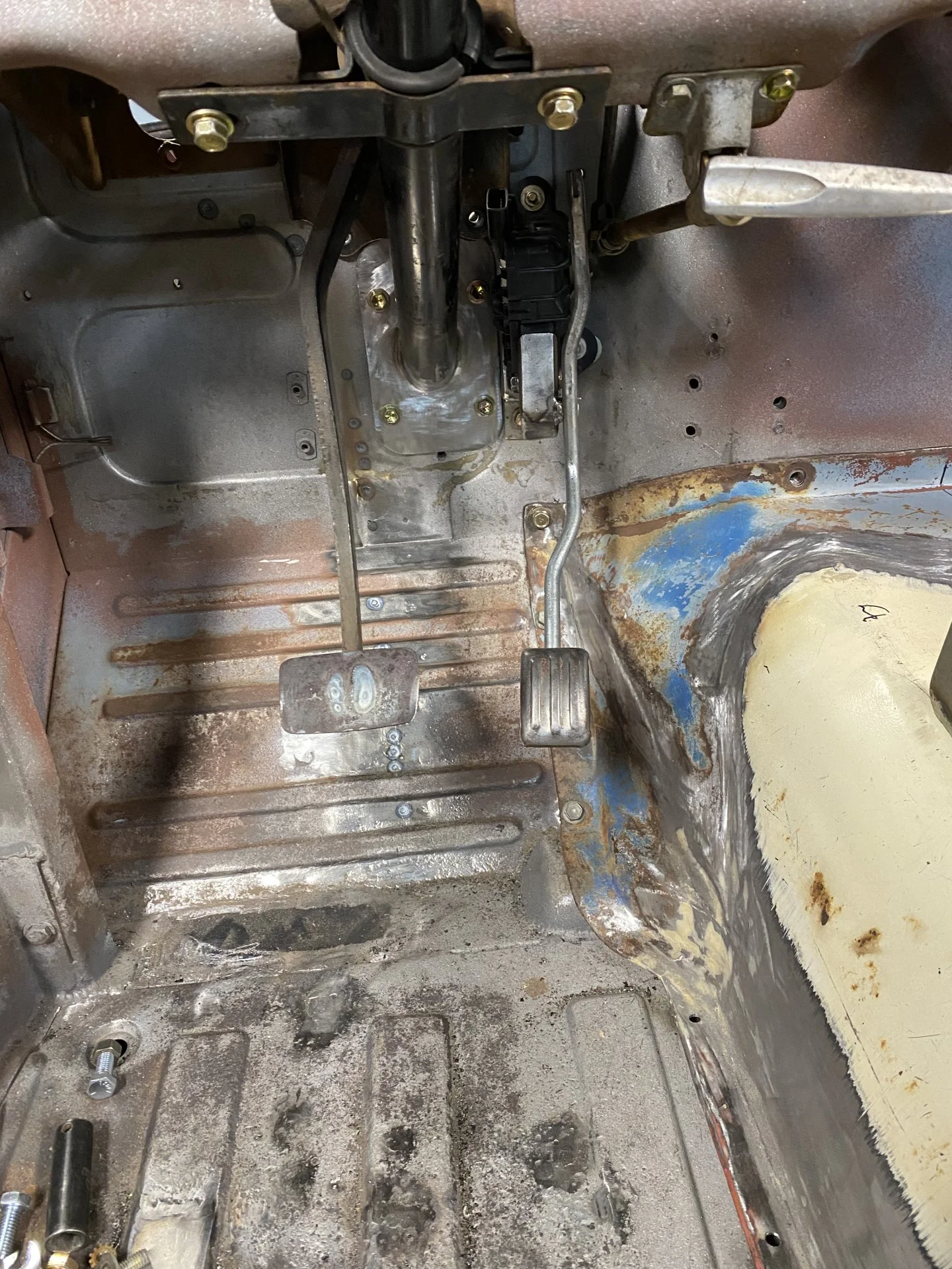

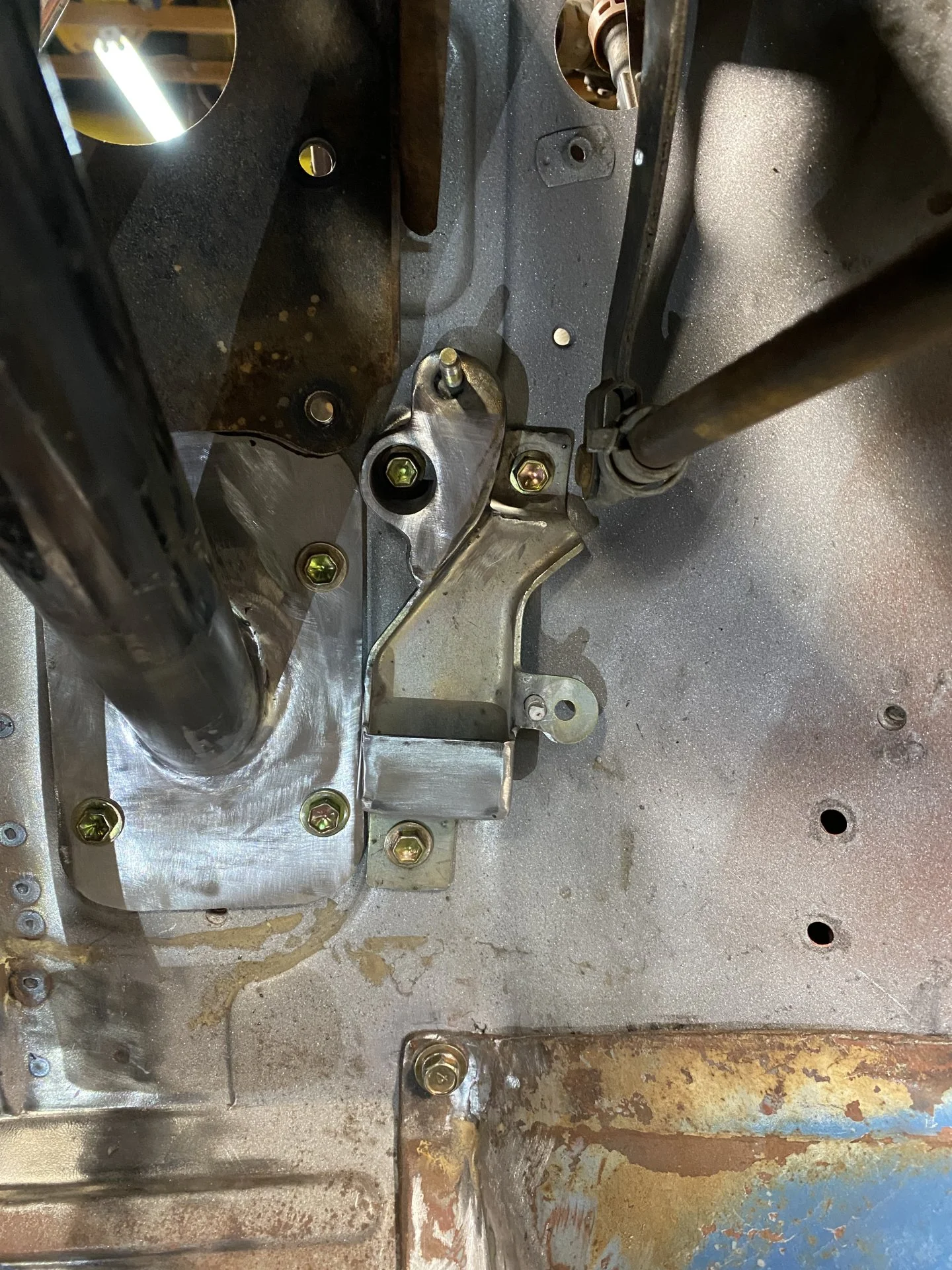

I sorted my pedals out today. I wanted to keep an original look, so I did something similar to what @UZJ40 did with his throttle pedal. I took apart a later 40 series pedal and used it with another bracket I built from a 60 series pedal. I kept the upper arm of the gas pedal, so a throttle cable could be added if I can find room for it.
Before mounting.

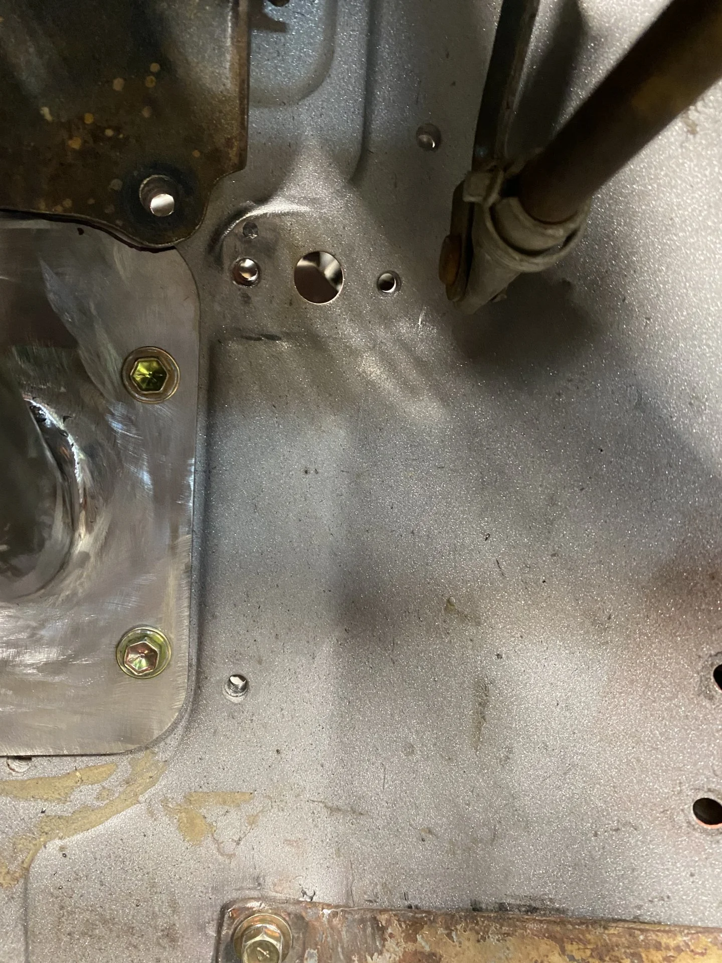

I built the bracket to use the stock bolt holes on the firewall.
Bracket mounted
I bent the gas pedal over a little farther from the transmission cover to get a little room. To accommodate it I bent the bottom of the brake pedal strait then cut the pad off and welded it back straight.

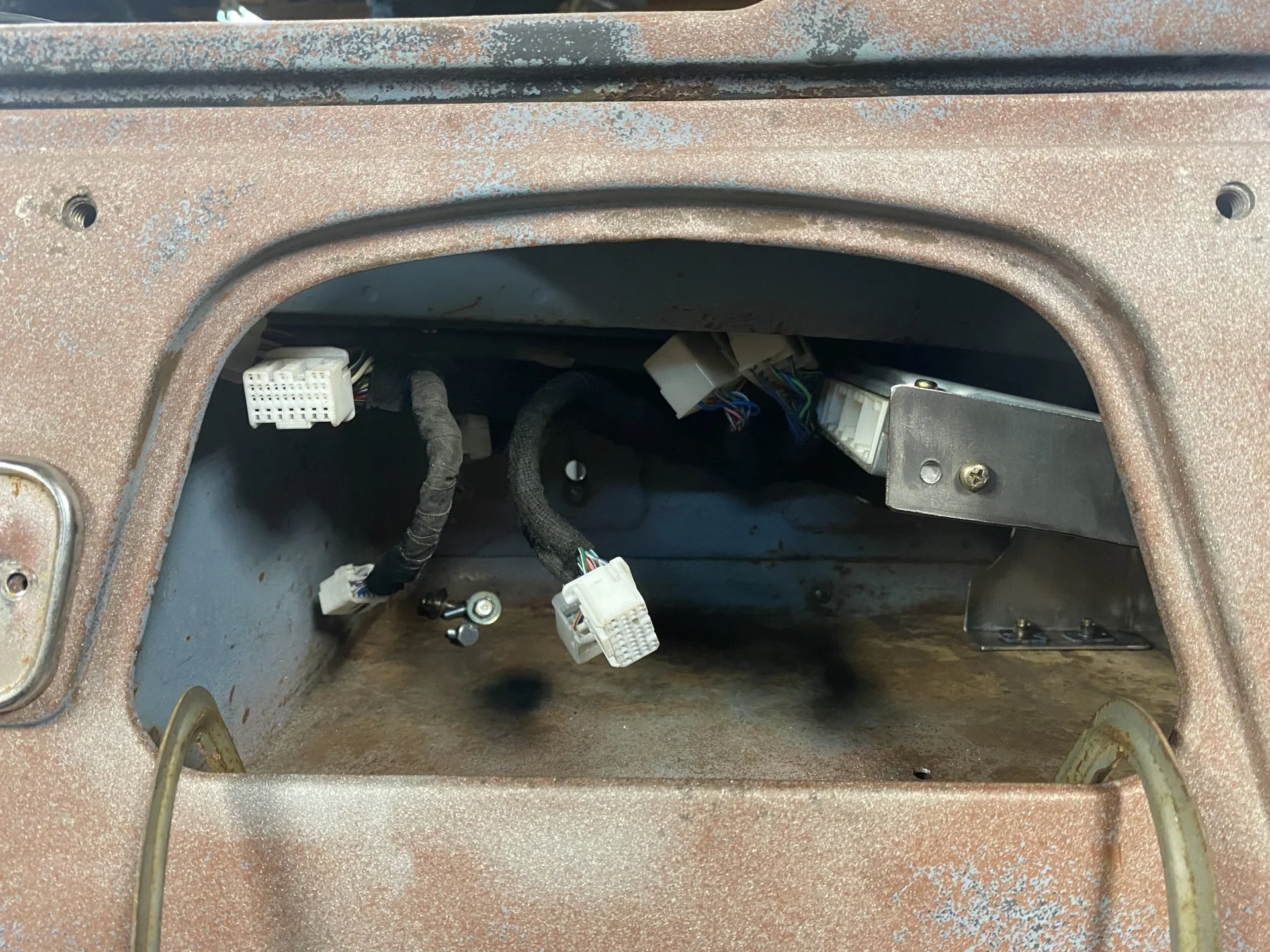

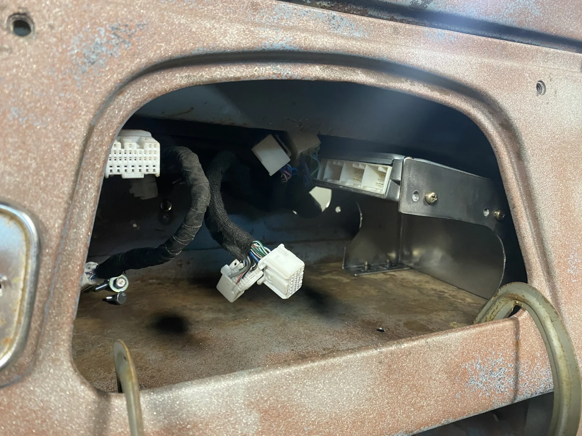

I managed another win tonight. In general I expected my engine ecu would have to be mounted in or near the glove box because that was where the harness came through the firewall. I considered a number of options after I mocked it up with card board this is what I did.

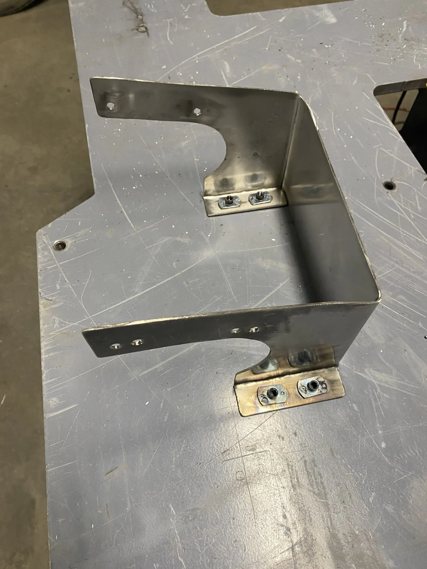

I had a sheet 16 gauge stainless steel left over from another project. I drew the piece out first.
Then drilled my mounting holes, cut it out, and bend it up. I welded capture nuts to the feet to make installation/removal easier.
ECU mounted
Mounted in the glove box. Since it is up off the floor and tucked to the side I still have room to use the glove box if I want. I confirmed the glove box door arms clear, so everything fits.
I like that idea a lot, better than having it sit on the floor in the glove box. Something to consider though, I mounted mine on the outside side of the glove box with the plugs facing down. The ECU is a great fit for the side, its tucked up out of the way and no one will ever accidently pull on any of the plugs either.
