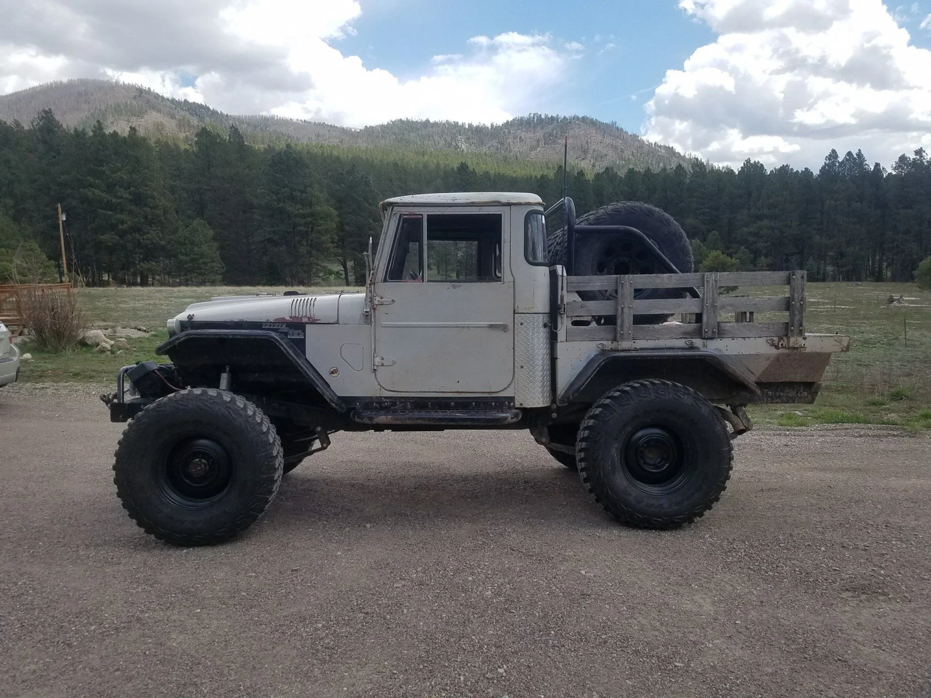

I purchased what would become the foundation of this build a year and a half ago. After I purchase it life happened and in short order I had listed the 1965 SWB R/T for sale. While it was for sale things changed and my wife named it "The Milk Truck". Now that it had been named it seemed appropriate to keep it, so I have. The Milk Truck was very modified and fun as a flatbed utility truck but my preference would have been to have a SWB that was more stock looking and figured I would eventually ditch some of the modifications in favor of an more original look. I had been dreaming about how I would eventually modify it more to my liking but didn't have a solid plan for when I would start making it my own. That all changed when I learned about a 45 SWB R/T body that had been transplanted on a 55 chassis but the swap was never completed. I knew I needed that project to marry with my SWB 45. I bought it which forced me to take The Milk Truck apart and get rid of what I didn't need.
The Milk Truck before it was disassembled.

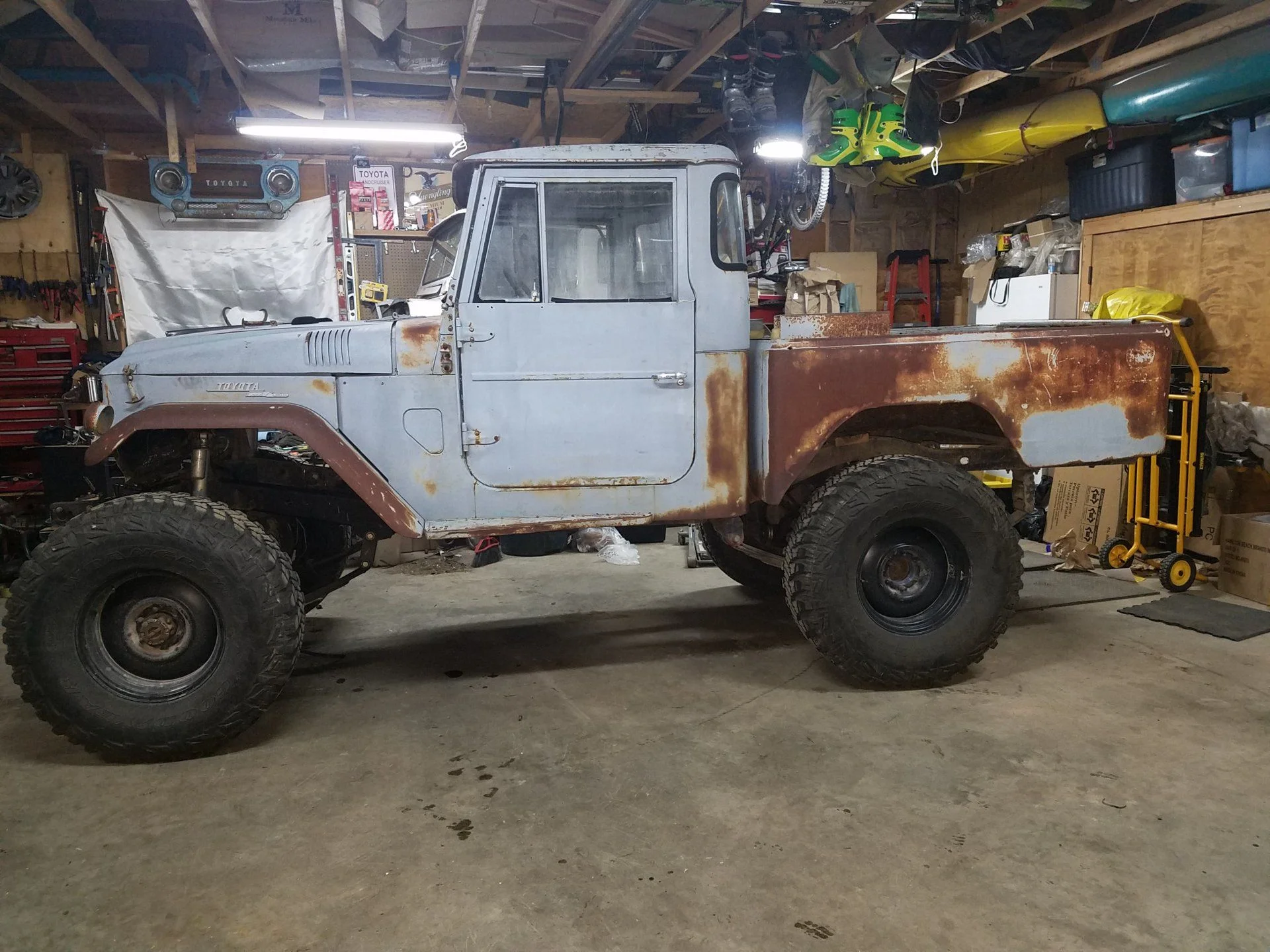

This is the 45 body as I bought it on the 55 chassis. The conversion had been started pre 2005 and had gone through two people prior to me. It had been sitting in farm field for 14 years before I got it. The body is in pretty good condition and does not have a lot of cancer rust but there are a few spots that had been hacked. Nothing that cannot be fixed. It had a big rat nest under both seats, so I stopped at the first carwash I found on the way home with it and cleaned out it. That was nasty work but I am glad I did not do it in my driveway. I don't think I have pictures of the clean out.

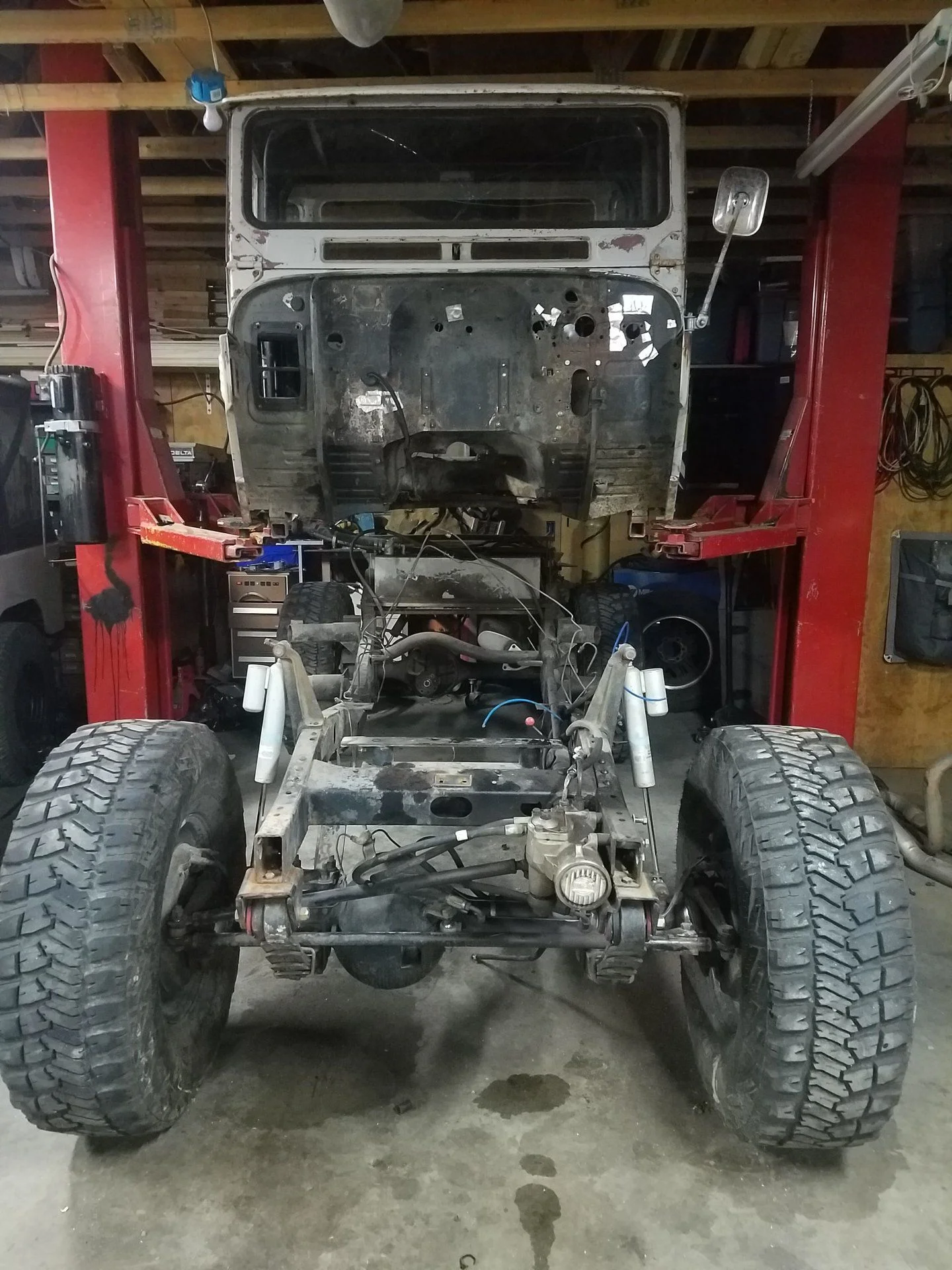

The first thing I did was take The Milk Truck apart down to the chassis. Then put the "new" 45 body on the chassis. It was super exciting to see an original SWB R/T body on the original SWB R/T chassis. I would not have expected that anyone would find a fairly complete body like that just sitting around with out it's frame. I feel lucky to have had the opportunity to buy it. This is all I have done with it so far and probably won't get back to it for another month or so. I have a few other projects to finish first. I figured I would start this thread to scratch the itch in place of not being to work on it and help lay out a plan.

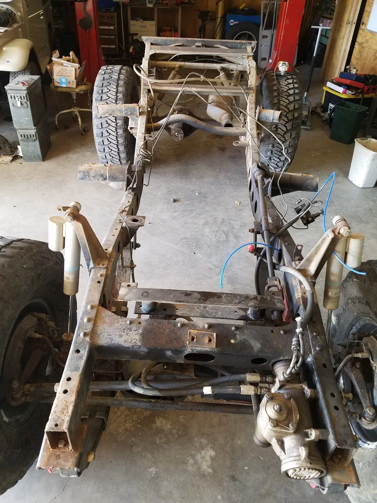

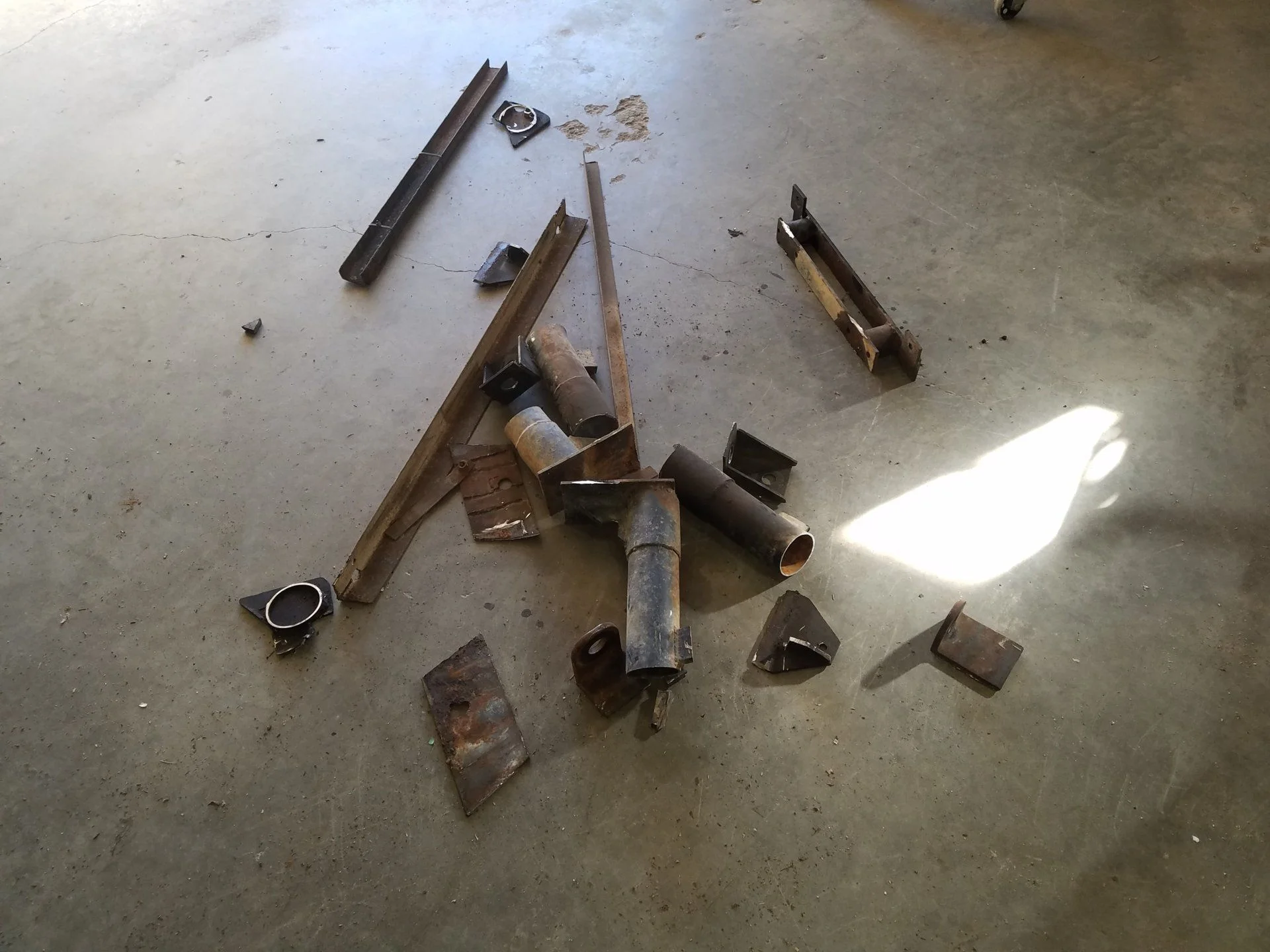

When I pulled the body off the 45 chassis I found I had to remove a bunch of brackets just to allow the new body to sit on the mounts. I still have to go back and clean things up but here is the pile of stuff I cut off the frame.
Looks great @Tank5. Should be a lot lighter with all that was cutoff. The 2UZ combo is just just too cool. Looking forward to seeing it done. :popcorn:

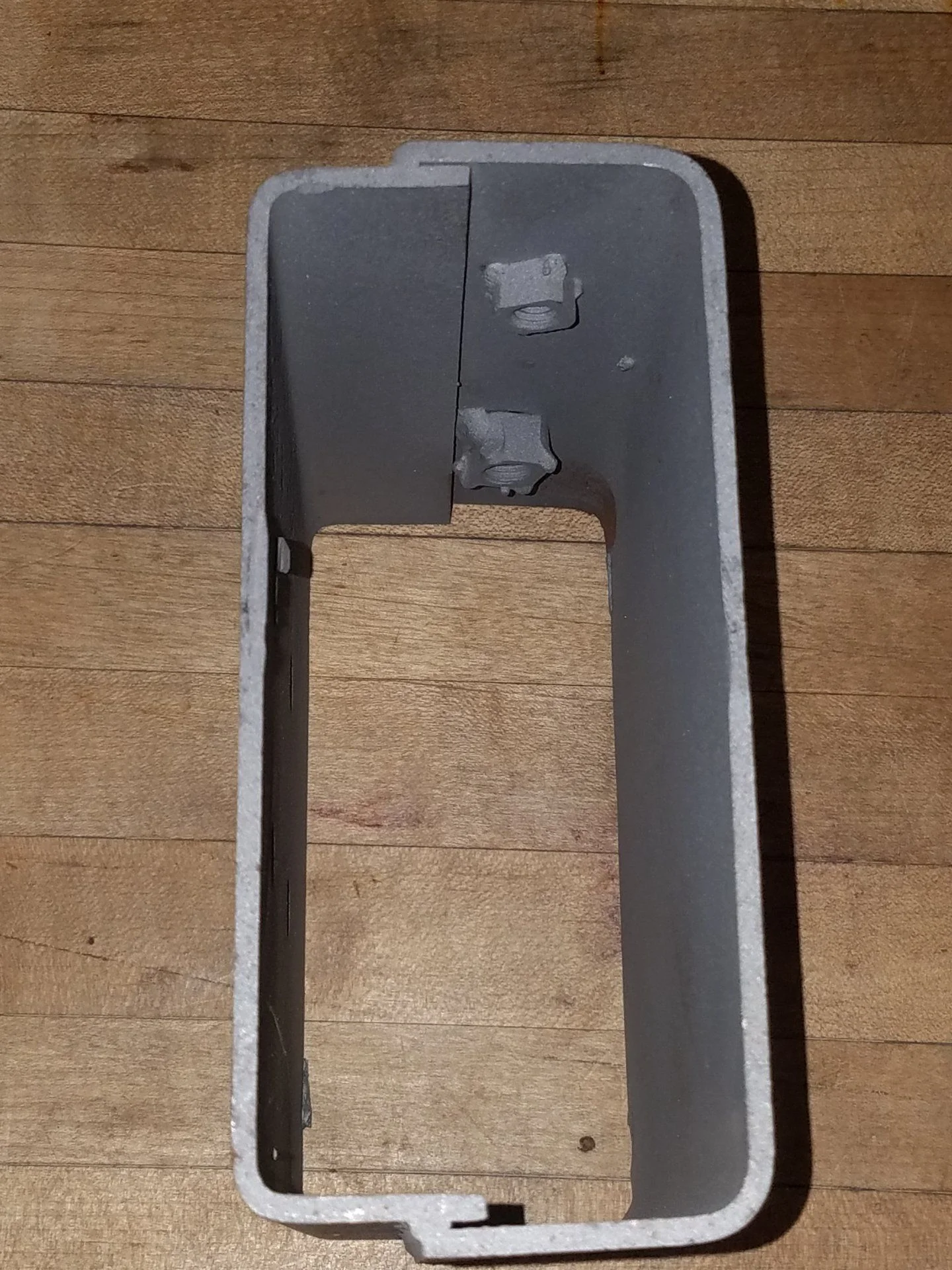

I have not touched this yet since resting the body on the chassis. I have been thinking about about the first things I need to tackle when I finally get to start on it. Boxing the rear of the frame is one the first tasks after I get it cleaned up. I am planning to weld in the spring buckets and square cross members from an 80 series and boxing the rear of the frame seems necessary for to support the suspension.
I have looked at ruff stuffs boxing kit but am considering another approach. I have a very solid fj40 rear frame half and it looks like the rear wheel arches are the same, so I am thinking of using the rear to box the 45 frame. It is already shaped correctly and it is a duplicate of what is already there. I am interested to see what the experience here on the forum thinks of the idea.
The first picture of the frame cross section is from an 80 series. The construction is "C" channel with a smaller "C" channel inside. Since I would be using two equal sized "C" channel frame pieces the overlap would be one in the frame and one side under it. The second picture is two pieces of 40 frame and would be how I would try to box the frame. Does anyone see any issues with boxing the frame this way?

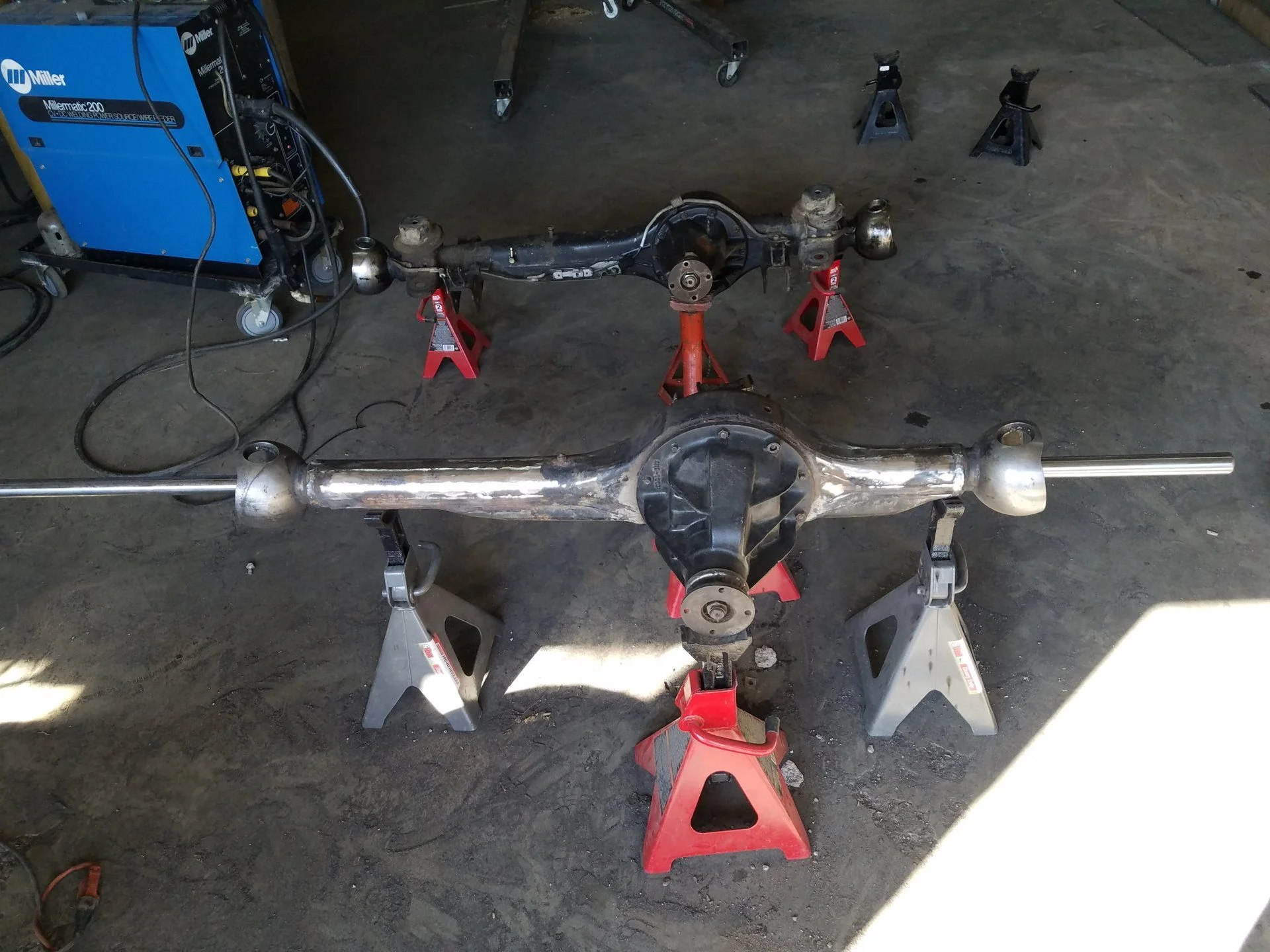

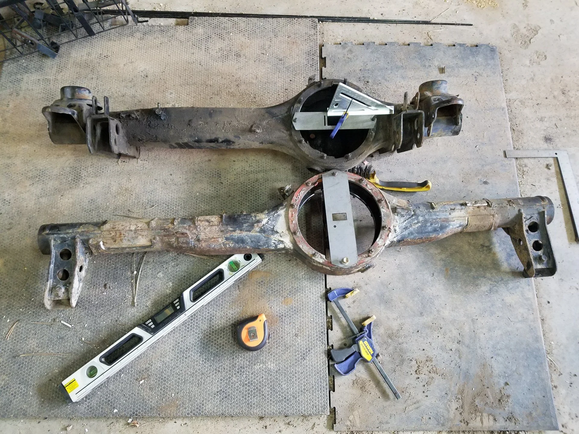

I finaly have a little time to work on this. I started building a front axle for it using an 80 series semifloat housing and the knuckle balls from an 80 front. The plan is to build a 9.5" front housing with 80 knuckle balls and hellfire knuckles. I will then weld the 80 suspension brackets back. Hopefully I will end up with a front axle WMS at about 59".
Mid day, this is as far as I have got. Trying to cut those brackets off clean is tough. Still have a lot of clean up to do.
I didn't finish it yesterday. My digital angle finder was giving me inconsistant measurements, so I bought another model today.
I was able to get the knuckles set and welded up. With the true bar in place everything stayed where it was set. It is all strait. I hope it stays that way after the bar comes out.
I cut 4 inches off the long side. The rear is next.
