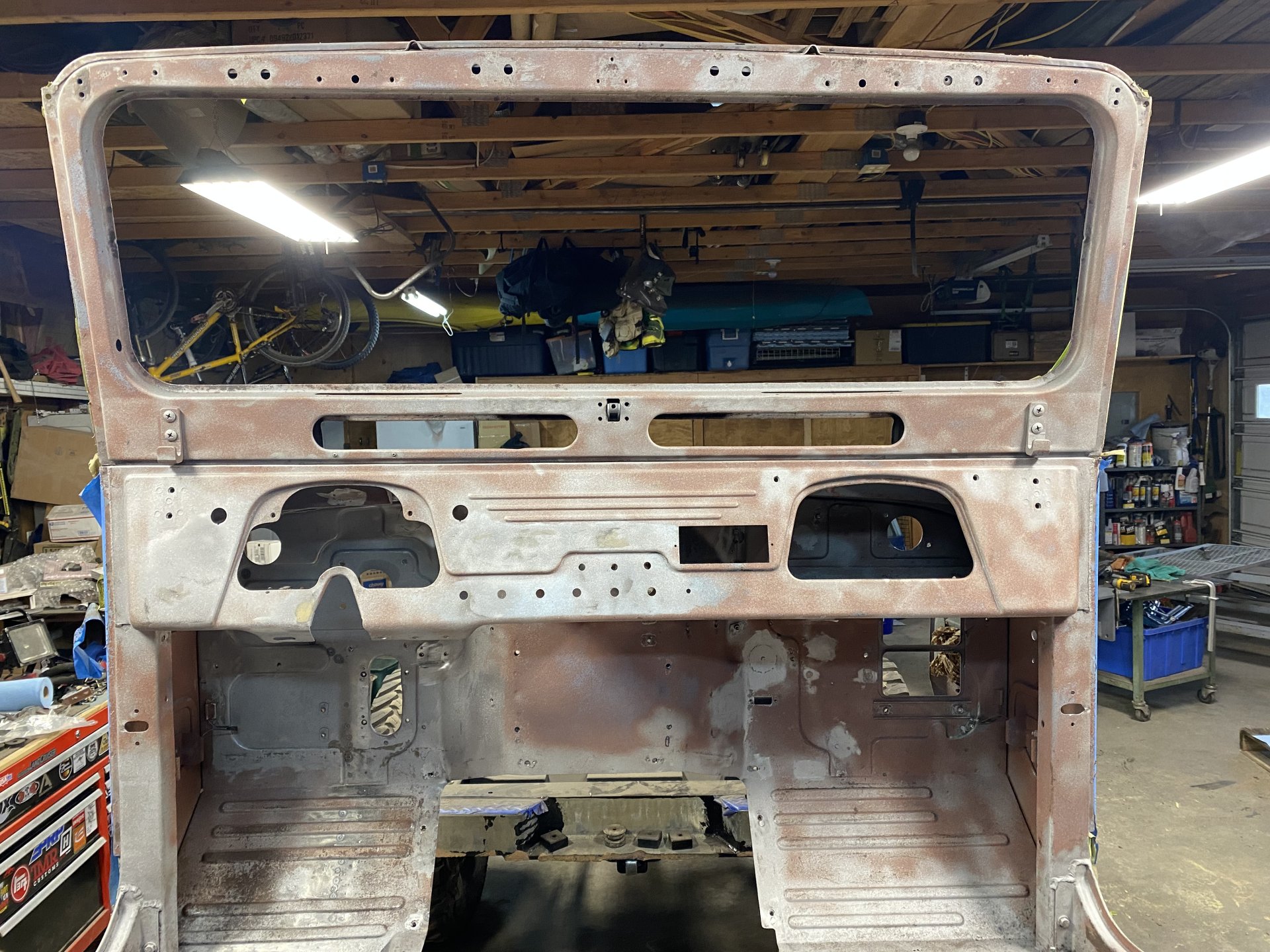

I pulled the cab off and welded up the holes I didn’t need on the firewall, then did the same on the dash. I drilled new holes for my switches. I am hoping to finish this cab soon, so I can put it on for the last time. Getting close.
For those that have not had to fill a bunch of holes in the dash or firewall yet, this kit by Bob Drake made the work move a lot faster. I still had to make a few of the bigger whole plugs but not having to make all of them saved me a bunch of time.

I had set this weekend aside to get the cab painted where I had planned to paint anyway but the weather didn’t agree. We need the rain but wish it could have started after this weekend. I had a window of good weather and was able to get the undercarriage, firewall and inside of the cab blasted. Where the original red primer was still intact I left it. It took fifteen 50lb bags of coal slag to get the job done. I would have gladly paid someone to blast it for me but because I wanted to keep the outside intact I opted to do it myself.
The blaster found a few pinholes in the floor I need to address. The plan is to coat the floor and seems with por15, then epoxy primer, paint, lizard skin on the floor and undercarriage followed by raptor liner.

I used the POR-15 on all the bare seams that I am painting over and in places where I did not feel the media blasting removed all potential for rust. Over the that and the bare metal I will apply some red epoxy primer, then Horizonal Blue but in a satin finish followed by clear coat. After that all cures it will get Lizard Skin insulation liner underneath, on the firewall and the interior floor; then cover the Lizard skin with tintable raptor liner using the base color from the Horizontal Blue.

One thing you might want to do before painting if you haven't thought about it is paint all the enclosed body channels. Will help keep rust away if moisture gets inside.
I did coat some of the enclosed channels that I had access to while making repairs. I am not planning to cut open the other channels though. I purchased some of the Eastwood encapsulator to treat the remaining channels. It comes with a tube that can be extended into the channels to coat the inside.
