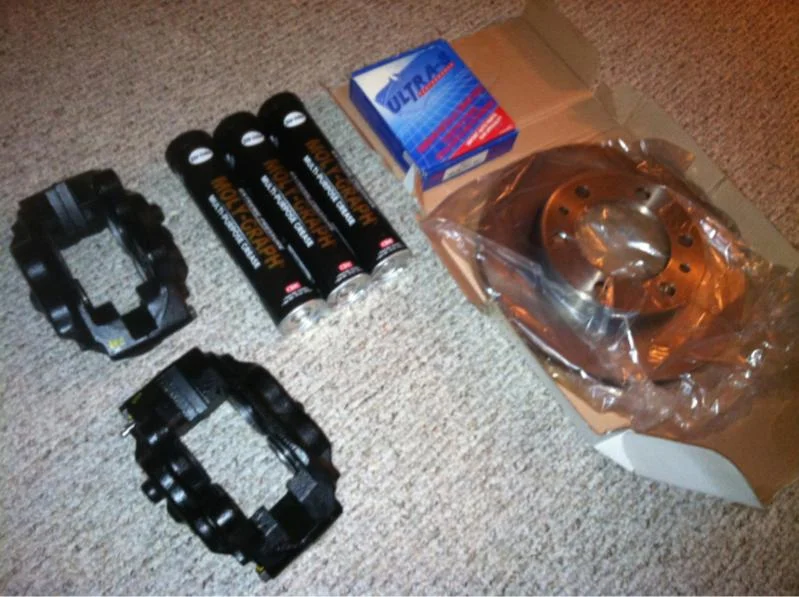

Out with the old, in with the new. Traded in my 60-series caliper cores for some fresh ones, along with new pads and rotors.
Apparently, they don't sell loaded calipers for the 60 series anymore, but they seem pretty easy to figure out. Can't wait to get out of the house with all the clean stuff, and start tearing into the 40 again!
One thing I did notice is that there were some shims behind the brake shoes I pull out of the old calipers. The new stuff didn't come with them - guess I will need to do some research there!
The "shims" are used to hemp make the pads not squeek. Your new ones may have a coating on the that does the same thing. If they dont you can use a product that you put on the back of the pads that does the same thing.
Thanks - that pretty much confirms what I was reading last night - that a lot of companies no longer manufacture their brake shoes to require shims. I'll just lube them up good when I install them, and call it done!

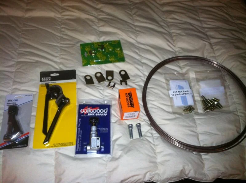

While progress has ground to a halt due to travel and cold weather, I have been slowly collecting parts.
Amazon:
SUR&R Nickel Copper Brake Line (25ft) - I will need more than this I think, by looking at it...
Tubing Bender
Tubing Cutter
Summit Racing:
Wilwood Proportioning Valve WIL-260-12627
Wed-on tombstone hose brackets - seem like the diameter is too wide, so I may be revisiting this
44mm (slightly longer) Rear wheel studs (Dorman 610-265), to accommodate Poser's rear disc brackets
Fed Hill:
Two dozen 10mmx1.0 flare nuts
Up next are caster shims and U-bolts from Georg.
Pictures:
1. The fiance, taking engagement very seriously
2. The important stuff: Spankin' new truck parts.
Hopefully planning (and funding) a wedding won't add too many more delays - I'm dying to get back to work!

When you can't work on your truck - you spend too much time on Amazon. When you spend too much time on Amazon, you end up buying tools you don't need...

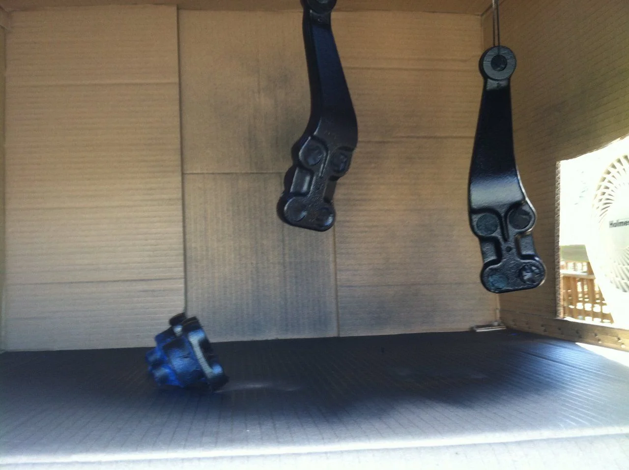

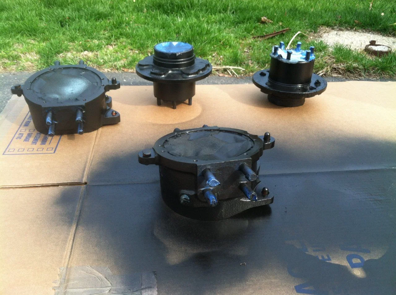

At long last - some warm weather! Got all the knuckle parts cleaned up and primed today. Getting the loose rust, old grease, etc. off these things is an arduous task. Letting the primer cure for 24 hours, will hopefully top-coat it tomorrow. The temperature is still close to the minimum for the paint, so I set up this makeshift paint booth/space heater combo to give the parts a warmer atmosphere to dry in. I really like how the Eastwood Chassis Black Primer has laid down so far. Hopefully I get good adhesion!

That is a great idea mate
Thanks, aside from the obvious fire hazzard or running a space heater next to a cardboard box filled with aerosol fumes, I thought it was a good idea! You can't see it in the picture, but I had a mouth thermometer stuck in the other side of the box, away from the heater, to monitor the interior temperatures. Surprisingly enough, it was actually more difficult to keep the inside of the box BELOW the recommended max of 90F, than above 70F. (almost worked too well).
