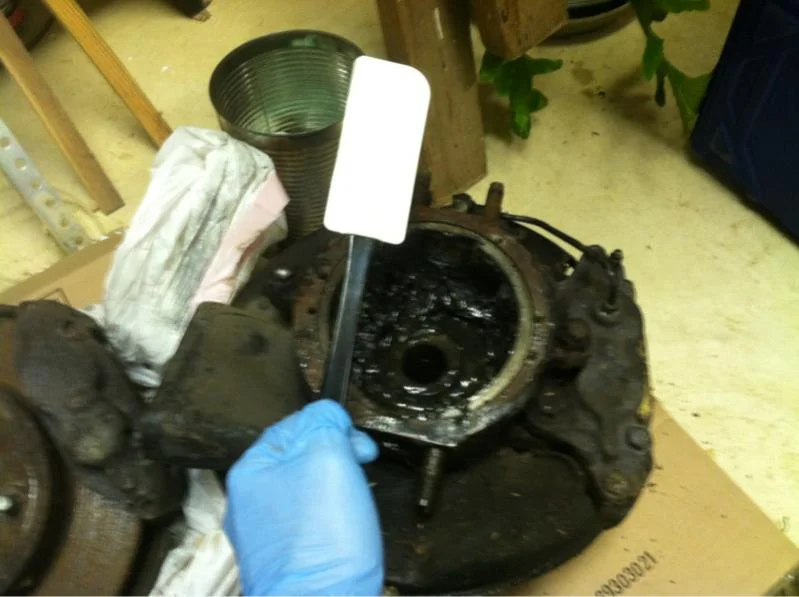

Started digging into it tonight, and getting everything torn down and cleaned up. What a mess! Whoever recommended the spatula was absolutely right...
Removed a ton of grease, 3 cocoons, 2 spiders, and about 15 dead stink bugs...

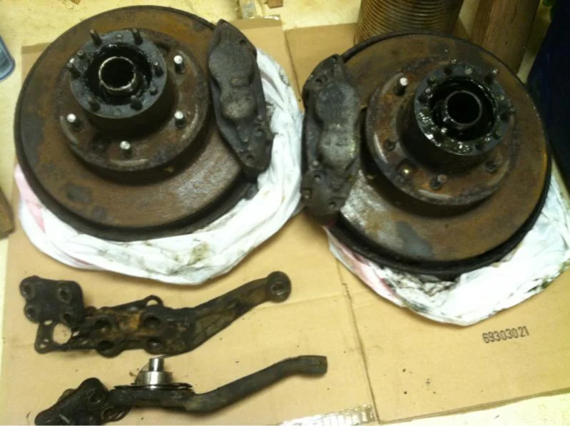

This is about as far as I got... Now The questions:

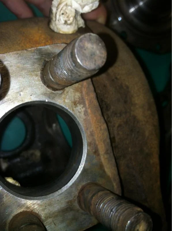

Do I have to knock all the hub studs out to remove the brake rotor? Seems like that is the case. I'm assuming I should replace the studs if I do...is this a job for the BFH?

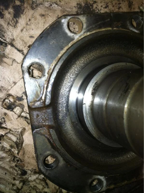

Second: is this a seal? Considered scraping it off but it seems like it is on there pretty good... I'm thinking it is a seal though...

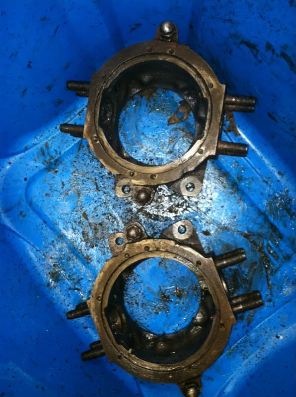

Made some progress cleaning up the knuckle parts. So far, I've disassembled the knuckles and brakes, done cursory degreasing, then cleaned up the steering arms, etc. using Easy-Off oven cleaner. Things seem to be in pretty decent shape. The steering arms cleaned up nicely. The knuckles are going to be MUCH more of a pain!
So, in terms of time: I've got about 2 hours in general disassembly of the knuckles, an hour in spatula degreasing, then a 2 hour soak in easy off, and about an hour of parts scrubbing with a wire brush...

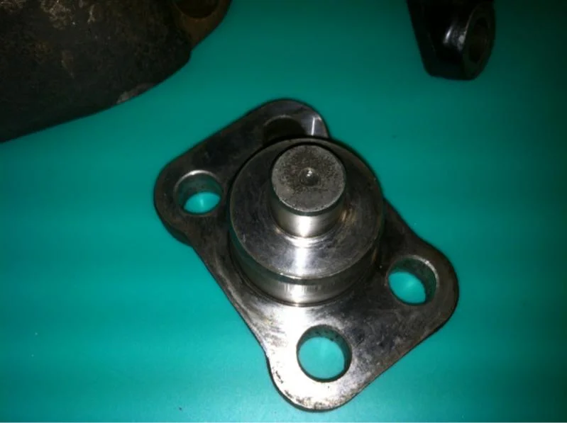

The only point of potential concern, so far, is some pitting here. Not sure if that is a big deal or not...
Pitting on the bottom trunion bearing shaft just means that there was water or just moisture in the housing at some time. That is no big deal. Keep up the good work.
I wouldn't worry about pitting on those parts. Do make sure those machined shim surfaces are free of burrs created by previous owner attempts to remove them by wedging something between the knuckle/arm or cap. Any burr can be filed flat easy enough.
Thanks guys - the only issue I'm running into is getting the studs out if the hubs/calipers. I've doused them in penetrating oil, mushroomed a drift entirely hammering on them with a 4lb sledge, and the things wouldn't budge. I'll have to find a press I can borrow.
Also - getting the grease out of the interior of the knuckle is slow going as well...normally wouldn't bother, but want to get a coat of paint on them. I can just see some grease from inside getting on the outside during paint and screwing up the adhesion.

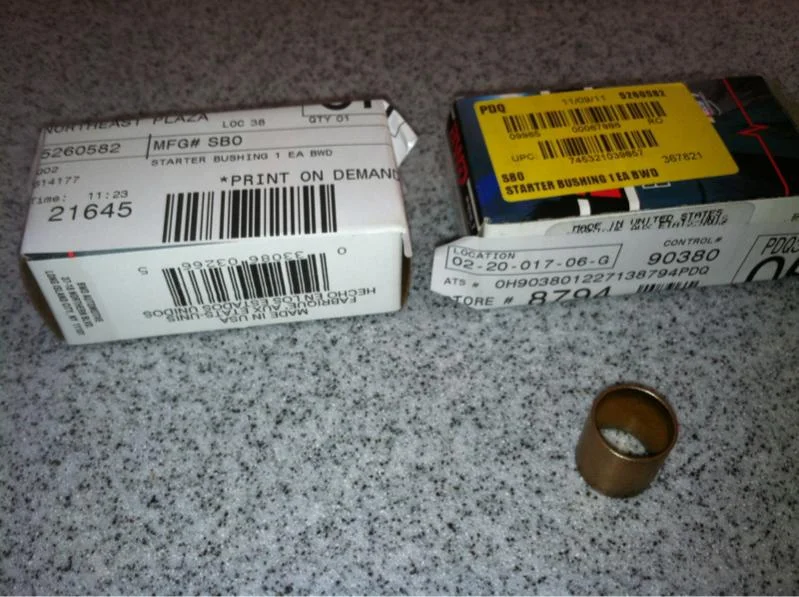

Bought some part# SB0 Starter Bushings, which will be used to adapt the 60 series steering arms to my 40 series tie rod ends. Considered upgrading to 80 series stuff, but my TRE's are literally 6 months old, and have about 60 miles on them...
I bought 4, since I will probably mushroom at least one getting them seated.
I've heard tell of these starter bushings failing or wallowing out (since they're brass) but it seems like, in general, most folks are happy with them. Certainly cheaper at $2.00 each than the $15 steel shims that are available for this purpose. Hopefully I don't wind up regretting this decision!
You should scrape off that paper gasket or wire wheel it off best you can. Want a nice smooth surface for a new gasket. You will need to press the hub studs out using either a press or sometimes a c clamp will work. Hammer and drift will not. Personally I would use the steel bushings, just seems more betterer.

Yeah, wire wheeling is still to come, right now just focused on getting all the heavy grease and gunk off. Those paper gaskets really get stuck though - a wheel (or at least a brush) will definitely be necessary. I guess is the bushing fails, I'll go to the steel shims.

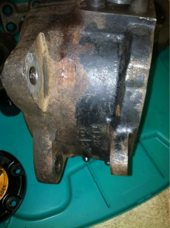

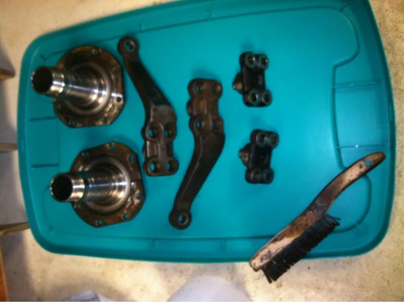

2-3 coats of easy off, followed by blasting with parts cleaner, and the knuckles are starting to look like knuckles. I'll still need to wire wheel everything to get rust/residual paper gasket off the seal surfaces.
There is some pitting on the surfaces. Not sure if I should be concerned or not...
There is also a nasty rust deposit on on of the shim surfaces - I'm hoping it will file/wire wheel off. That said, the rust is where the shim doesn't sit, so I'm not overly concerned. I also think it will buff down. Thoughts? Concerns?

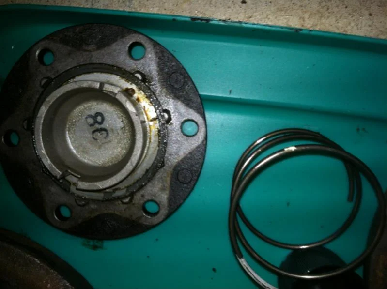

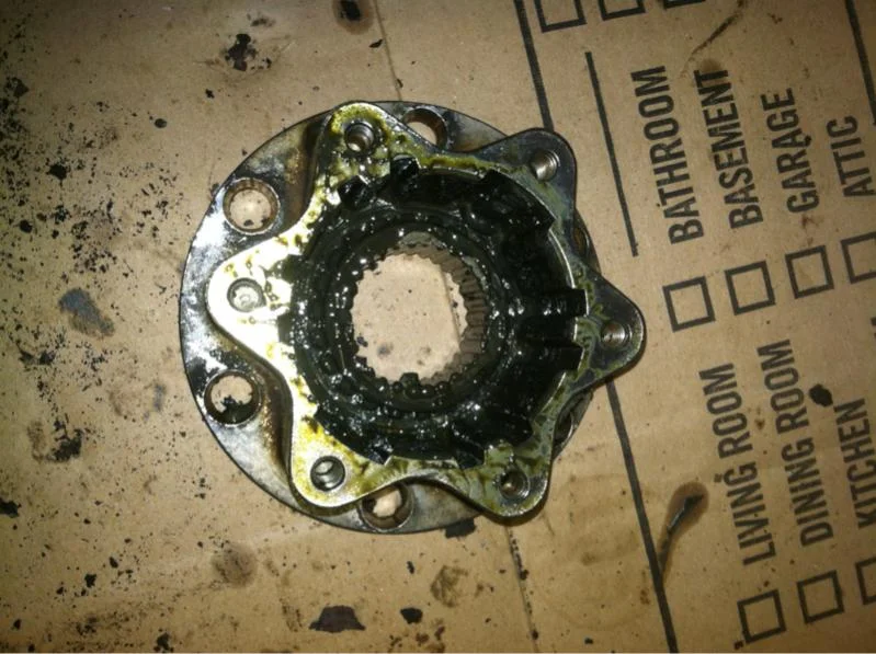

Started disassembling the locking hubs tonight as well. I'm wondering how far I should take this? Do folks typically remove all the snap rings and fully dissassemble, or do they just clean up the seal surface, replace the gasket and move on?
There's some definite birf soup in one, so I'm thinking I might disassemble and clean. After the knuckles, degreasing these things will seem like a cake walk!
