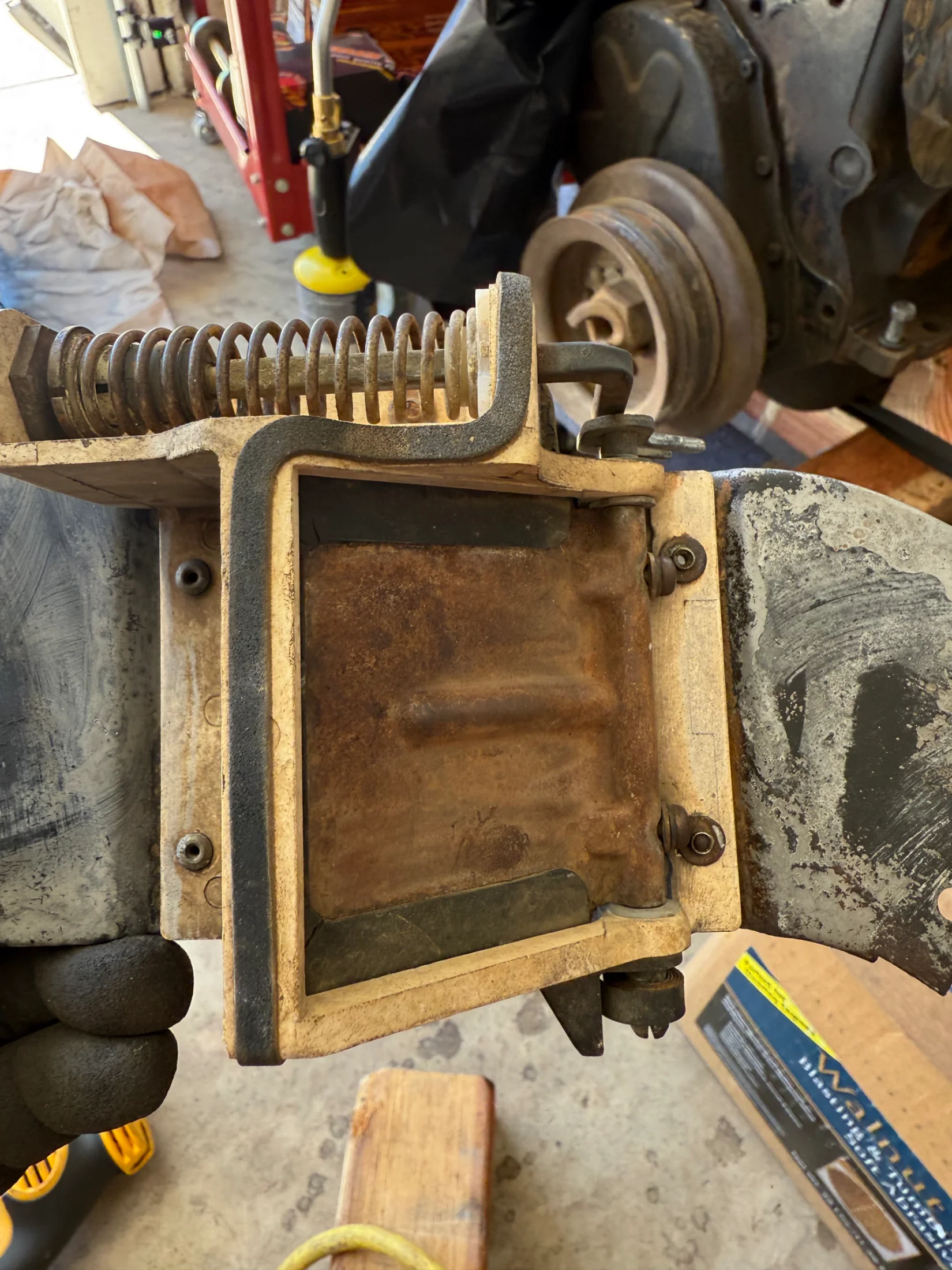

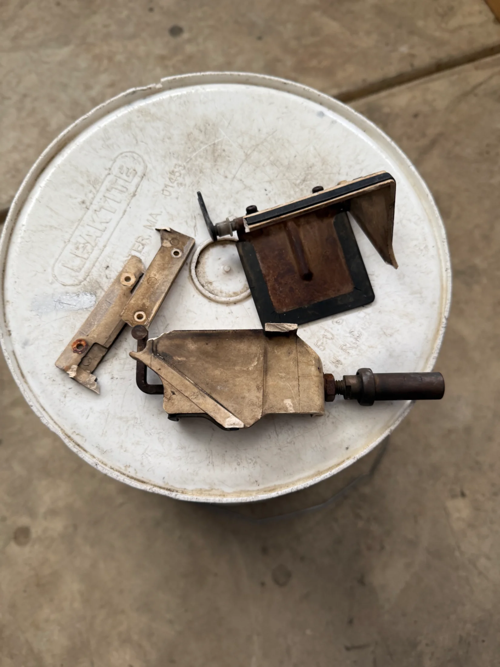

So I took apart the air cleaner and separated the flapper from its base. And then…I dropped it. Is it necessary? My plan is to install headers, which means the bracket for the warm air hose won’t/can’t be reinstalled. Photos below for reference and because everyone loves to look at carnage… Thanks!

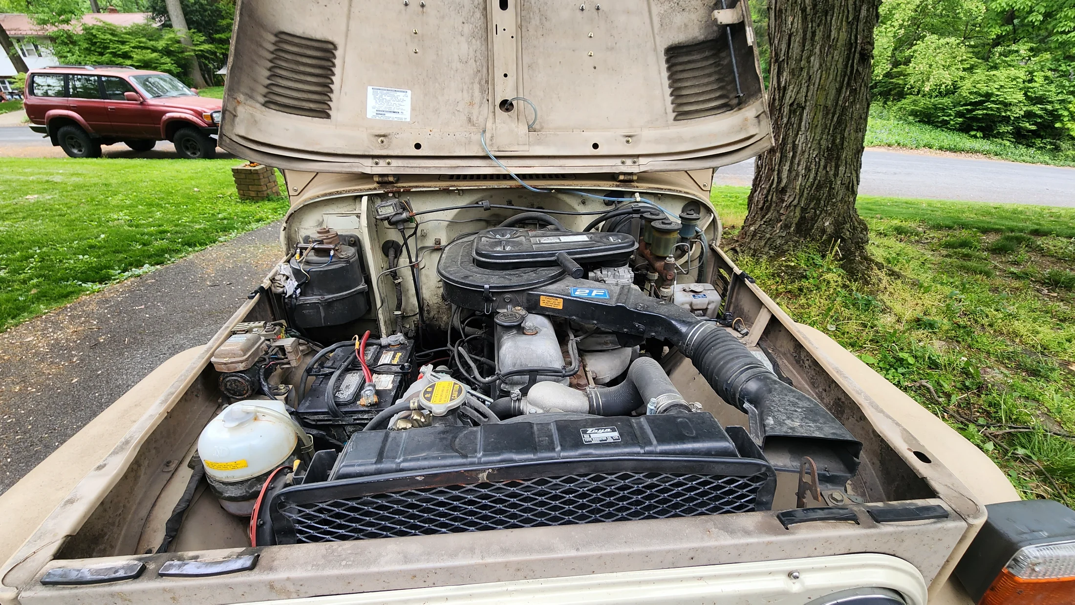

Does it get cold where you are? Yes consider making/buying a fluid heat riser for the bottom of the intake manifold - will prevent carburetor icing most of the time.
I like my 72 big air cleaner. I just made a new foam element ($20) for the manny oiled foam filter I put on back in 84.
No, block off that bottom opening, get city racers intake hose, be happy
