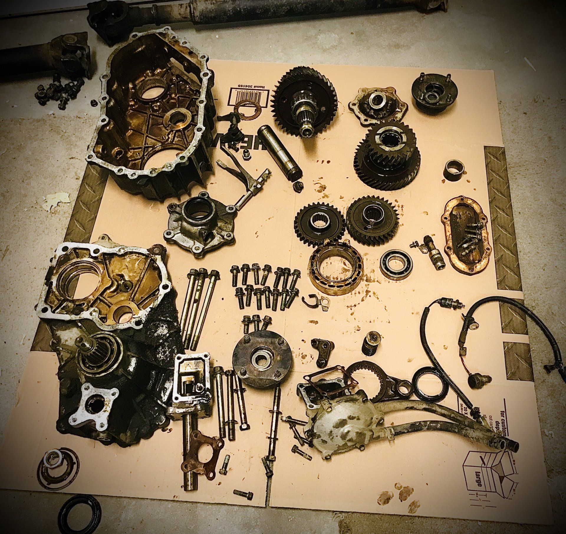

Thanks to @PabloCruise helping me, we are here.
Everything looks pretty good. Minimal tools worked, air tools would have been much faster. Still need to press off bearings, hopefully my friend here in town has a press.
