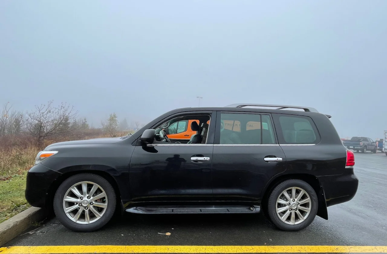

I have a 2008 200 series (Actually it is an LX570 but AHC is shot, so will delete) and I am looking to swap in suspension. I am ok with an inch or two lift, but want to keep a fairly smooth ride. I will probably put at least a front steel bumper on it, and potentially some weight in the back, but mostly it is going to be a daily driver and some weekend off-roading. Might do some trailer towing for camping.
