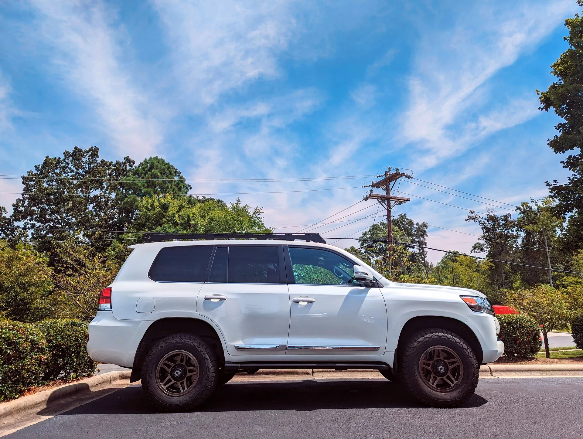

I'm getting close to 100,000 miles on my 2016 and have ordered a Dobinson IMS kit. I'm not lifting much, just 1.4" in the front and .75 in the back. It will be a few weeks or more as some of the parts are backordered, but I've been really impressed with this setup on my son's 4th gen 4Runner. Here's an image the shop sent me of someone else's install, although they went with 2.5" lift on the front:
