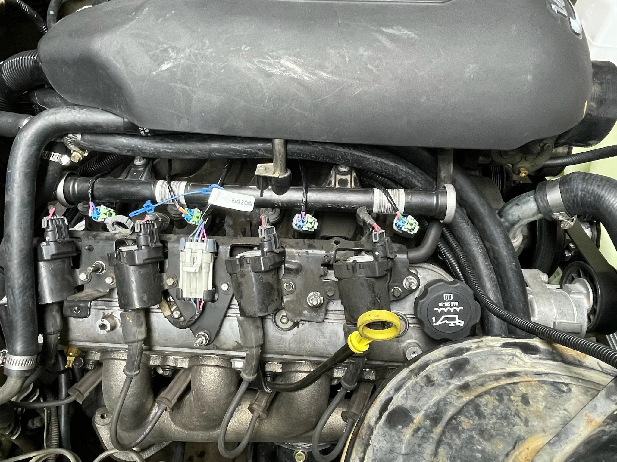

Got the cooling system plumbed up, don't have much to add as I followed @dbbowen's thread to a tee.
Here's a pretty easy way to flush your heater core through the valve, just drilled a hole through a rubber plug and put a cheapie funnel through it. You can stick a hose in there too but I used distilled water to flush everything.
Here's the heater lines all done up
Installed my Mosley radiator and got it plumbed up. For anyone installing one in the future, it really helps to loosen the bolts to the radiator brackets on the firewall first, then bolt the radiator to them and tighten them up afterwards.
Here are the part numbers for the hoses I used (in addition to what's noted dbbowen's thread)
-Heater valve to 5/8 tee - Dayco 87730
-Rear Heater Hoses - Gates 18079
-Upper Radiator hose - Gates 23093
-Lower radiator hose - Dayco E71990

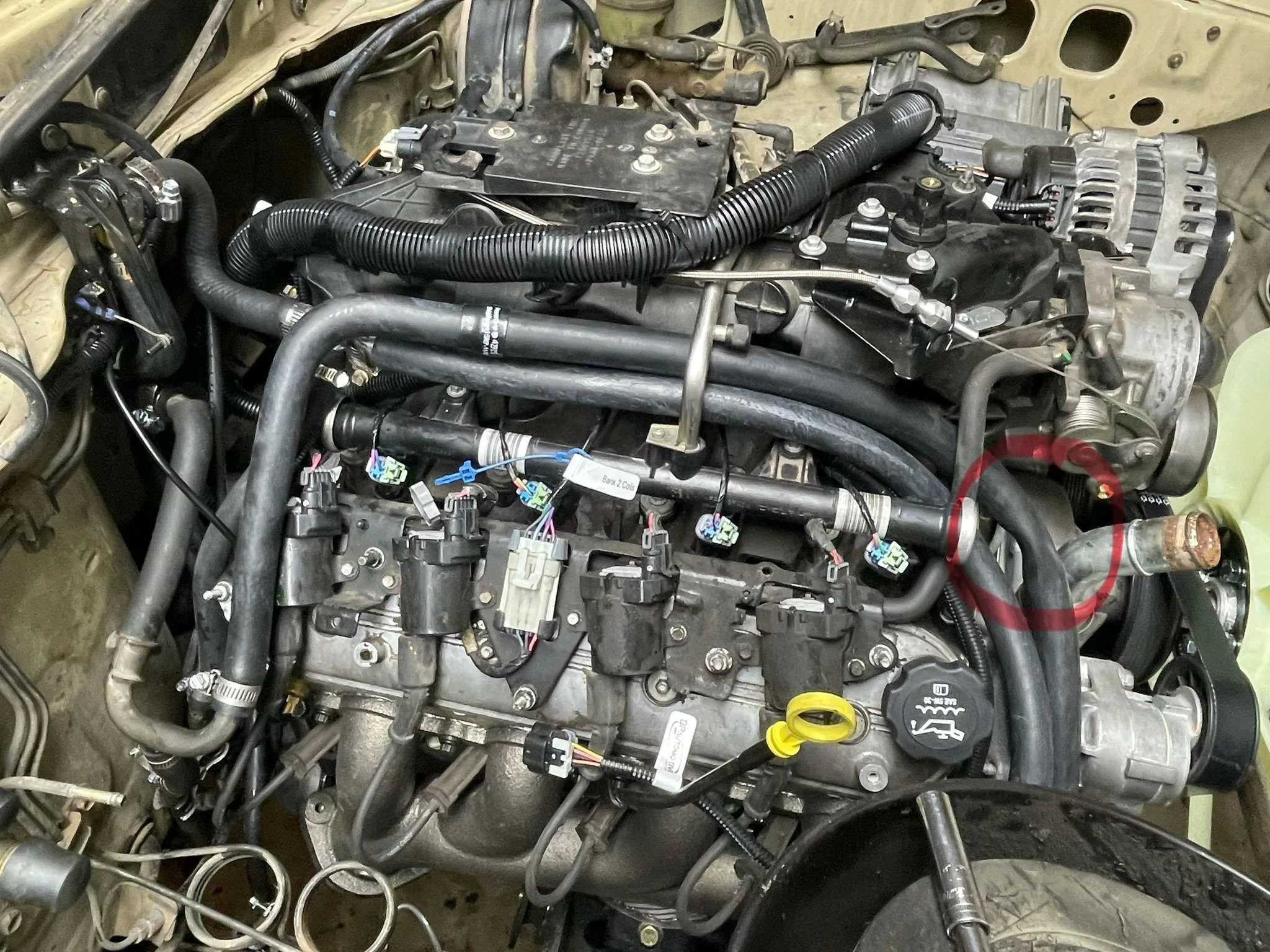

Hopefully you noticed that heater hose?
I did - that's how the hose came which is a little annoying but I'm not too worried about it, I'll squeeze it as I'm filling it with coolant and it should be fine.
UPDATE - heater hose fixed itself, kink went away as soon as I got coolant into the system

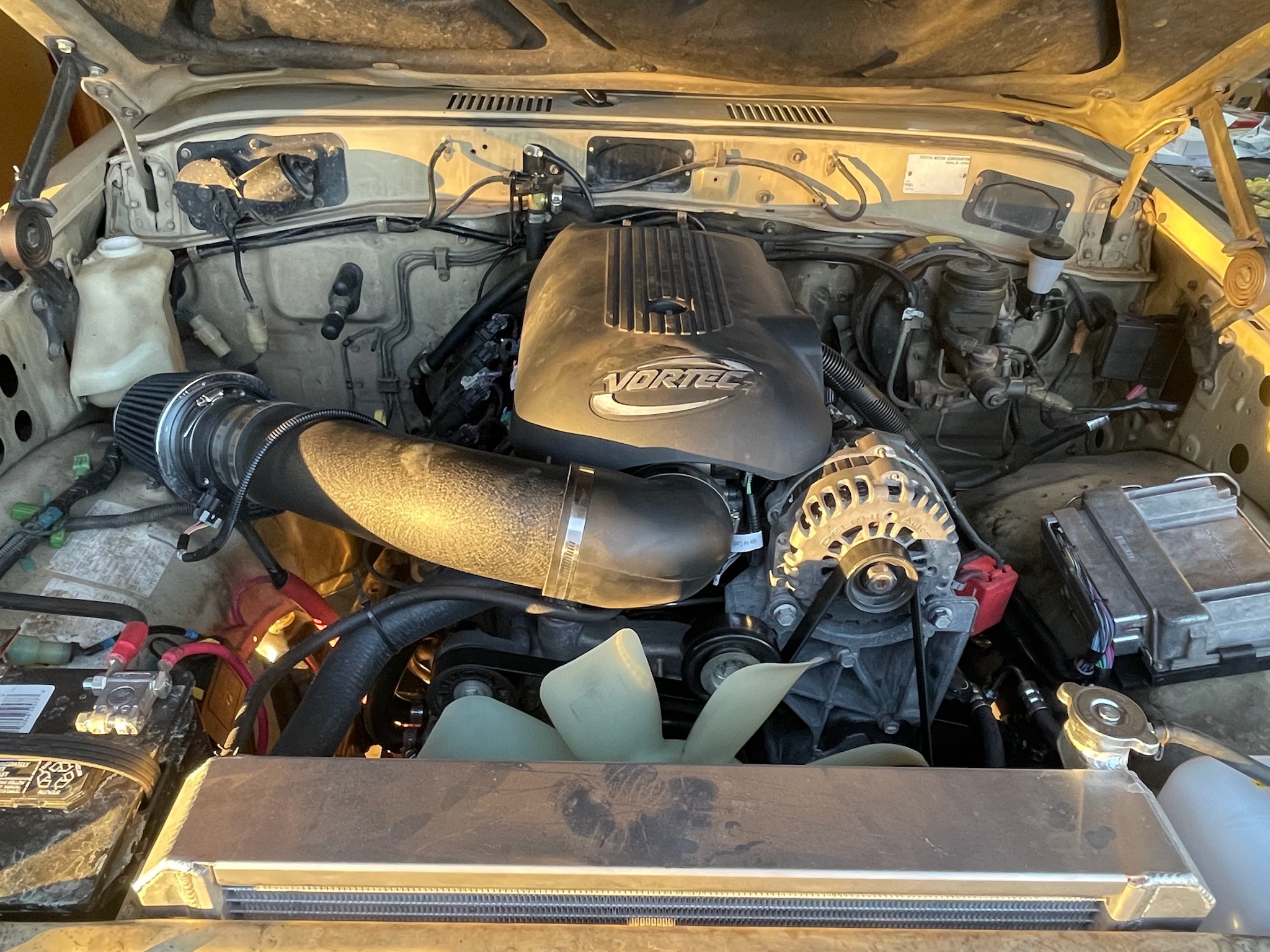

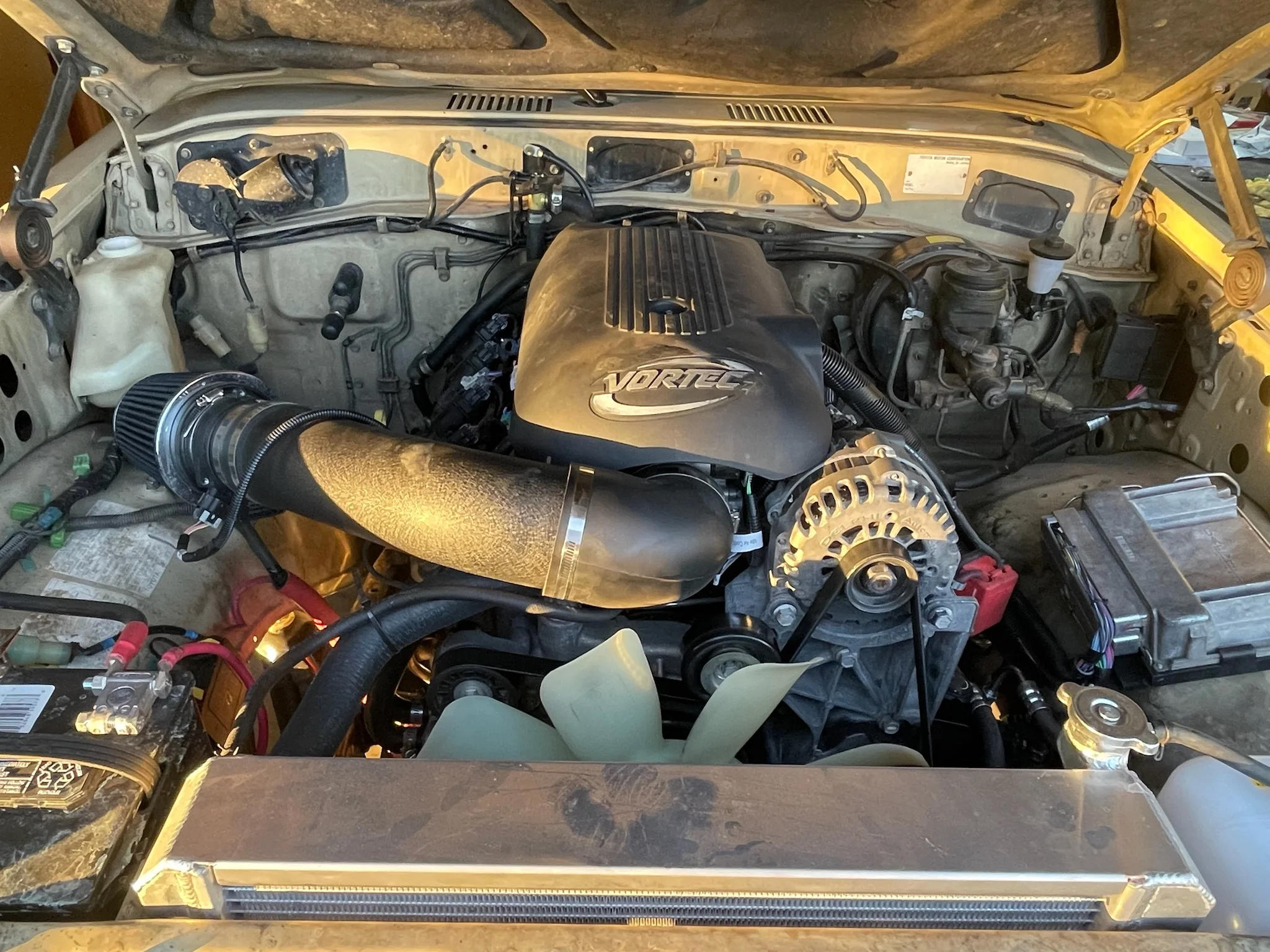

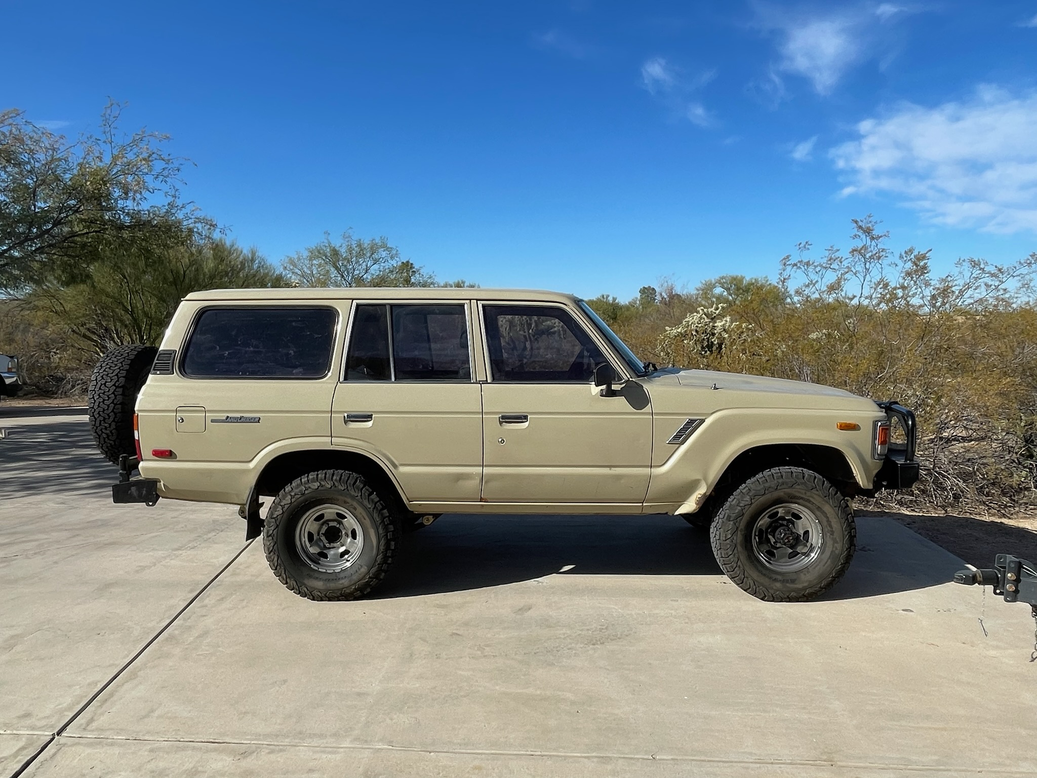

It's been a while since I updated this thread, but have got the truck to where it's driveable and enjoyed it the last few weeks.
I wasn't able to get the air intake finished before I got it to the exhaust shop so I bought a cheapie $50 air intake from Amazon and made it work. I'm still throwing a MAF sensor code but I think it's due to the intake tube being 4" which is larger than stock. I'm going to be redoing the intake with a stock 60 series intake and an 80 series lid. This cheapie setup has worked pretty well in the meantime to putz around with.
I'll then take it to have a proper tune put on, even though the BP Automotive base tune is pretty damn good.
The exhaust shop did an incredible job, I went with a stock sounding exhaust with a single tailpipe. I'll grab some pictures when I'm back home in February but its pretty quiet and is routed really well.
Before I left town I was able to get a few weeks of driving time in and the LS swap is 100000000% worth it. Here are my first impressions:
  • Even with the 5.3 instead of the 6.0 there is so much more power than stock. I actually find myself speeding more often than I’m not – which is absolutely insane in an old brick like this!
  • The H55F with 3.70 gears (due to the 10% OD gears in TC) is fantastic. It’s more like a four speed though, in normal traffic I’m typically starting in 2nd gear to takeoff, and can cruise at 1800 RPM going 50 in 4th gear. I haven’t taken it on the highway yet to see what those RPMs are but think they’ll be relatively low.
  • Engine temp with the Mosley radiator is pretty good – hovers around 190 degrees and climbs when I’m stopped but that was due to not having a shroud. @cruisermatt sent me one that he makes for the Mosley setup and am excited to get it on when I’m back.
Prior to the swap I had never pulled an engine by myself, and knew next to nothing about LS engines. I had never rebuilt or even removed a transfer case before this build. This swap is doable by literally anyone with a good set of tools and are willing to put in the time to do research. There is so much valuable information on this forum and through it's members that I am so grateful for. Special thanks to the below members who helped guide me along the way:
