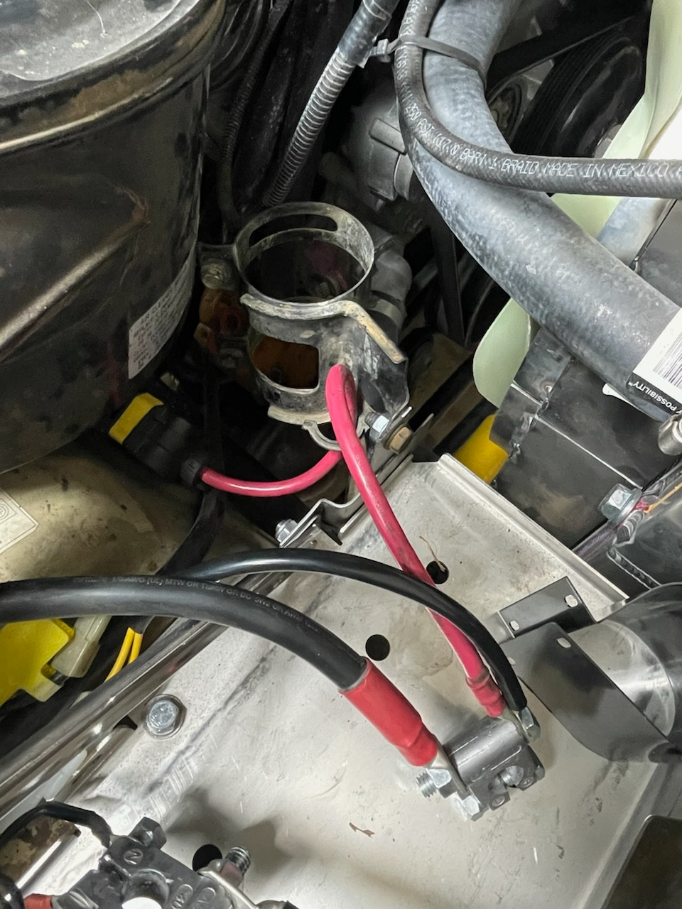

Final pic of the engine bay with everything connected and installed.

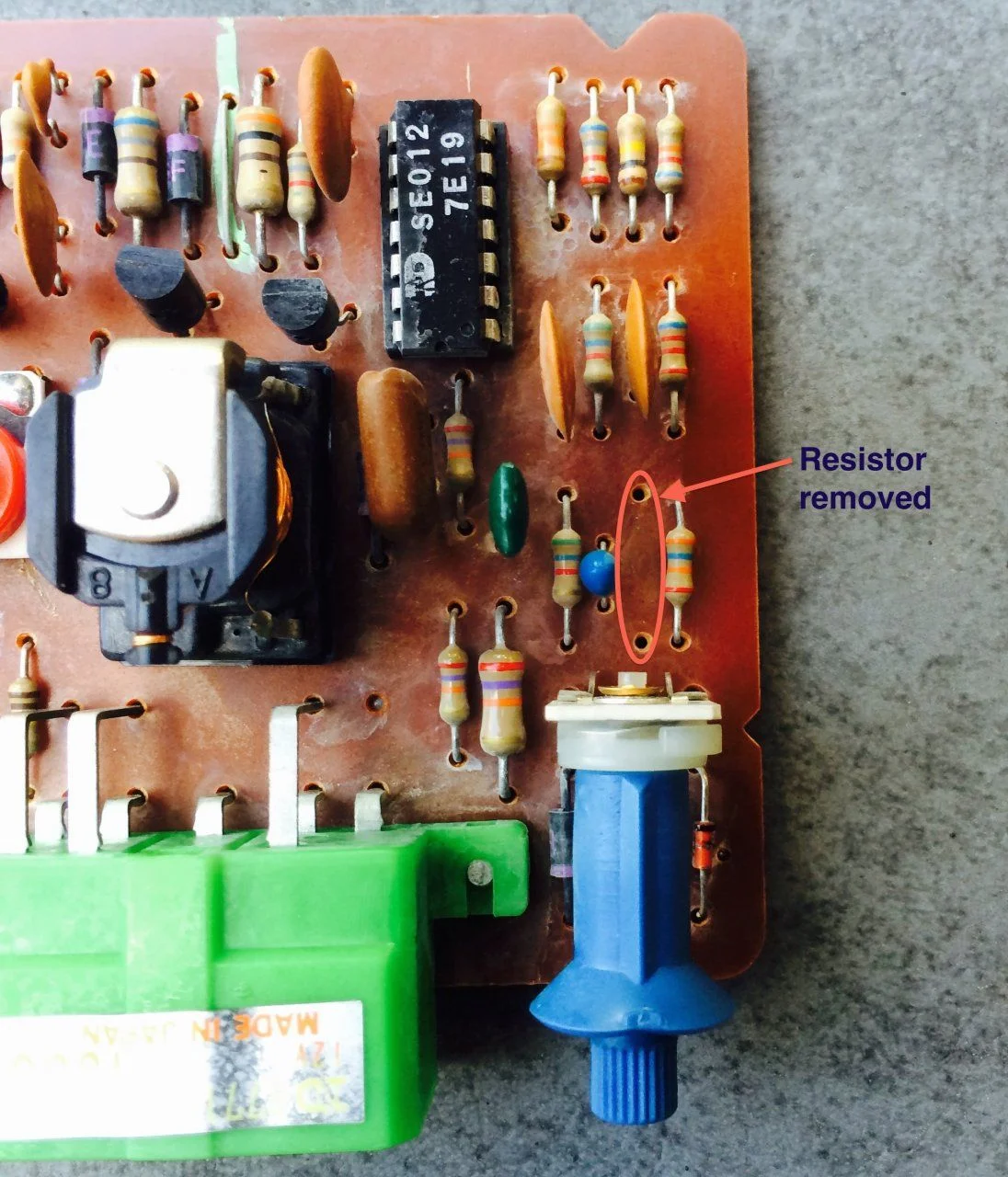

With everything connected the last thing you need to do is get the wiring sorted to get the compressor to kick on. There are a few different ways to do this, keeping with my plans to follow the path of least resistance I just decided to use the FJ60’s factory A/C system to engage the compressor. To do this you’ll need to remove the amplifier and cut out the resistor that requires a RPM signal to get the compressor to engage. Here is the one in question:
Sorry for bringing up an old post, but what board is this? I am just starting to work on the AC of my LS swapped 60. I am using the Holley Terminator to run the engine and trans, so I would like to use the FJ60 trigger for AC.
That’s the factory AC amplifier - can find it on the evaporator box behind the glovebox.
