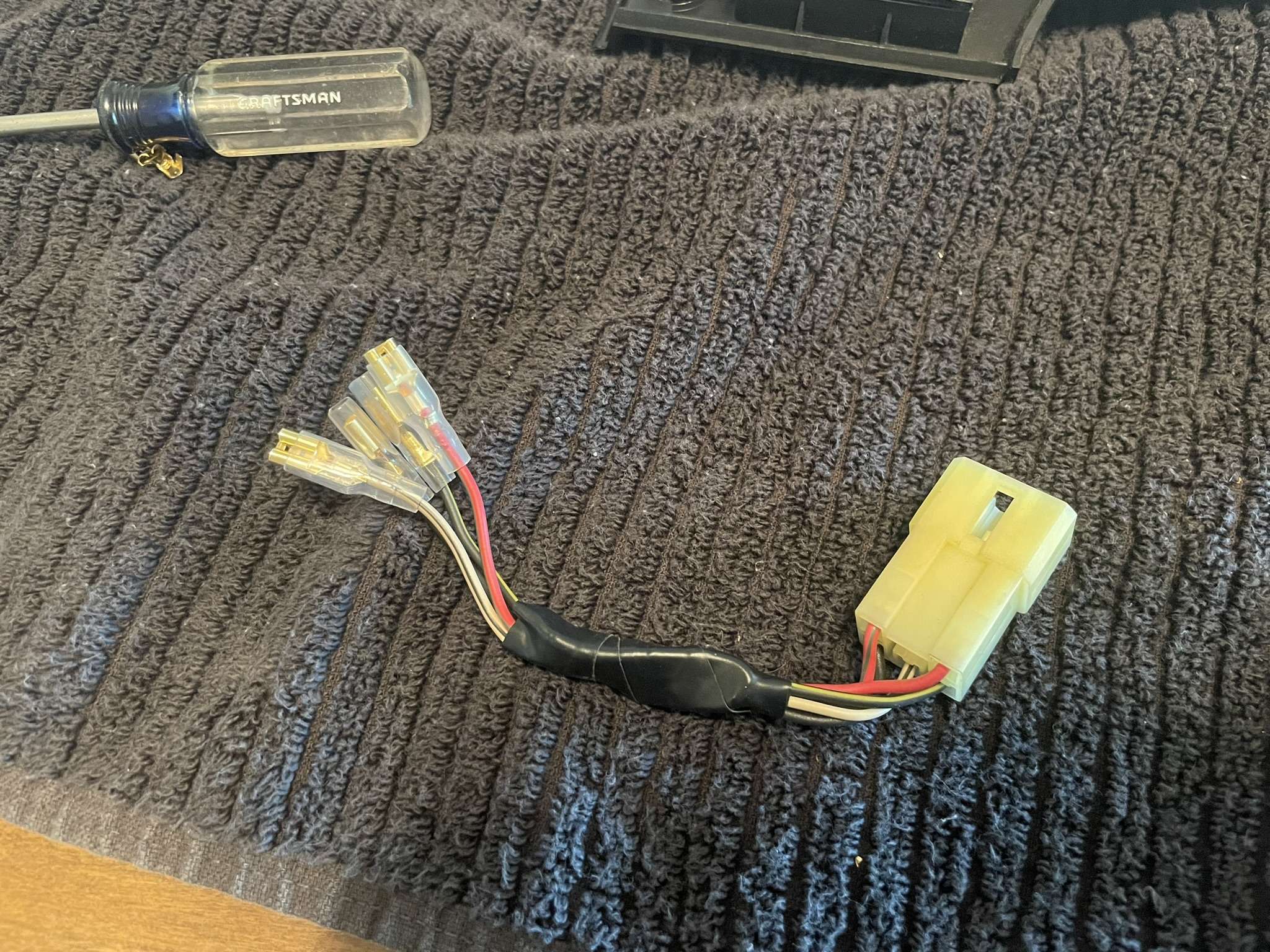

Got back at it this weekend and started by modifying the OEM harness on the RPM gauge to work with the aftermarket VDO. Pretty simple setup and all I have left to do is connect the wire from the BP Automotive harness and the RPM gauge is wired in.

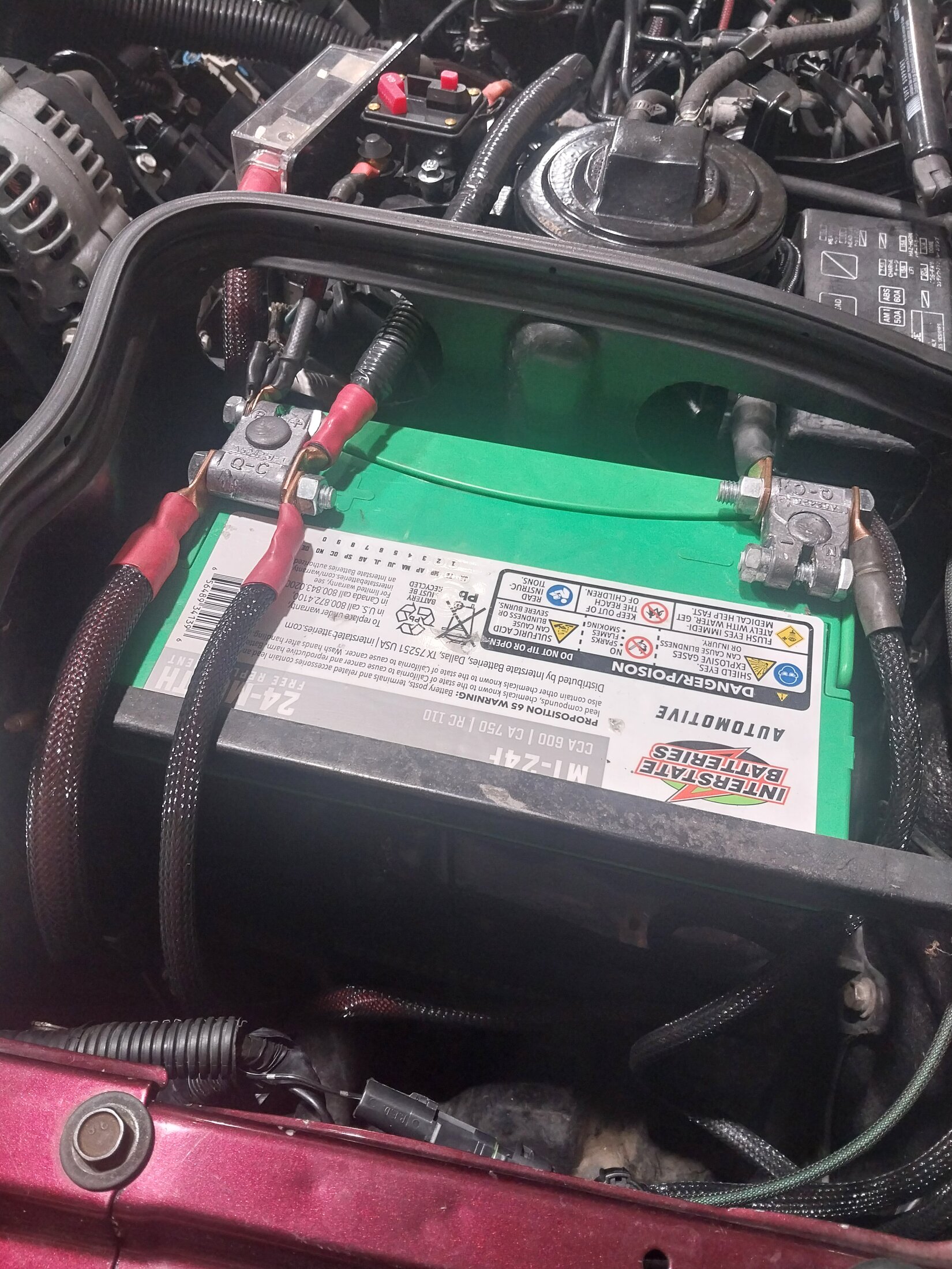

I still have to hook up a few things & make my new battery cables until I'm done with electrical but am pretty stoked to be where I'm at. Anyone that's done this swap before - did you route a negative cable from the battery to the body with a separate negative cable from the block to an engine mount bolt? Figured the more grounds the better.

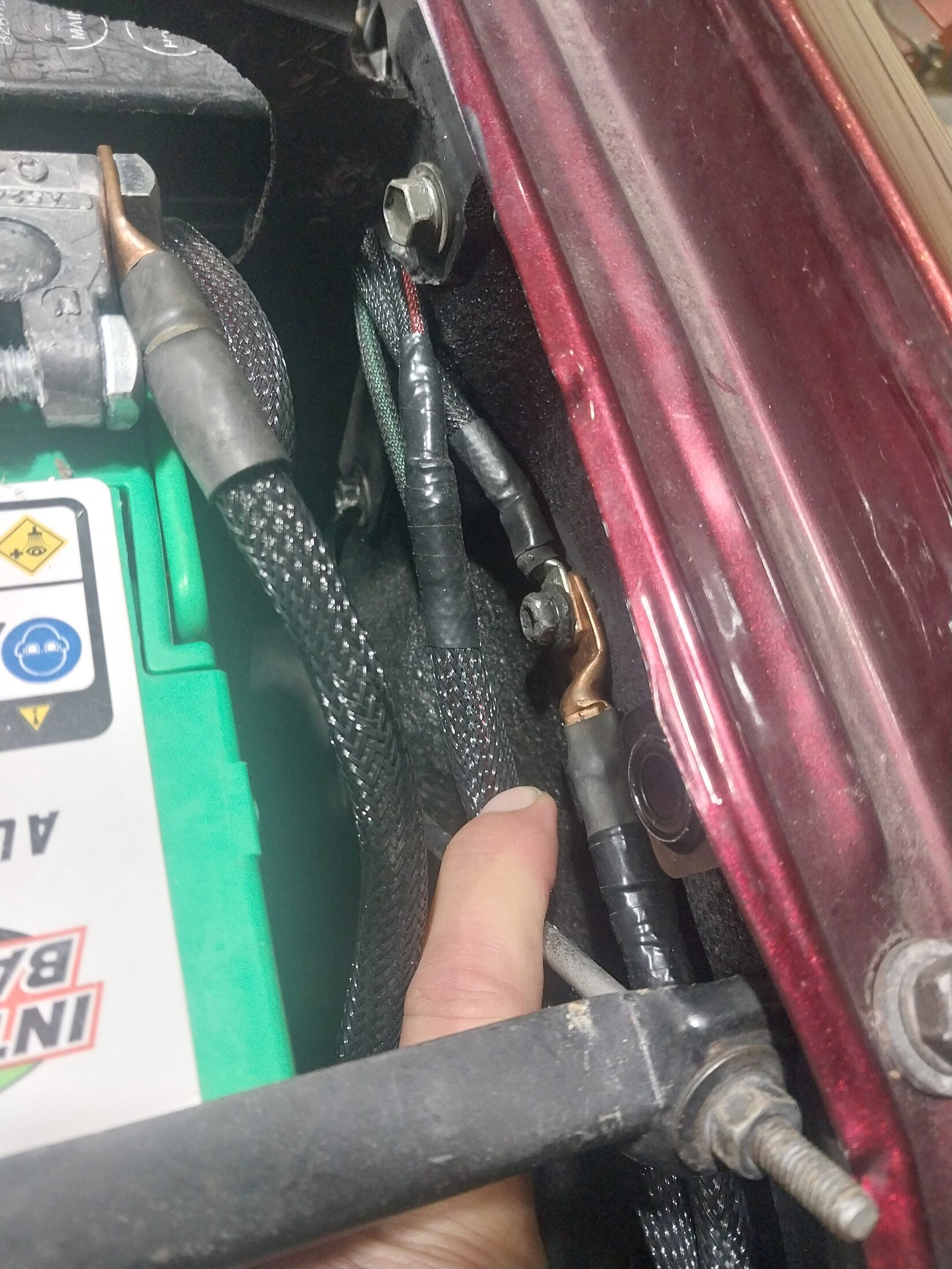

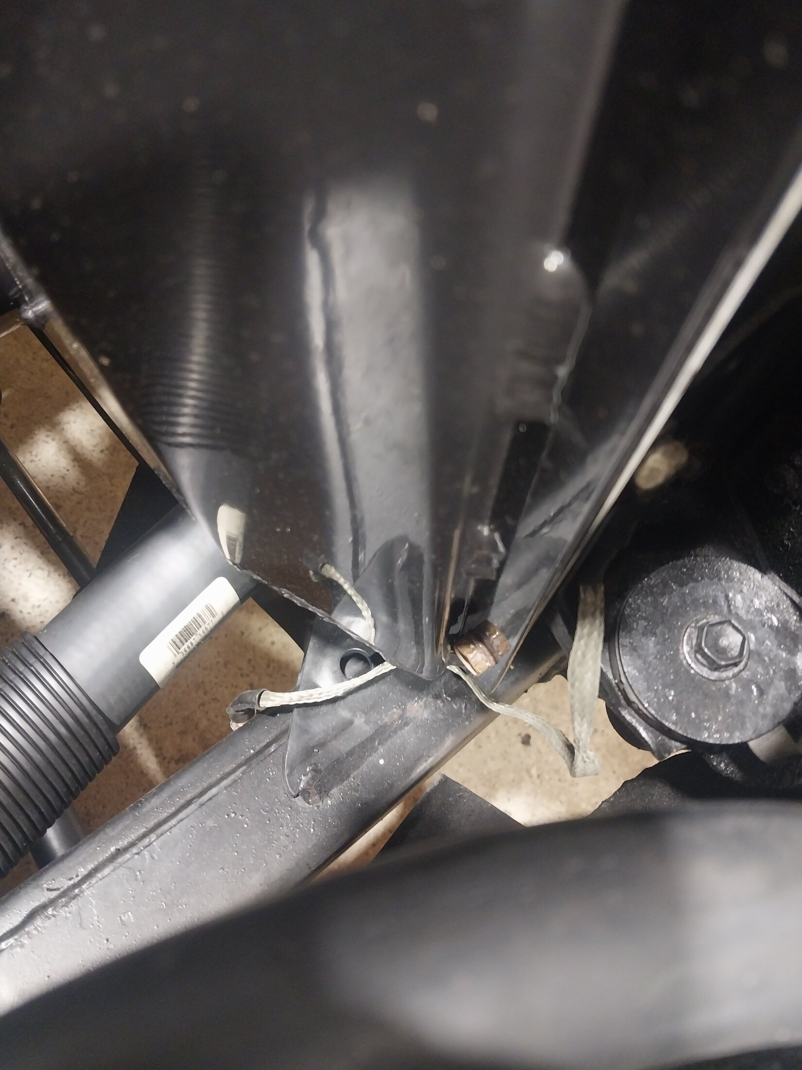

I used this kit from a mud member for my swap. Very burly.
It includes:
Battery negative to fender and motor mount cables
Ground strap from head to firewall
Ground strap from starter to frame
I use the factory gm wiring but your engine probably didn't come with it but I also run a ground on both sides from engine to frame one also from the back of the head to the fire wall and one from battery to the fender ground location also one on tye back of the tcase to the under body like factory landcruiser. I also use mil spec battery terminals.
Been sick the past few days but am still chugging away on the wiring. I ended up buying battery cables from @Fourrunner as suggested so am waiting for those to come in.

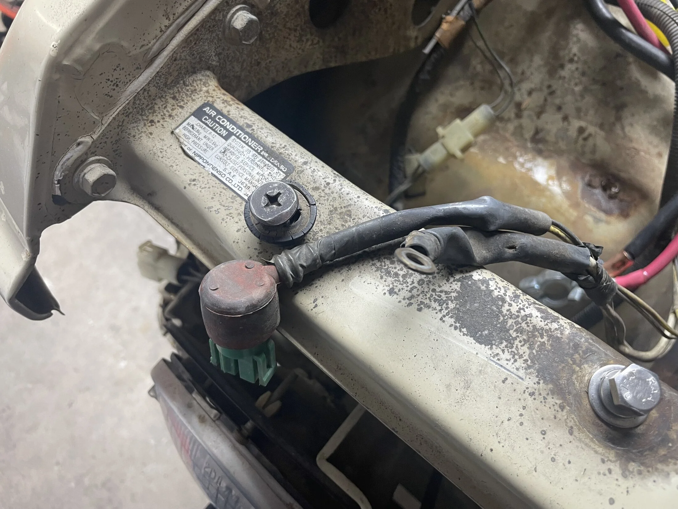

I saved the best bit for last as I hadn't really touched the wiring on the passenger fender at all. There are quite a few plugs and looms on this side including where the fusible link plugs in, the harness that runs to the transmission & starter, washer motor plug and the old alternator wiring. Because of how short some of the wires are I wasn’t able to run it through the fender like I did on the passenger side.
The only part of this wiring that I had to cut was the old alternator wiring – I cut the plug off, heatshrinked the ends and then wrapped it in the harness. The two large white cables that go to a single eyelet on the old alternator were then extended using 10 GA & 12 GA wire respectively. I ran them along with the new 6 AWG cable that I had crimped onto the fusible link box noted above. The fusible link box is mounted on the fender using two holes for the fender apron clips. I wanted to mount it up higher but unfortunately with the new airbox and how short the cable is to factory plug my options were limited.
I was able to harvest the old loom & harness connectors from the original harness that ran under the oil pan and used those to route these new wires to the red junction box where the LS alternator fusible link connects to. Once I had my lengths right I removed the harness, wrapped it in electrical tape & plastic conduit and did my final install.
It was a little tedious, but these are the charging wires for the new alternator and I wanted to make sure they were routed properly. I also took some old heater hose I had lying around and put it over the part of the harness that was making contact with the motor mount to protect it from wear over time. It’s a little hokey, but I really don’t want any problems with these wires.

  • RPM Gauge Wiring (Only if using aftermarket RPM Gauge, you can use the stock one but will need some kind of converter)
    • Stock RPM Gauge Wiring:
      • Black – Gauge Ground
      • Black/Yellow – Switched Ignition
      • Red – Old tach signal wire, can be deadheaded & put in the harness
      • Black/White – Light bulb ground
      • Red/Green – Light bulb power
      • You’ll connect the wire from the BP Automotive harness to the Ignition Coil/Alternator tab on the back of the gauge. My gauge had dip switches and is set to a 4 cylinder as I believe that is what the signal from the ECU is. Will confirm when I start the engine up for the first time
