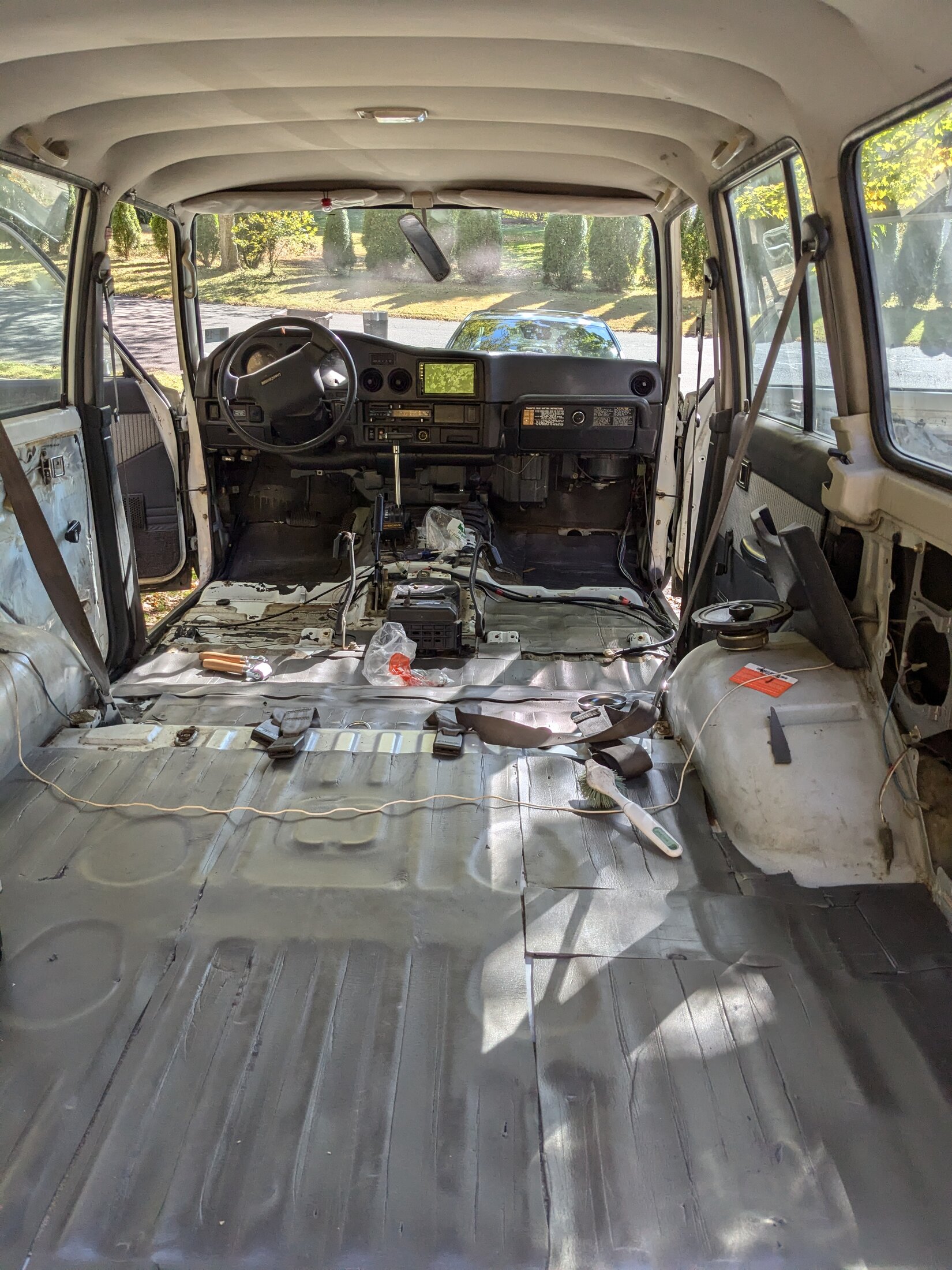

I have to go through the doors next as some had some internal rust damage and it shows on the inside. My wife is getting me a die grinder for my birthday (tomorrow) so that will help with more detail work!
Quick update:
Tackling the doors and their rust!
Bottoms were rotten out decided to take out the door and finish the job as it was hard to reach. One down one to go. I'll probably be pulling them out to paint so obviously not final product, but paint is probably far away.
Waiting on some Bondo to start body work seriously. I got a die grinder but no attachments so back to shopping.
I need some Bondo to fill out the area behind the quarter panels by the windshield to make it nice and smooth. I bought some 045 paint to match the color, and I'll spray that area so I don't have to take the fender off when repainting.

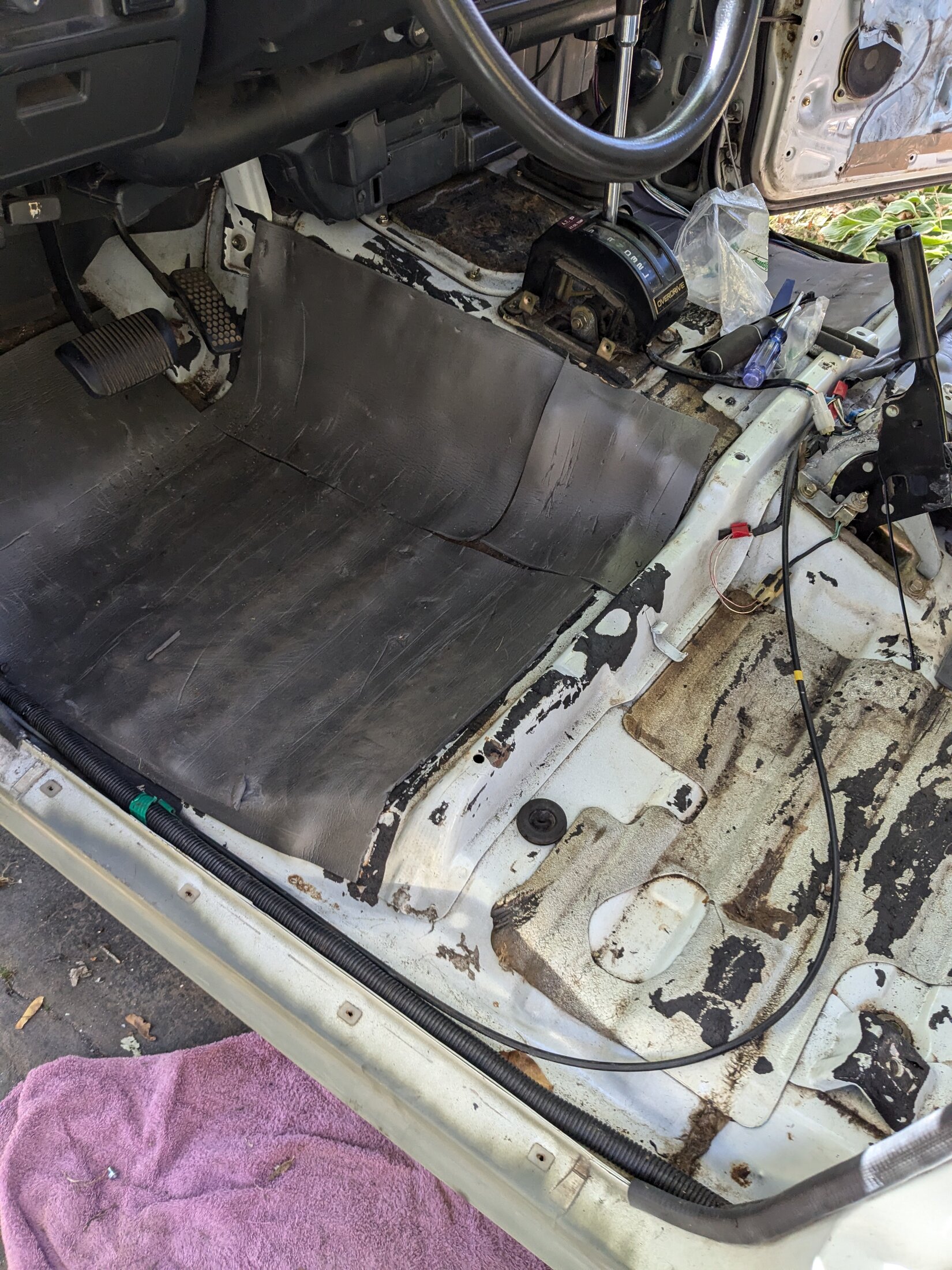

Laid some insulation, used a bunch of Bondo, and will need more. Fixed the exhaust hangars, and the speedometer cable. I had a can of Toyota 045 lying around and chose to use it as a test and painted some of the one side.

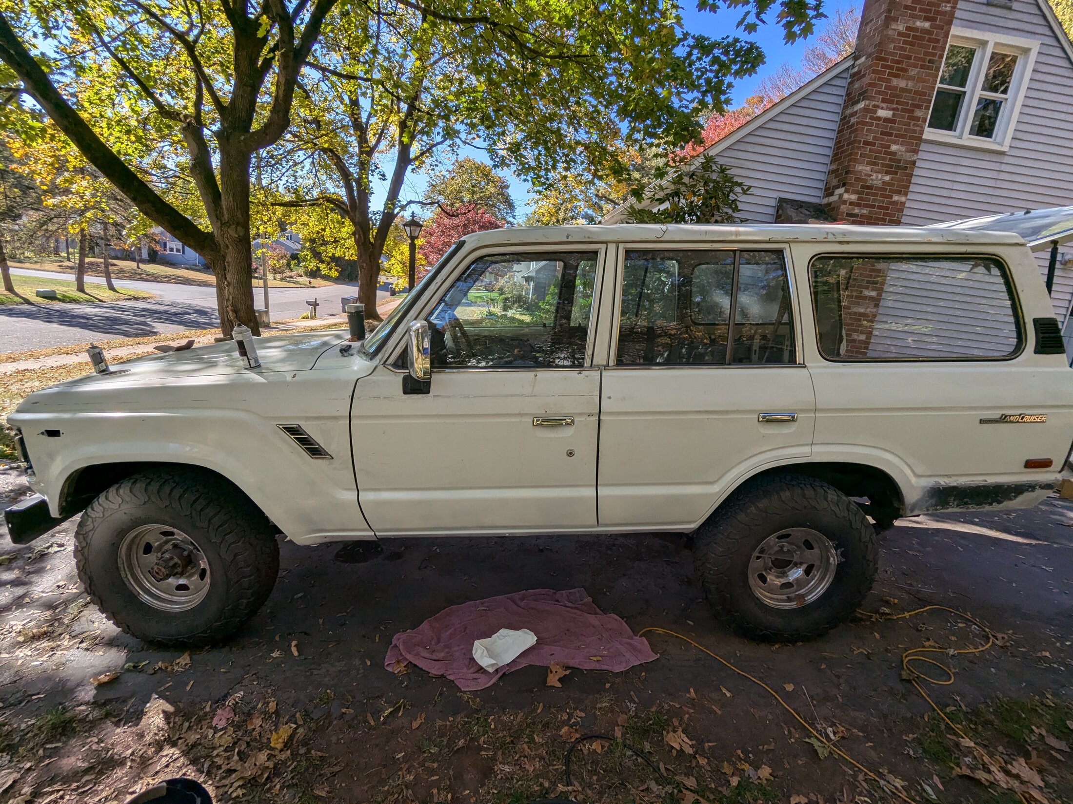

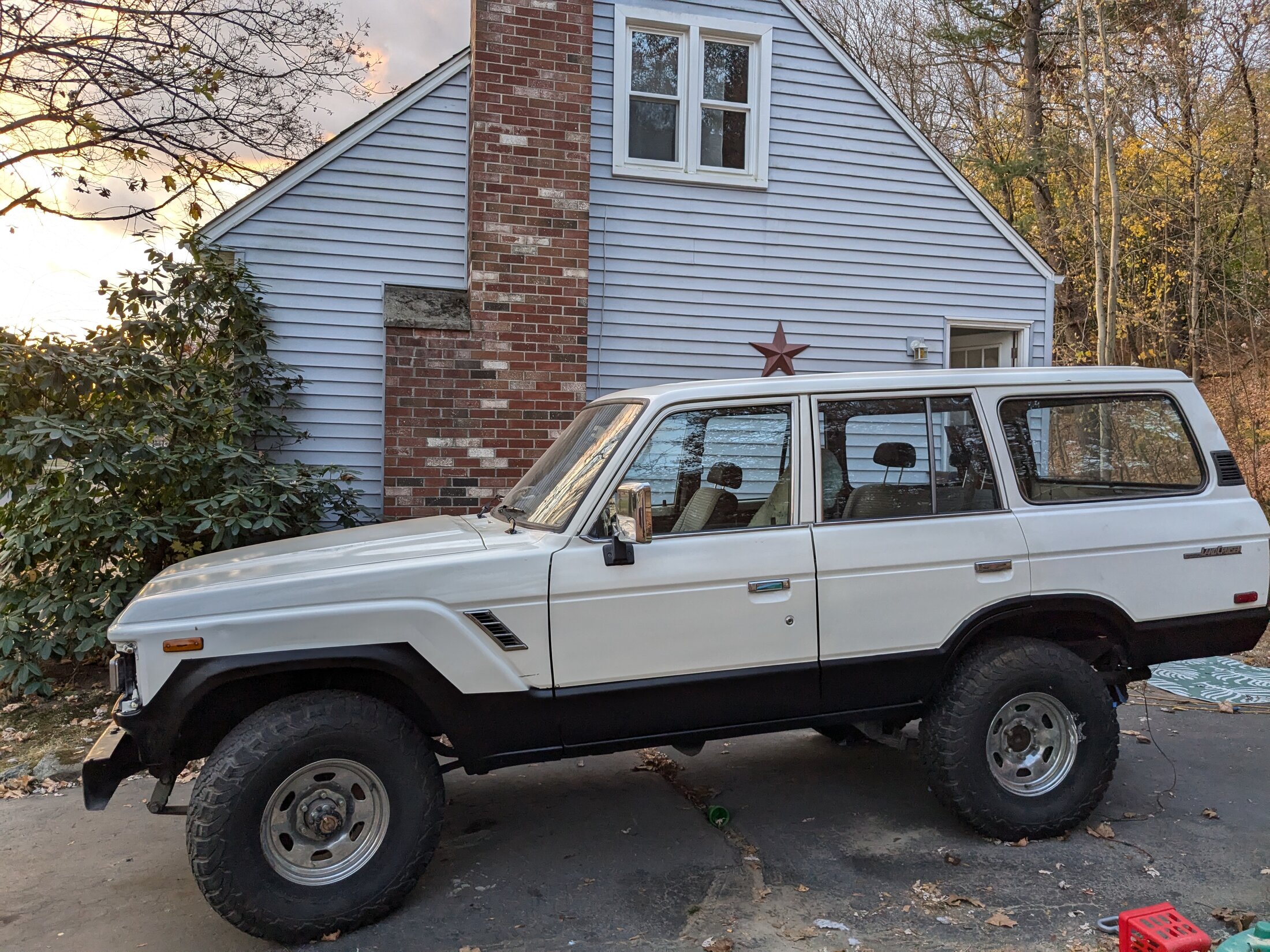

The field paint mess is done! It was my first time so I struggled really badly with the gun. Made runs etc.
Learned quite a bit. It'll last me through the winter and I'll probably re do it next year with a little more patience.
Definitely a 20 footer. But it LL keep the rust out! When its dirty no one will be able to tell :)
A little update:
I 2 toned it with bed liner. I with I took a better approach near the front quarter panels. It doesnt look that great with sharp cut offs. Oh well.

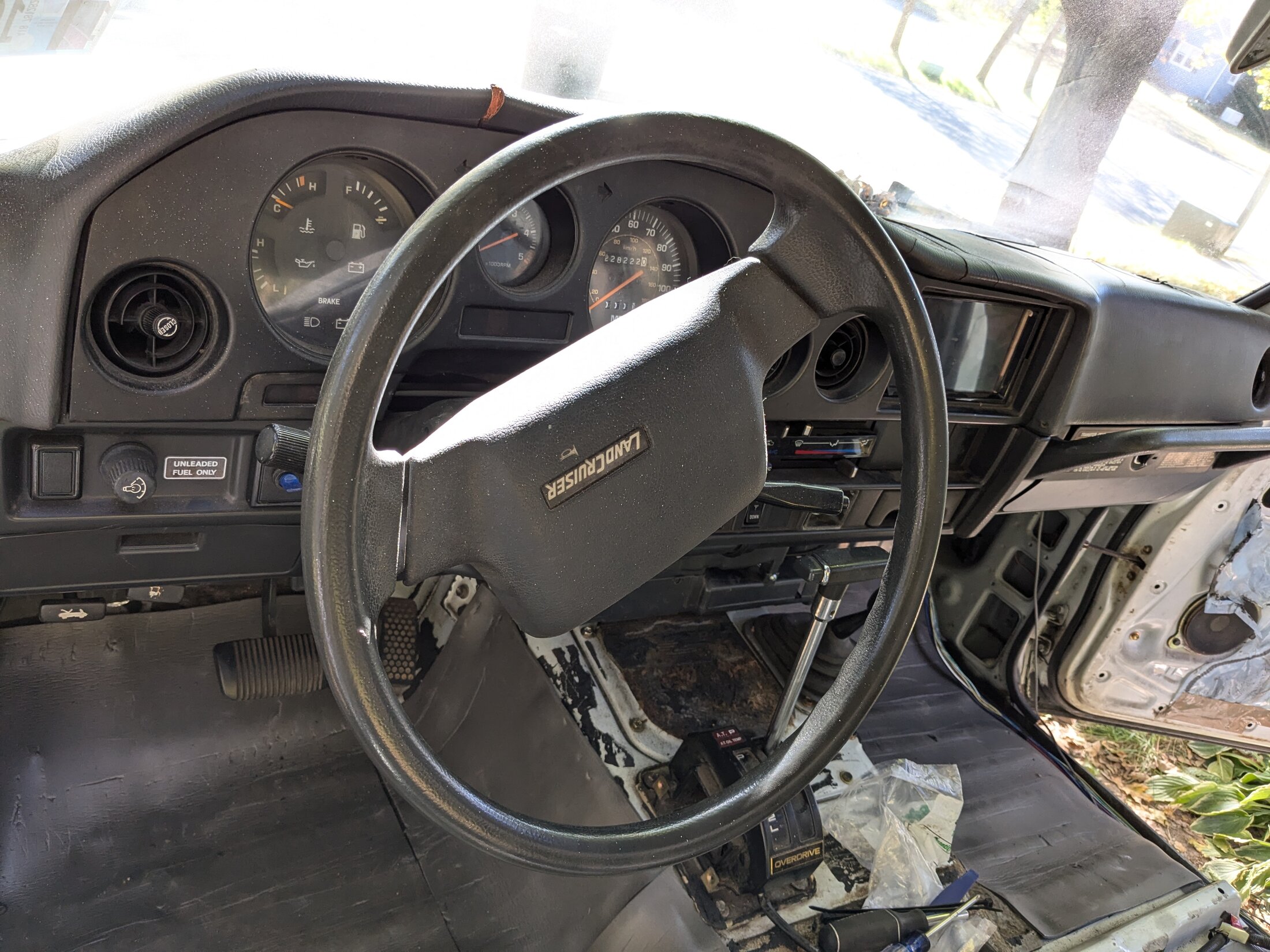

Mostly interior is in. Couple areas where I have to tack the carpet. Install the dead pedal or deal with overspray.
I placed the seats in. Need to bolt in the passengers seat still. I also glued the dash cap, and put in the new door cards.

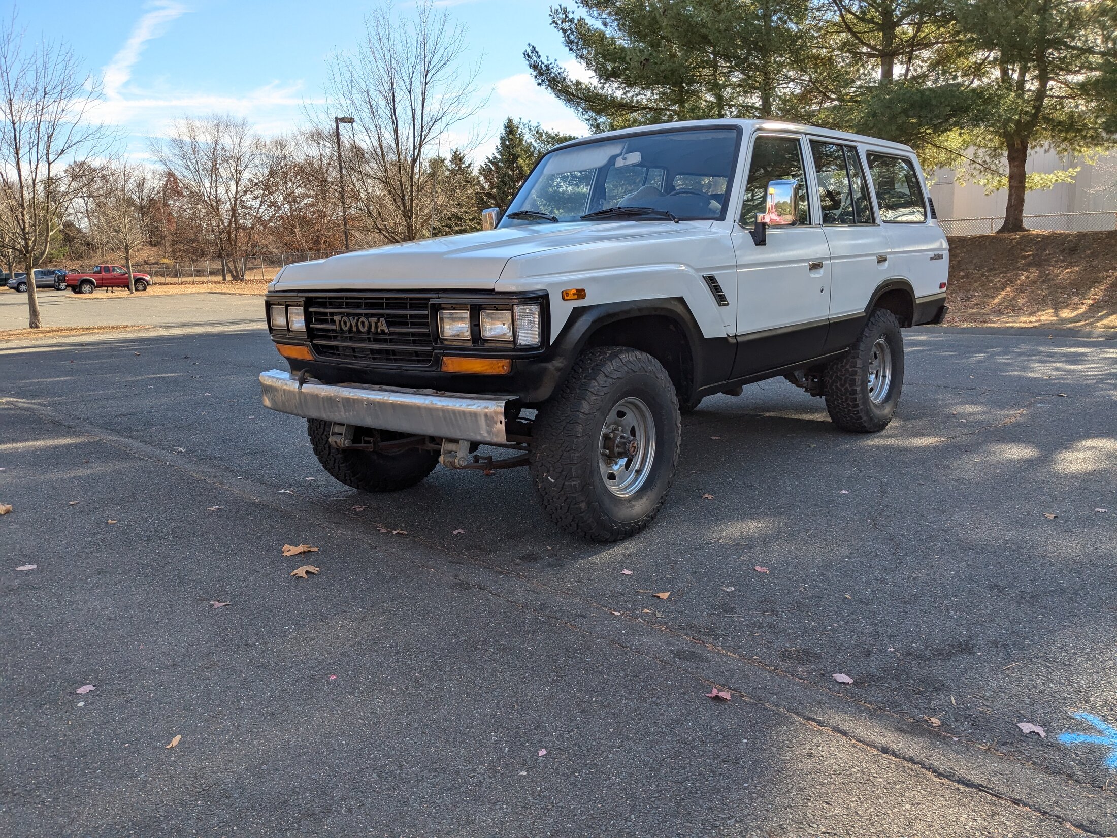

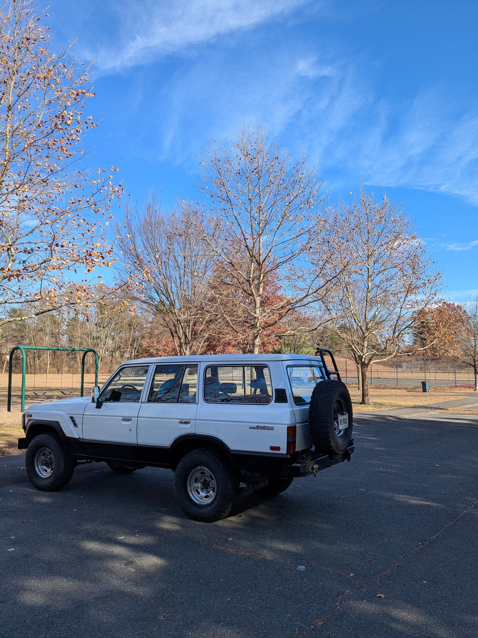

Some gratuity shots. Need to figure a few things. Wiring for blinker and right tail running light, something's off and even after bulb change they don't work.
Thermostat seems to be always open and the temperature gauge doesn't climb above 1/10th. It has a new radiator so I wonder if it needs to be adjusted, or replaced.
Need to have the exhaust patched, as there's a huge hole around the air sensor, I think it's causing it to run rich.
Handles much better after bringing tires to 38psi. 33inch KO2.
Lights and mirrors still on the way.

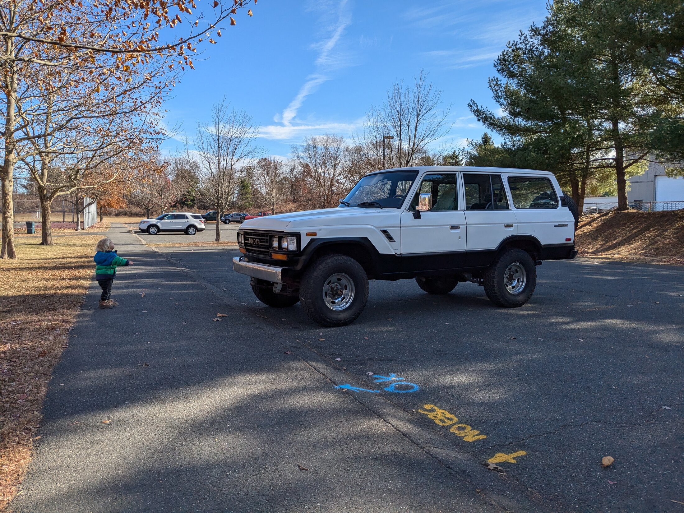

So after much deliberation, decided to list the truck for Sale. I enjoyed working on it. Made lots of mistakes, which all of you say through and talked me through. I appreciate the journey and will keep improving the truck until it sells.
Left on the list is:
1. New trunk struts
2. New odometer cable
3. Cats hollowed out
4. Torfab headlights installed
5. Bringing back the basket roof rack
6. Cleaning and installing the awning.
7. Touch some primer areas where rust fixes were applied
It's gotten properly cold, and after doing some exhaust work. I'm solidly frigid in 10 degree weather.
Lately managed to do the exhaust up, mostly. Fixed blinker/rear taillight issues, and undercoated the frame.
Currently asking 17k. Let me know if that is reasonable price.
