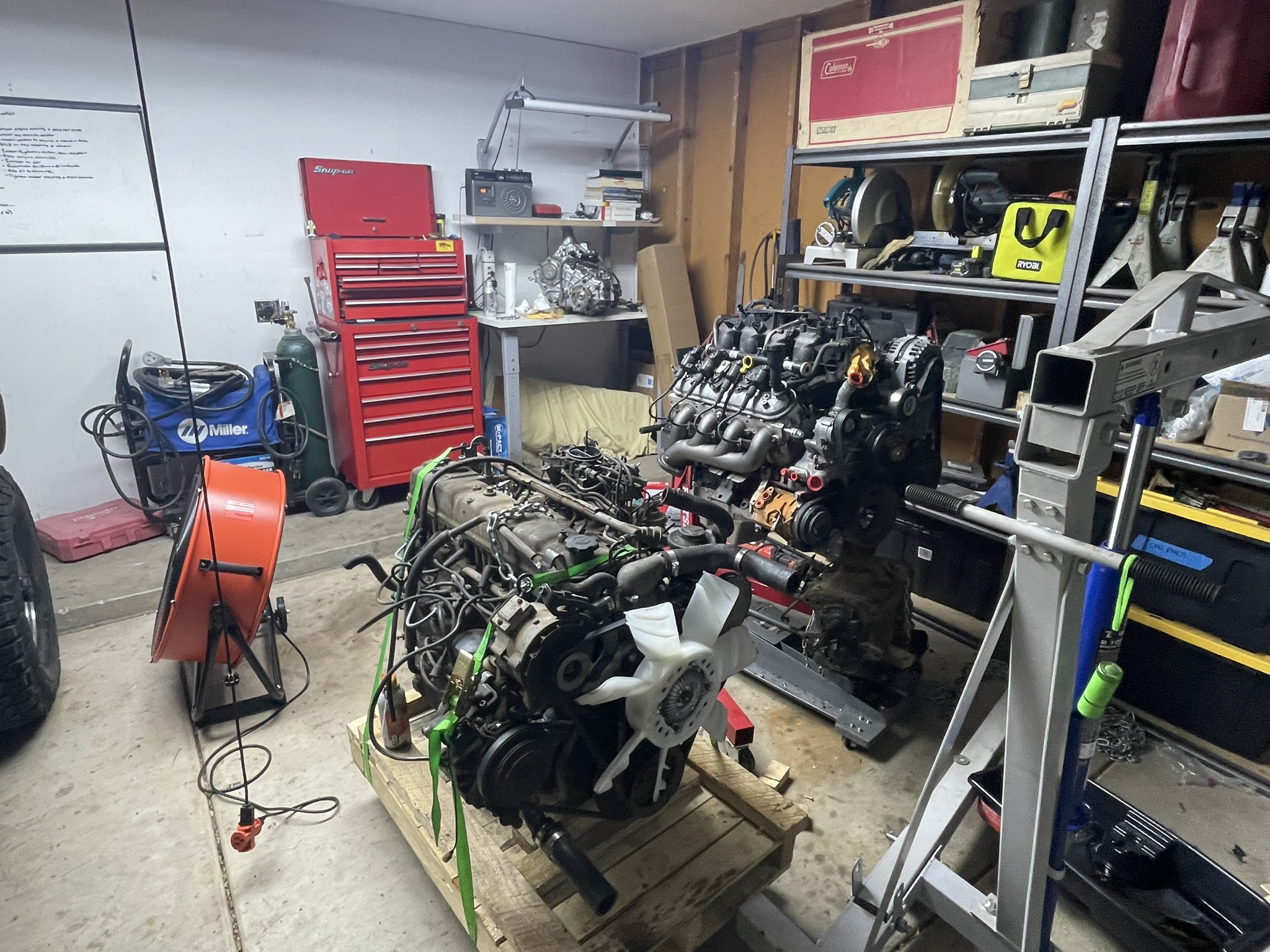

With the tranny and TC now situated I turned my attention to pulling the original drivetrain. I started by dropping the transmission out of the bottom on a trans jack. I could've pulled it with the engine but honestly with the TC disconnected it was just four bolts to separate them.
Teardown on the engine happened really quickly
And before we knew it we had liftoff!
Got it on a pallet for the new owner to come pick up - for any purists reading this don't be too sad to see this engine go. It was sold on Saturday to a gentleman who will be using it in a stock 78 FJ40 to get it back on the road.
Here's the old vs new:

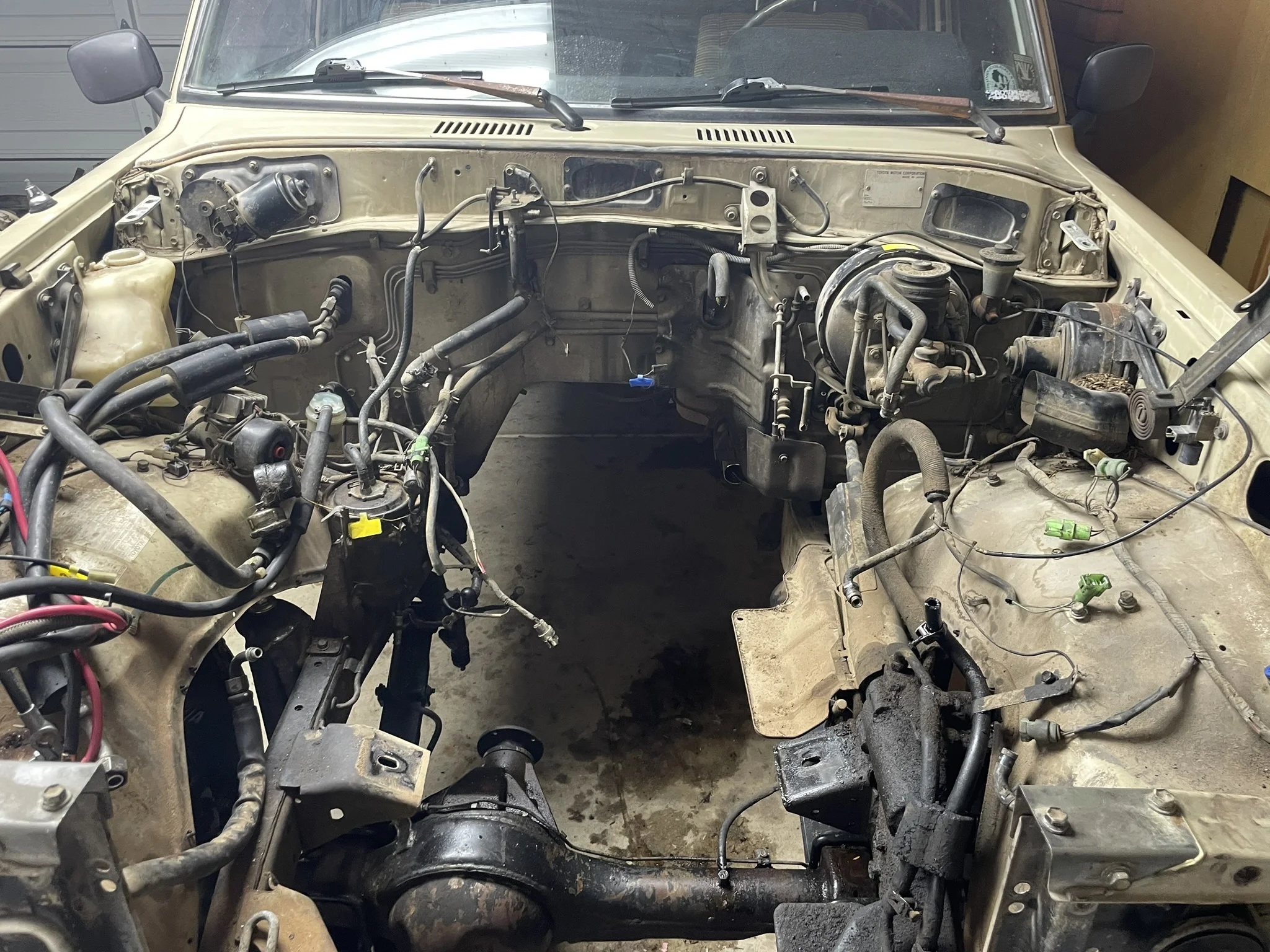

Engine Bay Prep
Started to remove all the stuff I'm not going to reuse in the engine bay, and a local Toyota enthusiast (who will hopefully be joining Mud) offered up his plasma cutter to get the engine mounts off. Got the mounts off in a jiffy
Still have to do some more engine bay prep, but am really happy with where things stand now.

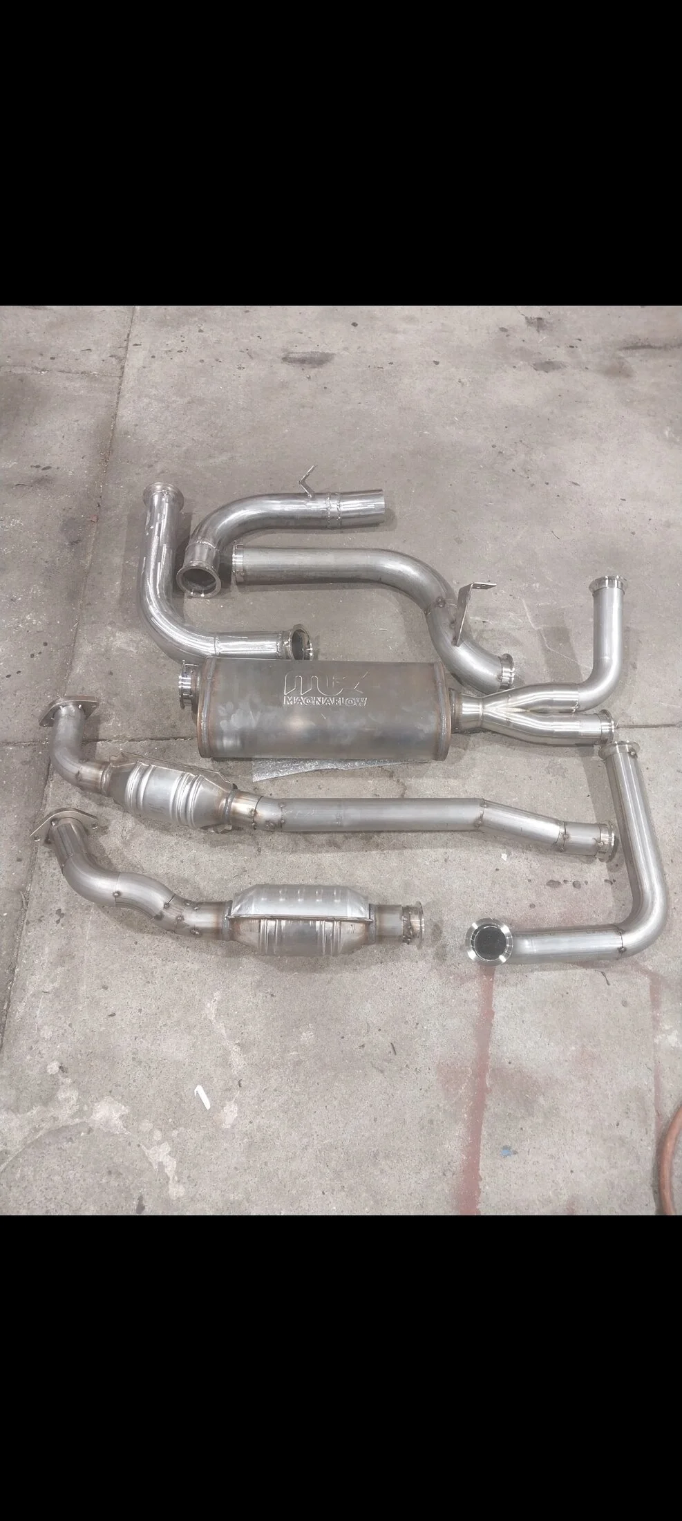

What are your exhaust plans?
Very nice. I’m at $10.5k without a LR tank or h55.
That's not bad! I was also able to recoup some funds from selling off the old drivetrain as well as some other parts which helps alot.
That is the only thing on this build that I'm not going to do myself - there's a really reputable shop here who has done quite a few exhausts for LS swapped Land Cruisers. I'm going to leave it to them to build it (which is not included in my previous figure of $10k - this will be around $1,100 to get it done)
Exhaust is a pain ask me how I know
I've helped a buddy build a few and I agree, I value my time and mental well being enough to just pay for it. Major props to the guys building their own
