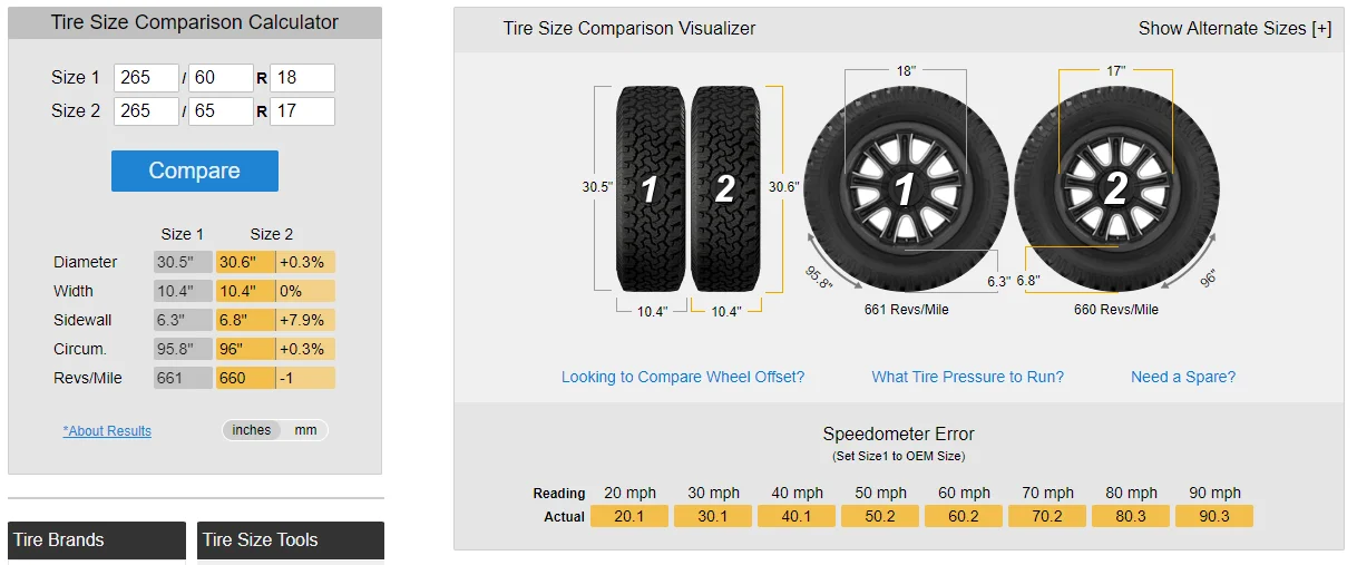

That would be tire size 265/65/17. You can fit a 265/70/17 without rubbing.
Most GX models come with 18' wheels, which use a tire size of 265/60/18. They a dimensionally (nearly) identical to the 265/65/17.

That's exactly what happened with me. I went up one size to 265/65/18 and now my speedo is bang on.
Tires of the same nominal size differ actual size. There was a .4" diameter spread between the smallest and largest 265/70r17s I looked at. Tire Rack has actual sizes.
