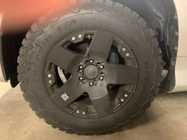

My 2010 GX460 came with some stupid (in my eyes) rims and tires (KO2s) that make a lot of road noise. Please don't lecture on "it might be something else." Its the tires.
I have purchased new tires but am wondering if the rims could be amplifying the sound. Anyone have any real world experience here? I've been looking for stock rims but haven't found anything close. I don't want to mount new tires and have the same problem.
In all my years of modifying vehicles (e.g.: many, many rims and tires combo's, street and off road) over about 45 years, I've never heard of nor had any issues of rims amplifying, resonating or any other noise anomalies associated with rims.
The tires you have on there look like mud terrains, and for a fact mud terrains make noise. Some more than others. The quieter ones like the BFG M/T's are pretty quiet until they're about half tread life.
But I can guarantee you it not the wheels.
I bet you can find someone pretty quick to buy those wheels and tires off you! I'm sure there are many out there that would love that color/style combo, then you can get want you want!
All else equal, rims would not change tire noise. Increasing rim diameter and thus decreasing tire sidewall over stock, could, as well as the specific tread type and wear of those tires. The BFG's you have are not (by all consensus I hear/read) a "loud" tire, so perhaps they're worn poorly or you'd prefer an all-season/highway tire like your GX came with from the factory.
The problem is there is some curb rash on a couple of the rims. I will attempt to sell, but that is dissapointing.
Thanks for the advice!
