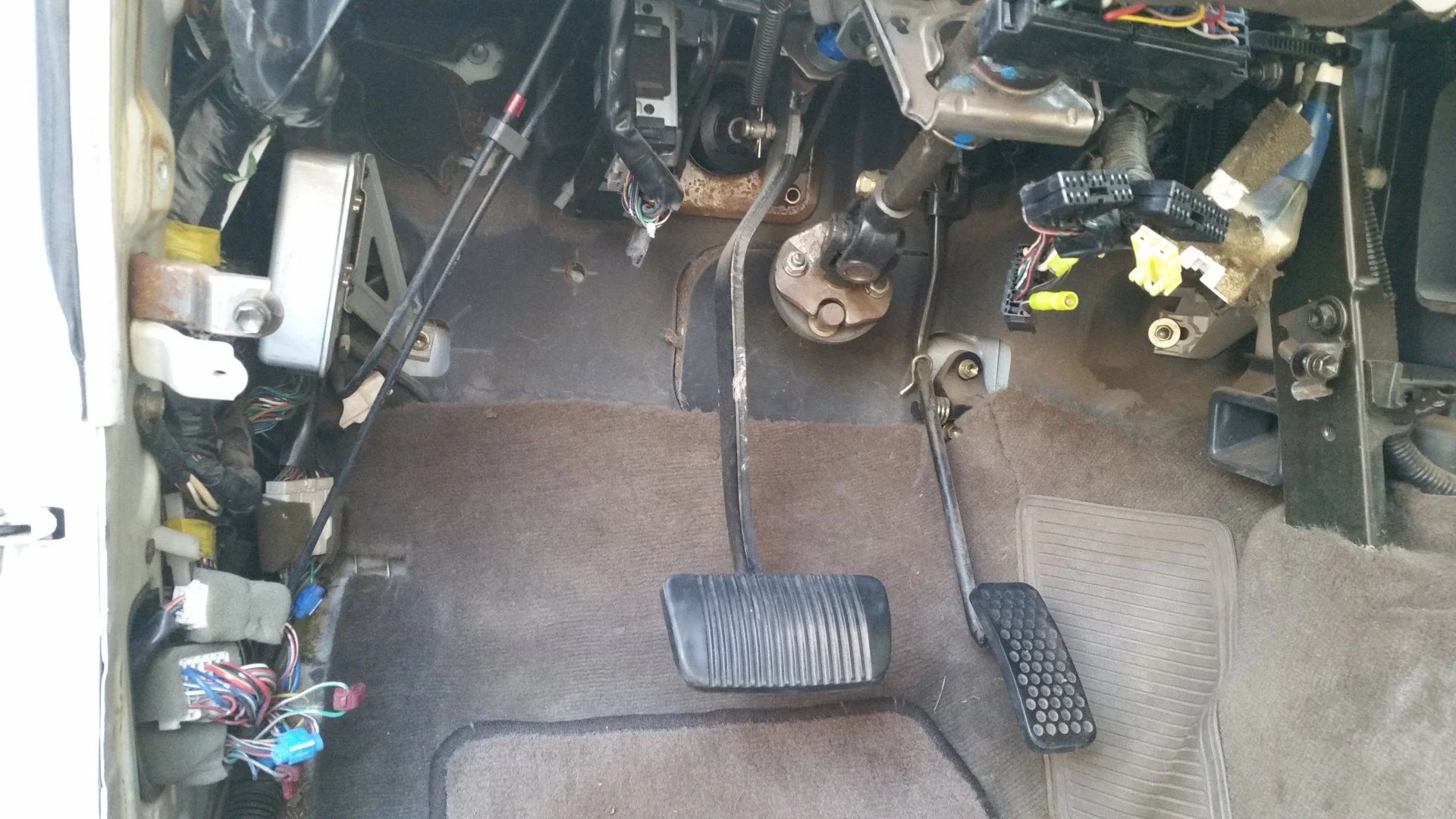

Does anyone have a pic with a wheel off, a column removed or how it mounts?
Here you go...
The second photo shows the two bolts (near the driver) and the two studs which hold the steering column in place. The lower u-joint mounting is bolt and nut, with split washers on both sides of the flange.
The smaller two bolts, nearest the driver and outboard of the four steering column mounting positions, are for the dash panel.
If you need the bolt sizes and pattern dimension, you have to pull the lower trim panel, the sheet steel reinforcement panel and the duct to get at them. It'll take about 10 minutes.
