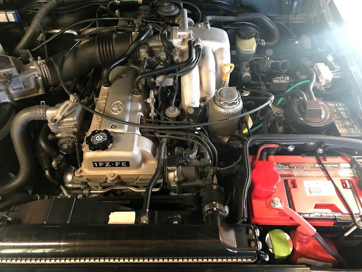

Don't fault the 4.5 for being oily it's now 30 years old. most cars are in the scrap yard in half the time. with some love it could look like this :cool:
