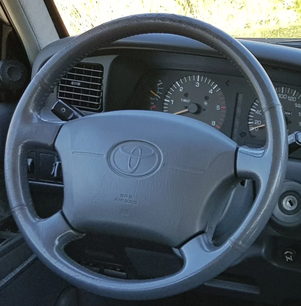

Basically I'm unsure if my steering wheel is the leather or urethane variant since my 80 is kinda poverty spec cloth interior but also the higher grade VX model. It feels like a urethane wheel but that might just be age and wear of the leather. The stitching and overlaps point towards the leather variant. Thoughts? Any pictures for comparison would be appreciated.

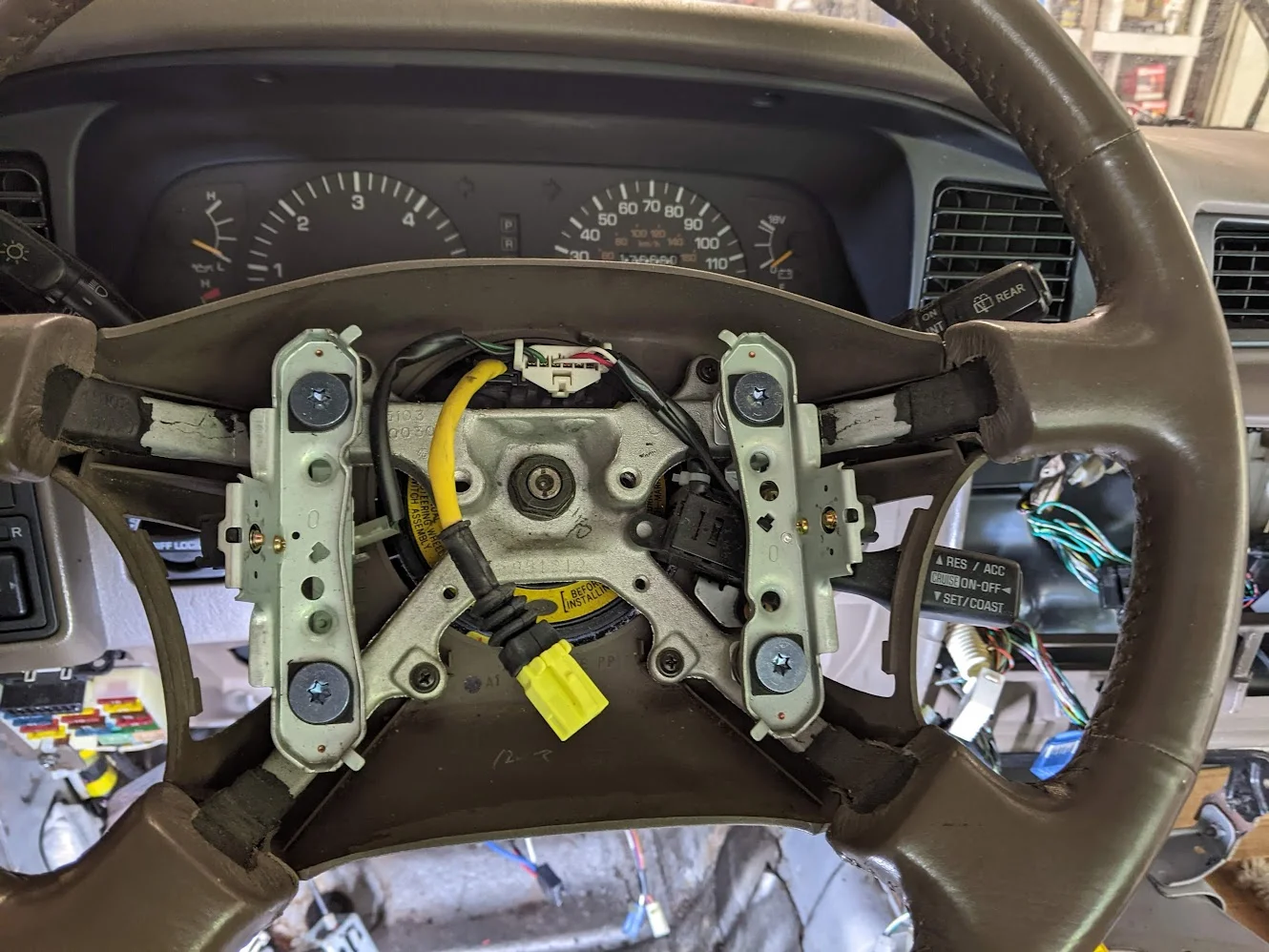

Some steering wheels won’t have provisions for mounting the cruise control stalk, FYI.

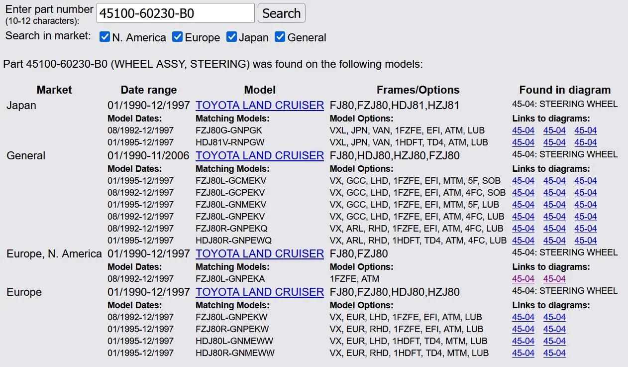

Well I would think that the raw 4 spoke wheel was the same everywhere, and the parts added on top in the Toyota assembly turn it into a non CC or CC wheel. Based on cross reference the assembly numbers were used in all markets. Mine doesn't have CC but it was optional here.

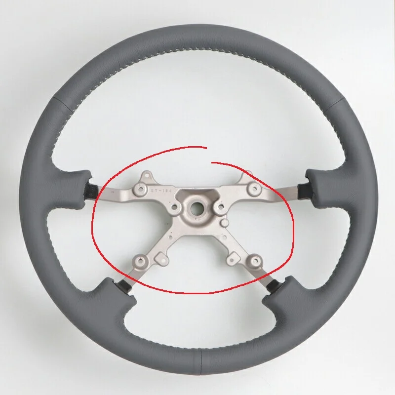

Can't imagine that this raw part of the wheel (red circle) would be different with or without cruise control but happy to learn if it is
I have a mint steering wheel from the Middle East for my Cruiser.
When I went to install it it did not have provisions for the CC stalk. I plan to make it work with some tig welding but there is most definitely 80-series steering wheels out there that lack the CC mount.
