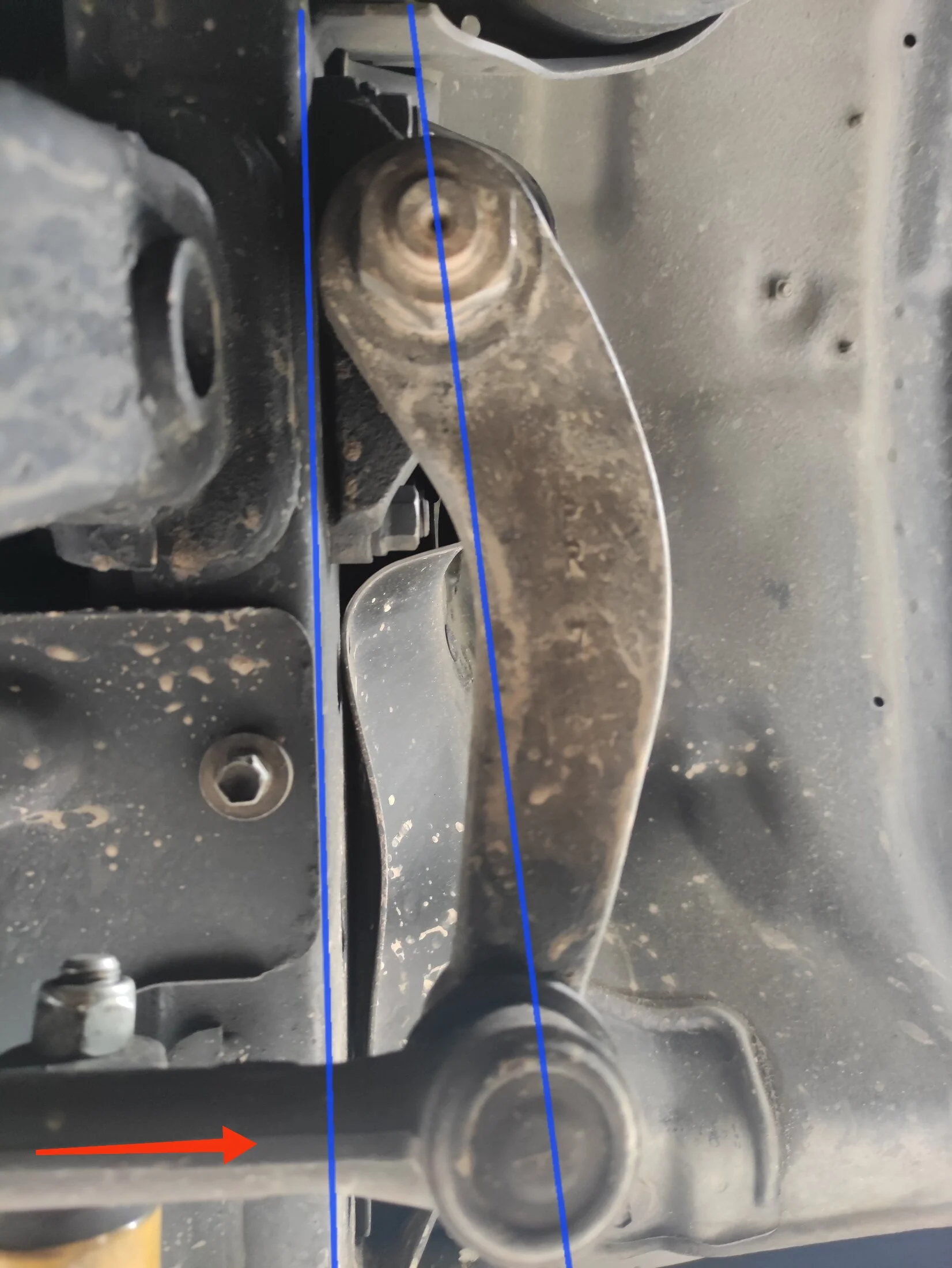

It means that I have to move the drag link to the direction of the red arrow correct? But if it throws the steering wheel off, I might just live with a quarter turn difference as the main concern is the the alignments marks align and steering box centered. 😁

My apologies gentleman, the stops are looking good and very similar on both sides. One thing I noted is that, when the vehicle is on the alignment rack I noticed when adjusting the drag link the toe will move as well.
I removed the drag link from the pitman arm and recenter both the steering box and steering wheel and adjust the drag link length so that it connects without moving the pitman arm. Then I proceed with the alignment.
So far so good. But I have to adjust the steering wheel one spline over to correct off center as adjusting the drag link alters the toe alignment. The left and right turns lock to lock are 1/2 turn off. I can live with that.
Either your measurement technique is not correct or the tie rod ends need replacement as toe only changes when tie rod length changes.
