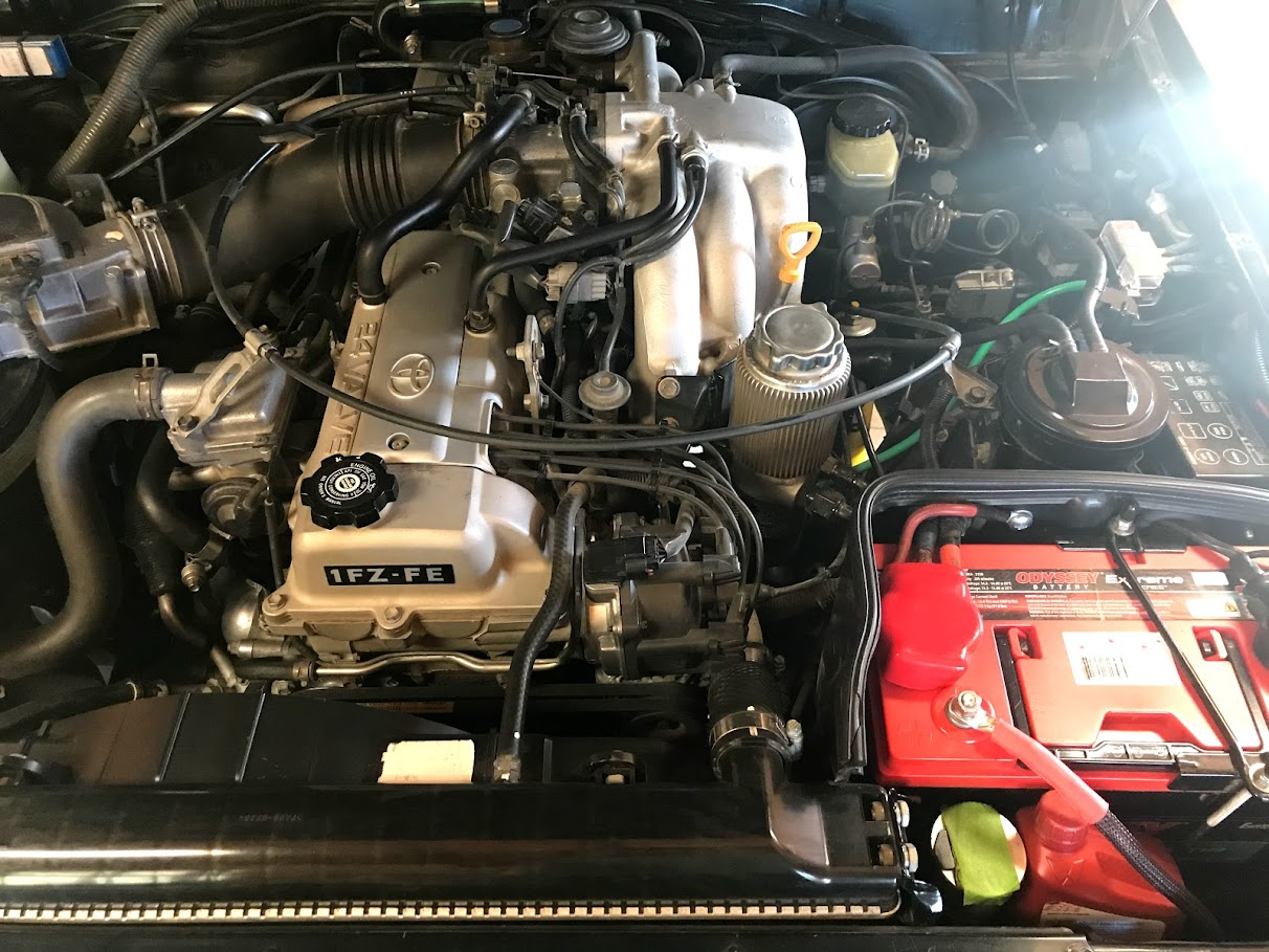

Don't fault the 4.5 for being oily it's now 30 years old. most cars are in the scrap yard in half the time. with some love it could look like this :cool:
**Just Get the Nipple Protector since you already have the Catch Can.
Sheesh that thing is Clean!
Mine has New Radiator too - as do most as they are 25 years Old.....Going or Already Gone.

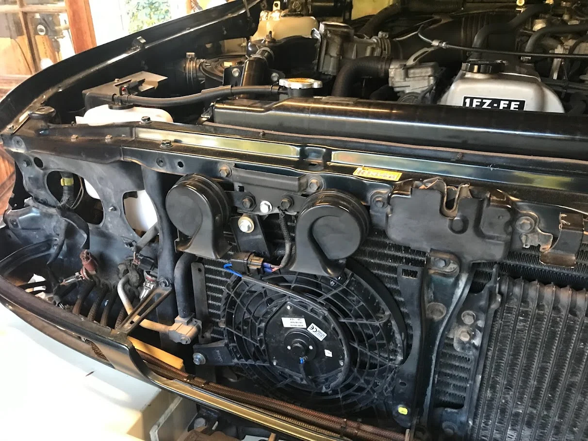

LS 400 horns are plug and play and 100% improvement. got then cheep on Ebay

Are those plug and play as in no wiring modification needed?
I can’t see them being as good as LS 400 horns
