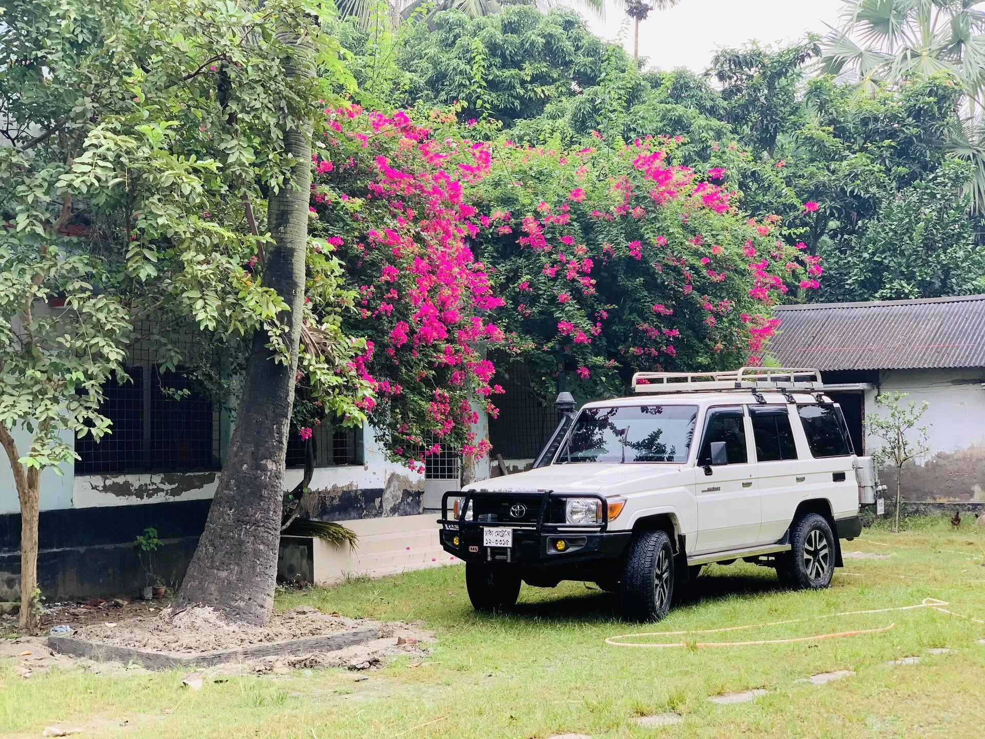

If you’ll read the ‘MUD guidelines (Page 4, paragraph 3, subsection 2A) you will see that a photograph of your Land Cruiser is required before you can submit a question. 😁
I really didn't know about this rule. Beg your pardon. I have now attatched the picture.
You are now in full compliance of all of the applicable rules. 😊
Love the 76 Series. 👍

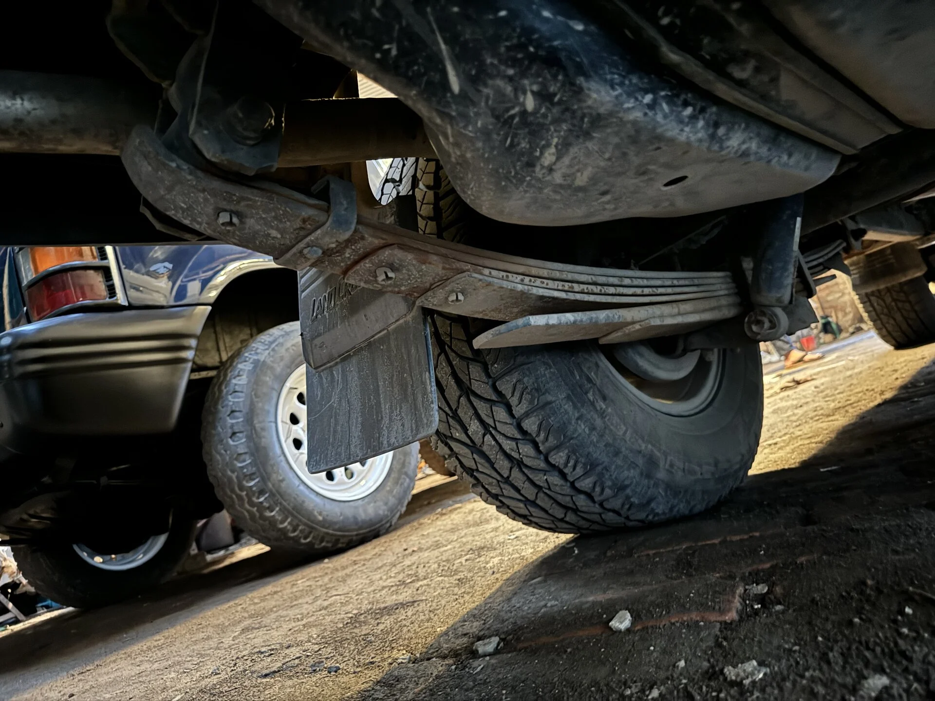

Mine is stock from Toyota. Its already 120,000km on the clock but still going well but its bumpy and stiff. I have attached picture of my leaf pack. Do you have any recommendations?

Yes this is exactly I have been advised before. I have posted a picture of the leaf pack. Which one should I remove you think?
that looks like factory suspension,,, no doubled pairs of leafs, you might not be able to improve much on those,, they are what they are.
maybe remove leaf 4, the one above the overloads and see how you like it. but thats all i would suggest.
Yes the thick one. But would it improve much? because its a overload leaf. How about the third one?
Will I lose lift? Any way to compensate my ride height?
Have you considered approaching this in steps? Your picture implies factory springs with miles on them which might be as soft as you are going to get
For example,
Step 1, upgrade the shocks to new high performance models. => test drive for a month
[If upgrading the rear bumper to provide better protection from other drivers in urban traffic and utility when in the country ...?]
Step 2, upgrade the rear bumper to a heavy duty multi-option model. => test drive for a month
Step 3, remove a leaf from each spring pack. => test drive for a month
i.e., Define a plan that makes sense for you and your needs, then follow through.
Good luck. Your Cruiser looks to be in very good shape, kudos.
Thanks dear.
I got lucky to have the 76.
For example,
I think in its year of usage, it did't face any overload abuse. But you have given a great plan. I was also planning for shocks but thought I need to make the weight ratio right first. There are too much washboard roads and potholes in my country aswell as and south asian neighbour roads so I was looking for good shocks with valving corrected for these kind of roads. Which one do you suggest? Iwas looking into koni raid and bp51.
