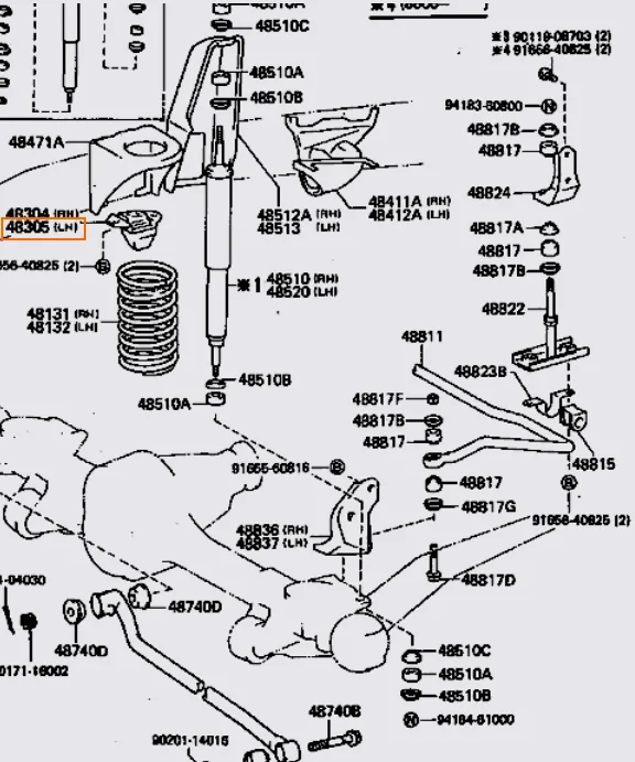

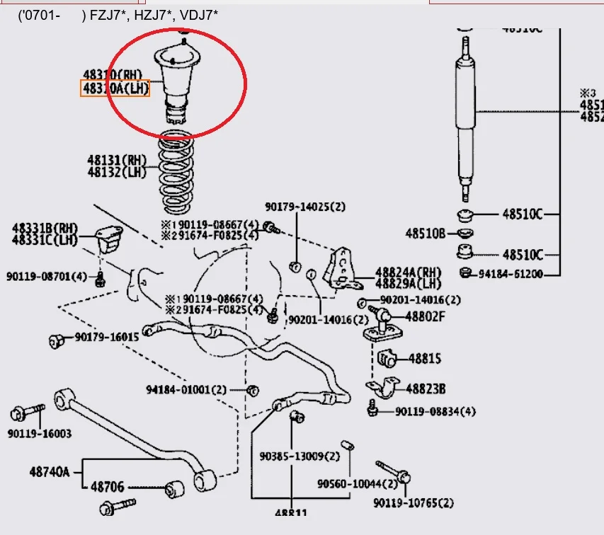

Late and Early styles.
Thanks for the parts diagrams. My LJ73 doesn't have keepers on the front or a sway bar on rear. Plus I have two different style shocks on the rear than what's on the front.

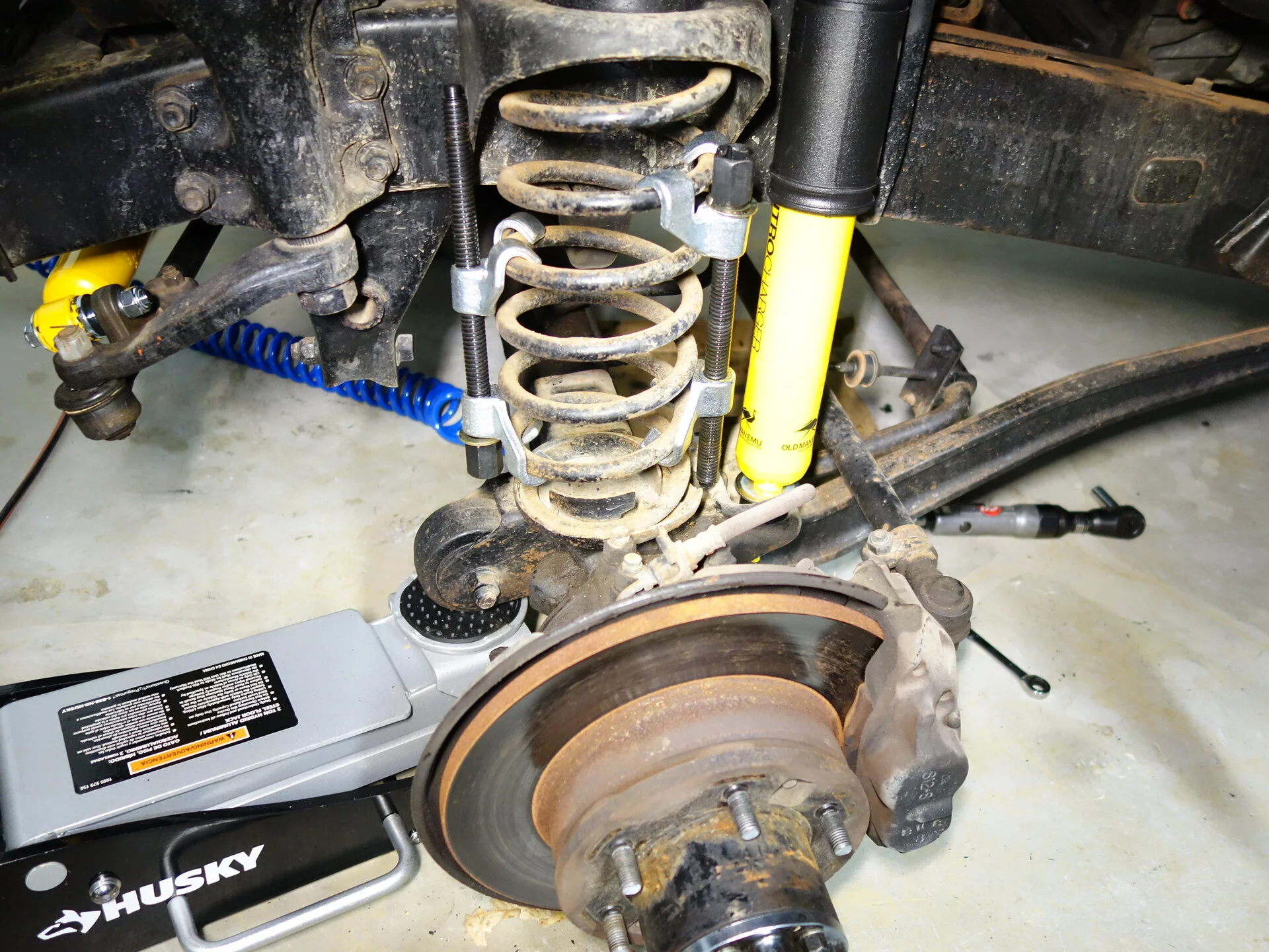

I have jacked up the left side and placed a safety jack on the frame behind LF wheel
Removed bottom shock bolt and sway bar bolts
Lowered the floor jack holding the LF axle and dropped it as far as it will go and there is still tension on the spring
I placed spring compressors on but there is crap in the way so I can't get them set exactly opposite each other
Looks kinda sketchy so I have not tightened up the compressors yet
Hoping someone has gone through this and can verify what I'm doing is OK and safe
Looks like I'll have to compress new spring 1.5" to get it to go in too (when I put it up against the old one in there)
Never changed coil springs or used a spring compressor so want to make doubly sure I don't screw the pooch and hurt myself

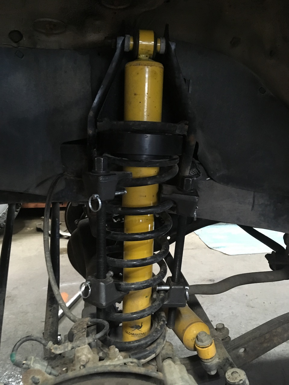

As long as you can get the spring compressors pretty close to opposite each other you should be fine. Looking at parts diagrams you may need to completely remove the shock to get the compressors on fully? Is your LJ73 a pre-1990? My front suspension is a little different, but here you can see approximately where I was able to get spring compressors on mine.
89 (see my sig) the threaded compressor rods end up running into the upper bracket or bottom out on the lower shock bracket. I can move them a bit closer together to clear obstacles. Yours are much closer together so I have room to do that too. I assumed compressors too close together would cause the spring to bend out in the opposite direction (not safe).
Will go slow and if it pops on the old spring while still 'installed' I'll know how much I can fudge the distance.
I had the same problem with the spring compressors running into the spring/shock tower. I think the compressors would have to be pretty close together for the spring to pop out. The lock pins on some models help keep the spring from coming all the way out of the compressors too.

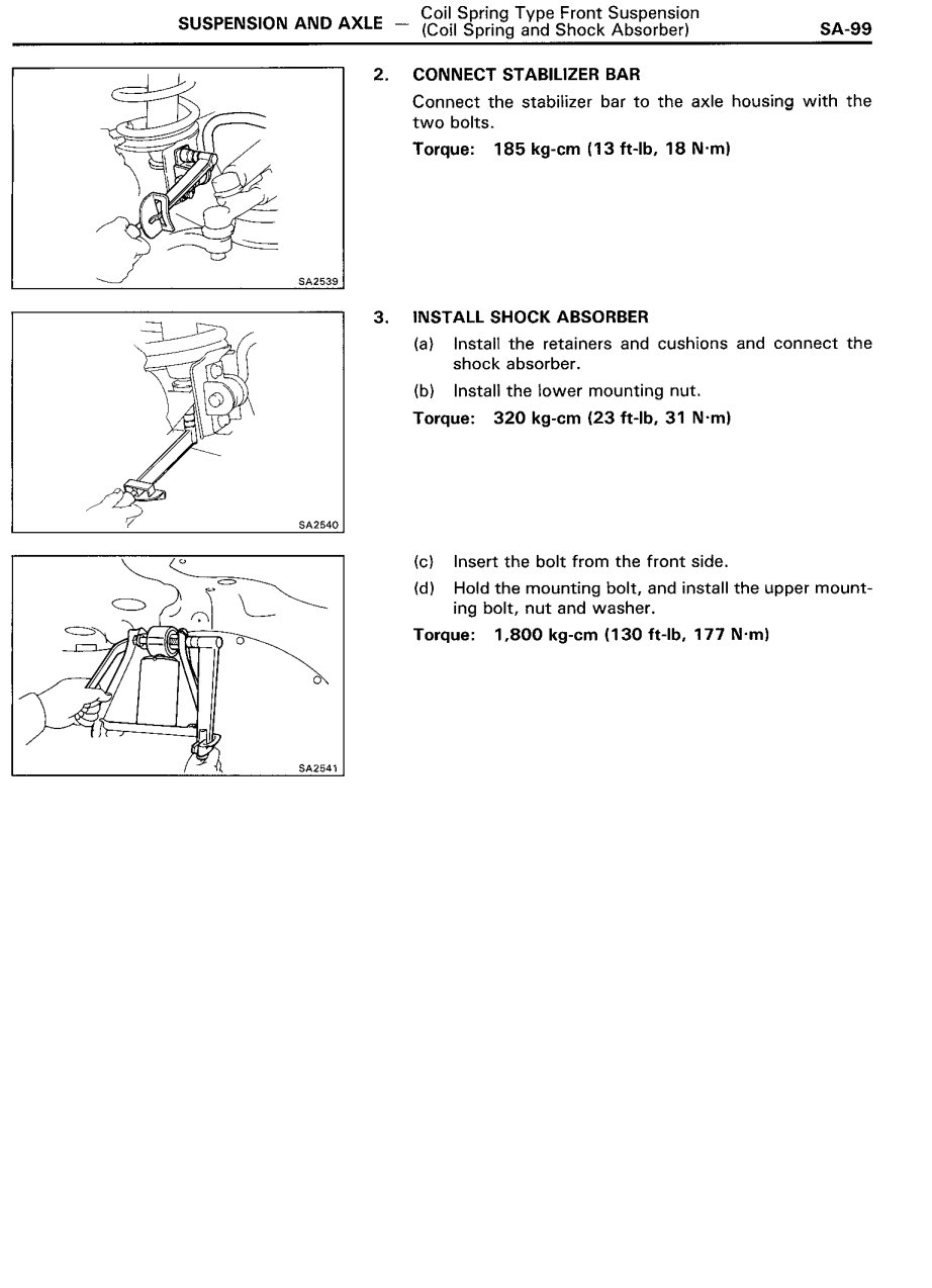

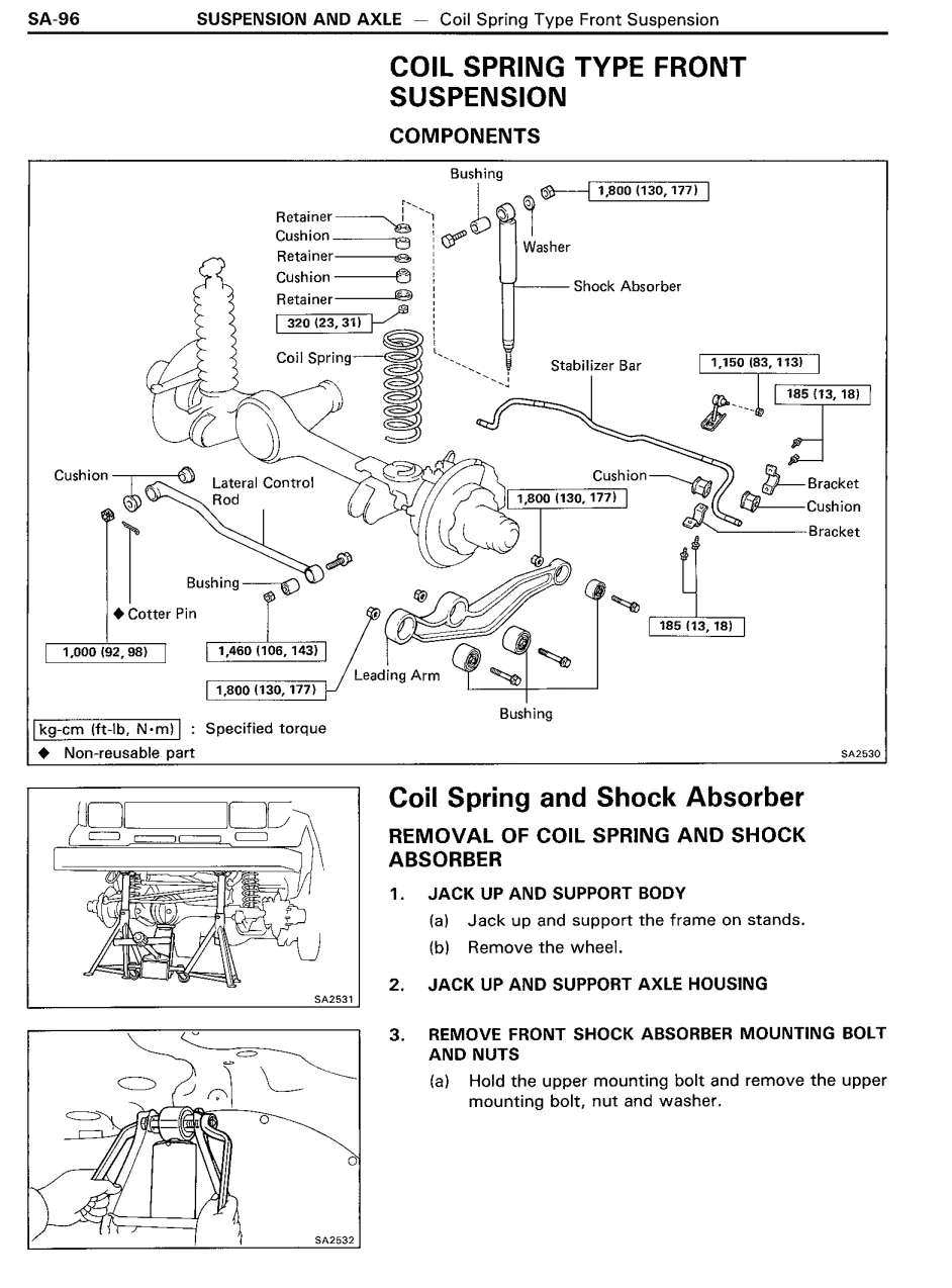

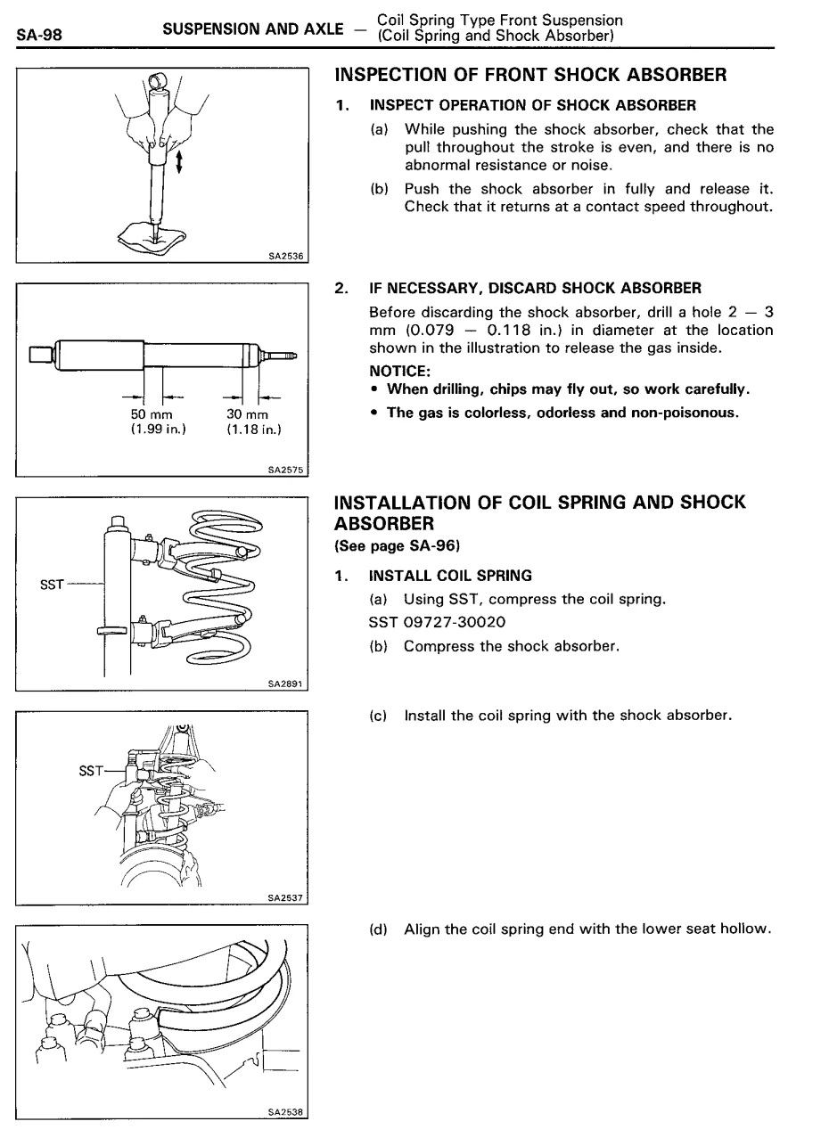

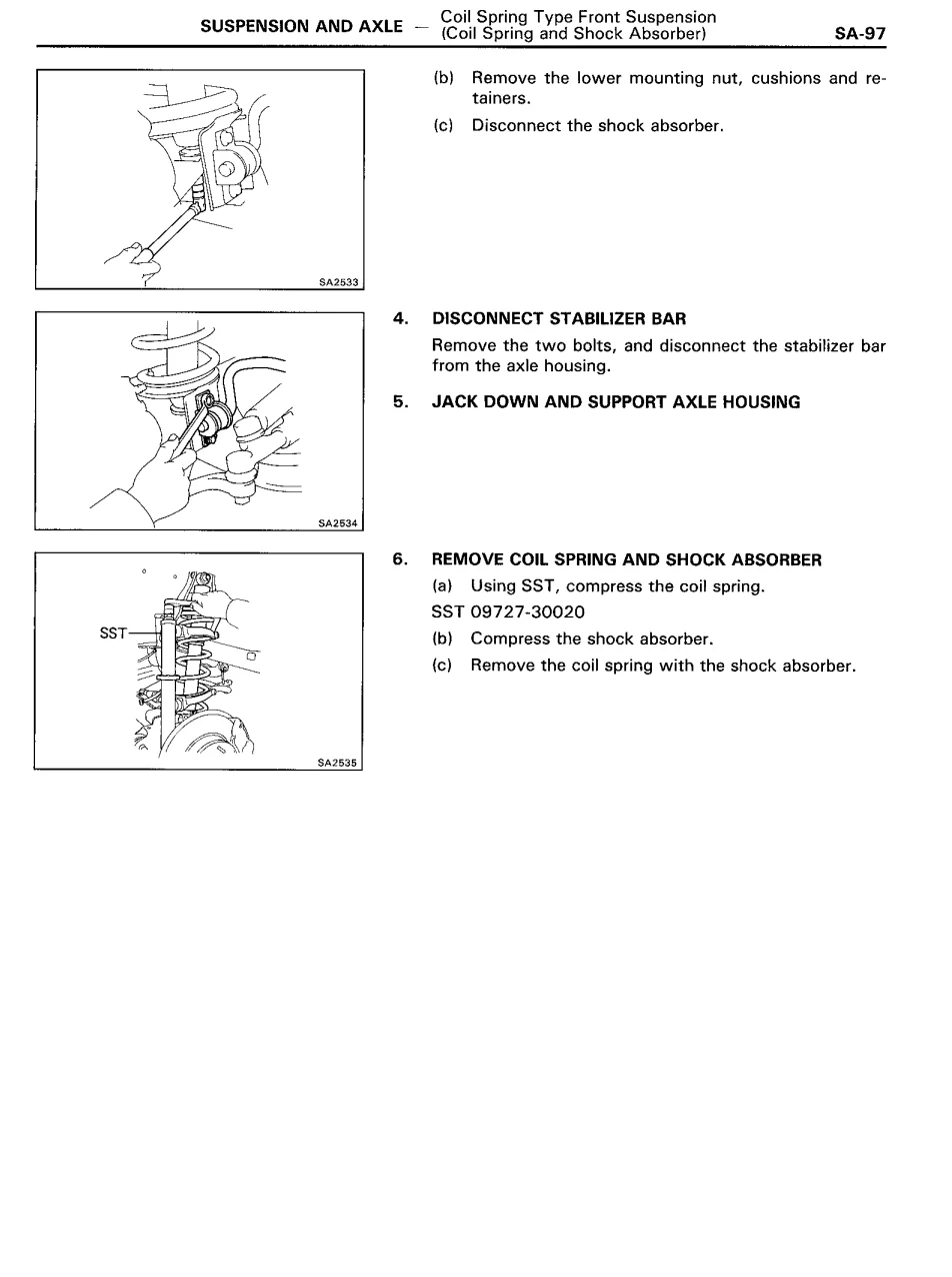

Hello,
This is from the FSM. It may be helpful.
Components.
A little more on the procedure.
Hope this helps.
Juan

Granted, if you're not used to using spring compressors they can be fairly scary. Even so I always treat them with respect, there is a lot of force involved and if things go wrong it can have big consequences. The earlier LJ front suspension is different than the 1990+ and the later HD 70 coil front; the radius arms have a different style attachment point on the frame (more akin to a Land Rover Defender) and likely behave differently when trying to get a lot of down travel on the axle. My biggest struggle was running out of travel on my brake hose, it got fairly tight when pushing the axle down far enough to swap springs.
