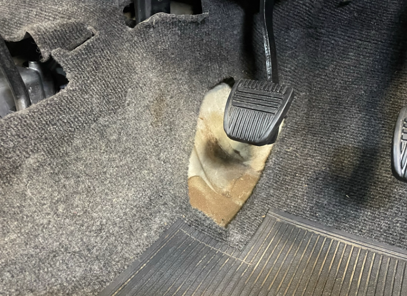

The dead pedal leave a big ugly carpetless hole in the floor. Thankfully @sleepydad69 sent me a hunk of carpet to make it look nice again. I didn't go full monty and replace the entire front carpet like he did. Baby steps here.
