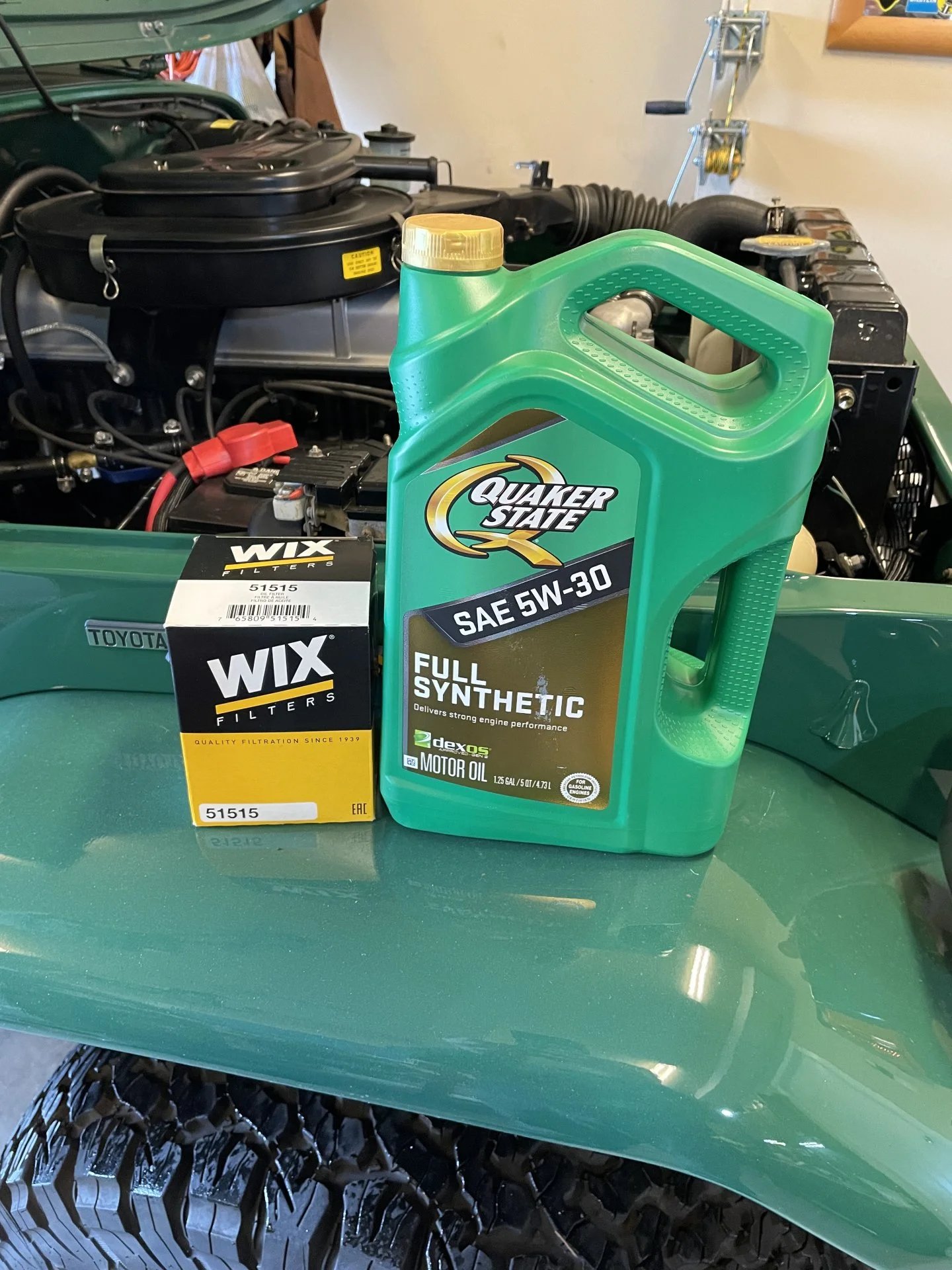

Oil change day.
After studying this information 540 RAT - Tech Facts, NOT Myths - https://540ratblog.wordpress.com/
and actually reaching out to him to ask further questions here is what I used.
NO zinc additive and straight up Quaker State Full Synthetic (QSFS) 5w-30. The highest ranking motor oil.
The article referenced above is a tough read but very well worth the time.
My engine runs noticeably quieter.

Oil change day.

What were you running previously?
Sorry, long answer Honger,...
For one, I had read that a zinc additive was necessary. It's not and actually can have some detrimental side effects. It's a commonly missunderstood additive to engine oil. More is not better. The complete package of Zinc, Phos and Moly are balanced by oil engineers, me dumping in a zinc additive did nothing good.
"The outdated thinking that high zinc levels are needed, is simply Folklore not based on the facts. No one can prove that more zinc provides more wear protection, because it is simply not true. Plenty of people will swear that you need high levels of zinc, but ask them to provide “proof” instead of mere opinion. They cannot do it because Physics and Chemistry proves otherwise."
I used the same oil filter Wix 51515 (NAPA 1515) as I've read in tests it proves to be one of the highest quality aftermarket filters availible. I do really like the OEM 90915-40002 and the unobtainum big filter from Toyota.
As far as oil weight goes, I was using a 10w-30 conventional oil, which ranks far below the Quaker State 5w-30. Some will claim that with our high volume oil pumps we need a thicker oil or that the older engines need a thicker 10w-30 or even a 15w-40 oil.... all based on something other than lab testing and science.
As far as brand of oil goes, I've tried a bunch from the most of the big names.... according to the above referenced article (which admitedly is an incredible challenge read) Quaker State Full Synthetic 2 dexos is the king. I've reached out to the engineer who did the testing and ran a few conventional wisdom questions past him. He said he's heard it all, stick with the science.
Hope that helps! My 40 certainly runs quieter now. I'll be able to test it in my 60 as soon as it's put back together too.

Here is the long and short of it. Quaker State Full Synthetic in 5w-30 is what you should use. This is based on wear studies, temperature studies and breakdown testing that far exceeds what normal individuals have access to.
Is there a good summary of the “science” (or better, engineering of what variables and parameters were used to determine the “best”), that article is terrible for relaying any valuable information. And I’ve had a wee bit too much of this “science” thingy. And my engine(s) always run(s) quieter after I change the oil.
One additional piece to note… the oil I drained out had about 1000 miles on it. So I too was surprised when I started it up and it was considerably quieter. I definitely didn’t expect any change.
