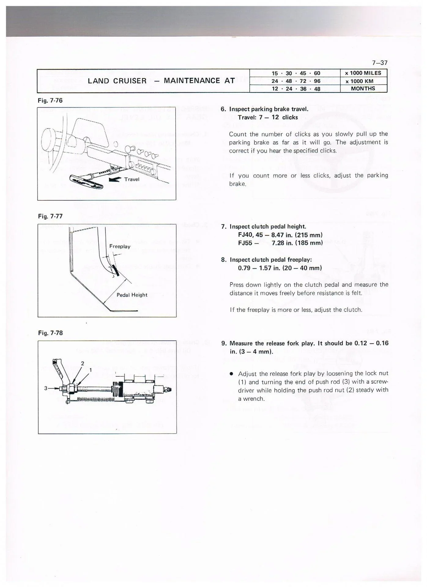

Next on the list is a clutch adjustment. I haven't touched it since reinstalling the body, and I get a little notchiness shifting from first to second. With only about 300 miles on the new transmission and clutch, it's also possible that things are still breaking in.
Adjusted my clutch, it was way off... the pedal height was about 2 cm too high and the free play in the slave cylinder was about 10-15mm vs 3-4mm
Baselining is a helpful practice if nothing else but to get reacquainted after a few years of not really doing much to it.
Parts wear and adjustments need to be made from time to time. :)
Very true, I also wonder if I was so eager to drive this after doing the refresh that I didn't spend as much time adjusting the clutch properly. All good now though, I'm going to grease some zerks and take it for a spin. Hoping the 1st to 2nd gear notchiness is better or gone. :cheers:
