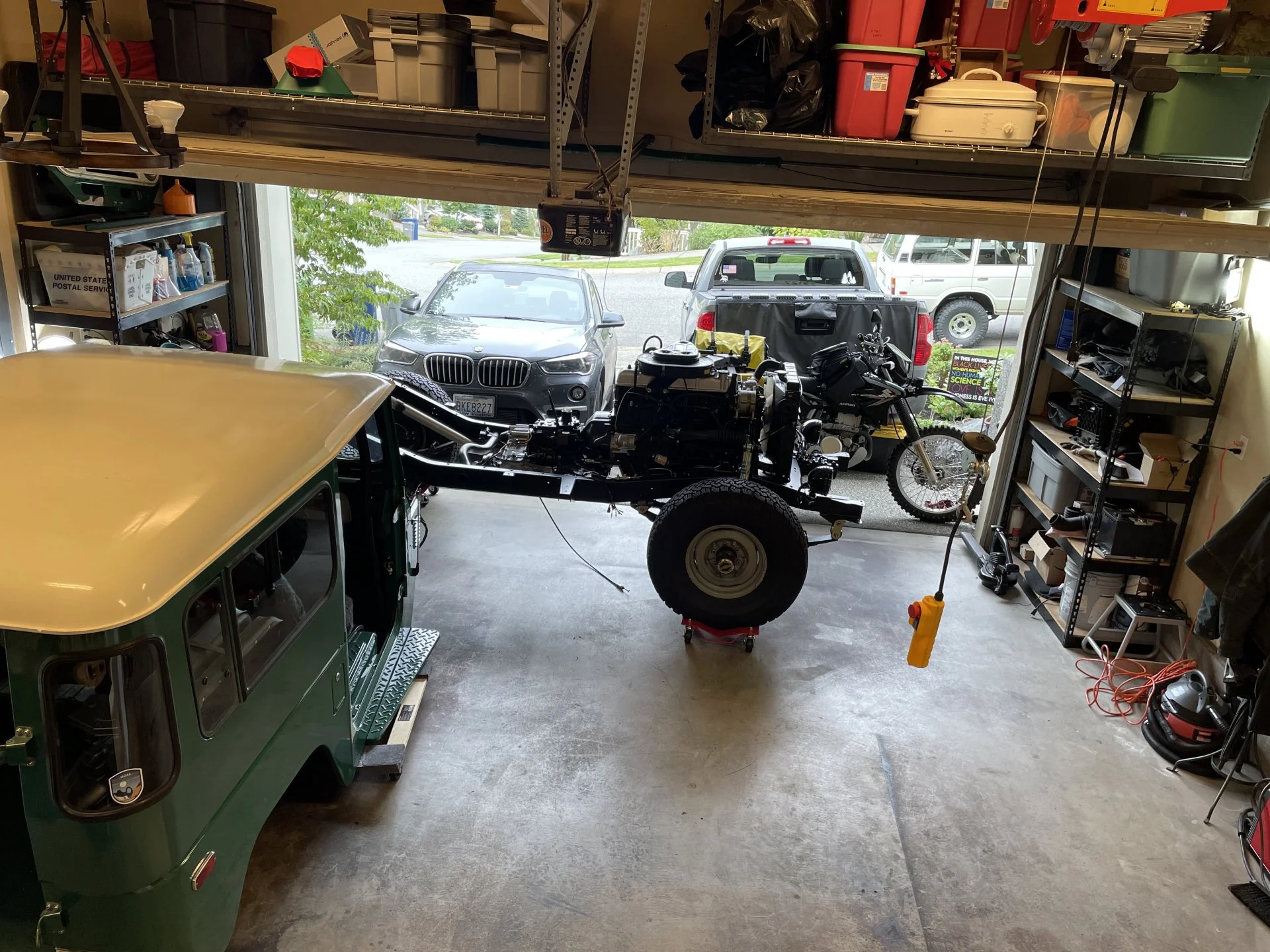

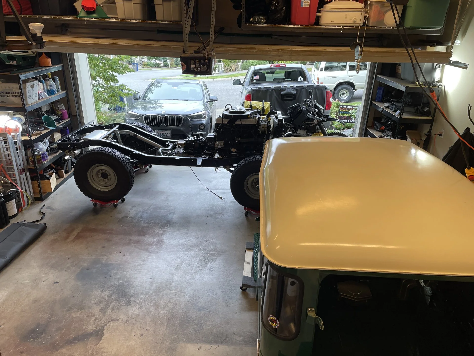

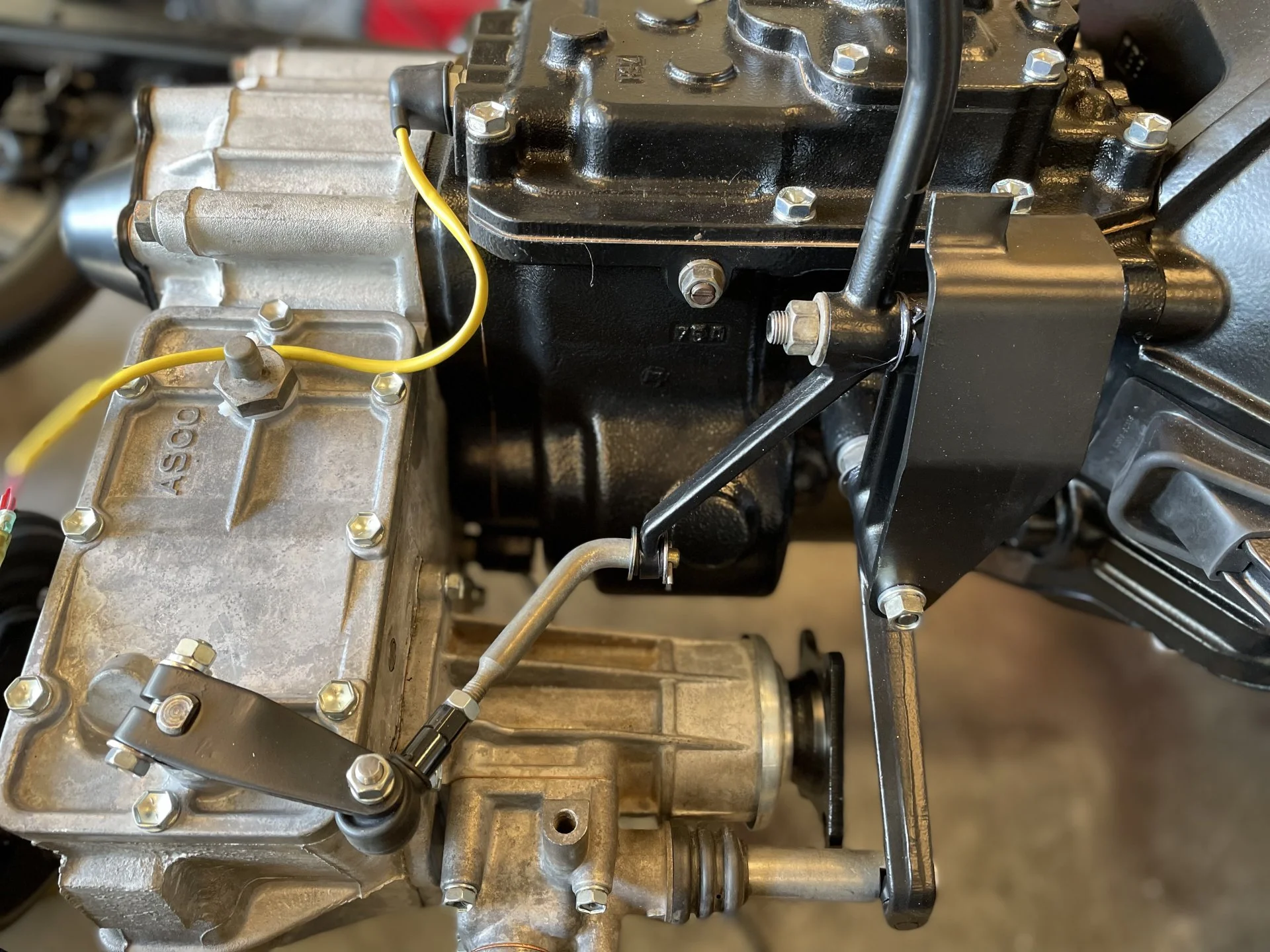

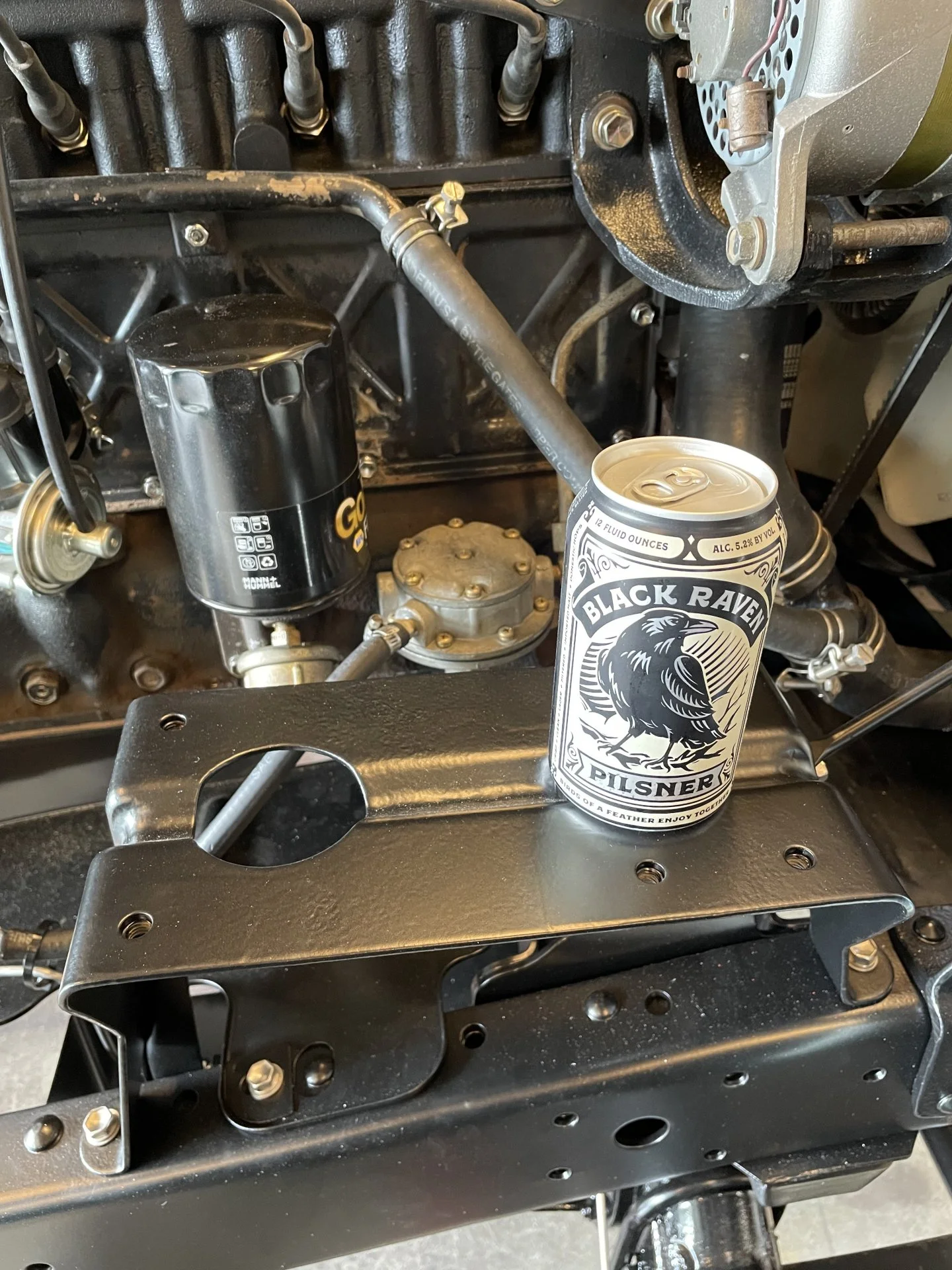

Picture 1 - Toyota designed beer holders for when you're working on your rig. They keep it stable and allow easy access. They also have designed a spot if your buddy comes over to help.
Picture 2 - I don't have emissions equipment on my rig, so I just ordered this plug for the lower half of my thermostat housing. Part number is 90344-53011 plug, taper screw.
Picture 3 - I'm replacing the body mount kit I originally purchased a couple of years ago from CCOT, which has it's advantages but I felt was missing some key elements. I landed on the Energy Suspension kit, which is extremely complete with all of the pieces you would ever want including the pads that attach to the bottom of the tub.... which the CCOT kit didn't include along with other pieces. As I organized the kit I noticed that the plastic body clips that come with the kit were too small in diameter. Luckily my local hardware store (not a big box store) has nearly 2 huge isles with automotive hardware. McLendon's in Woodinville rocks! They have just about anything and everything you'd need including a TON of stainless, metric and possibly hundreds of drawers filled with misc hardware.

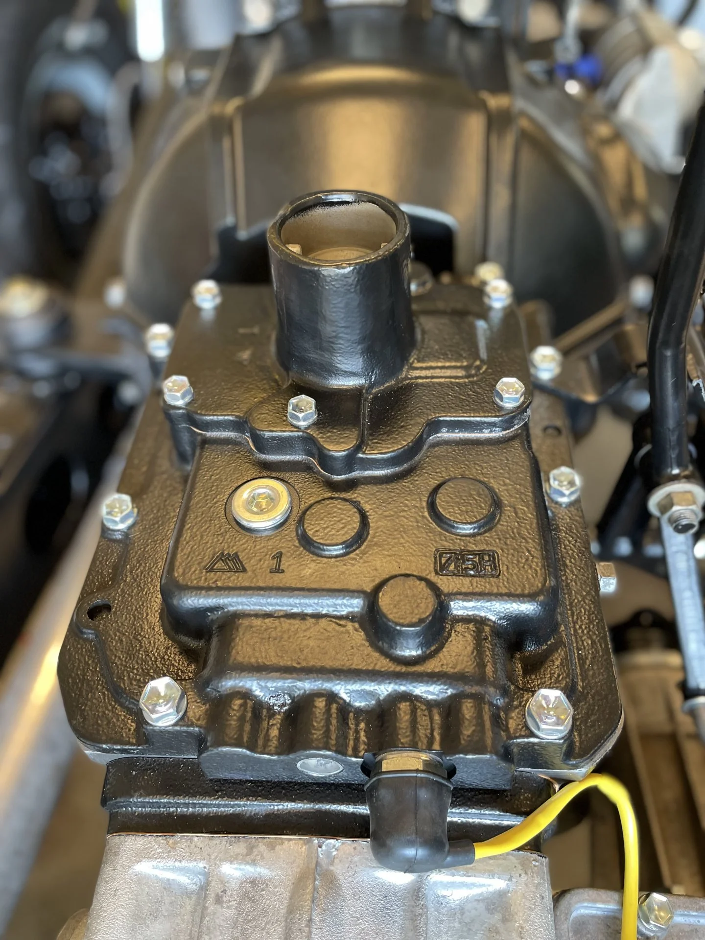

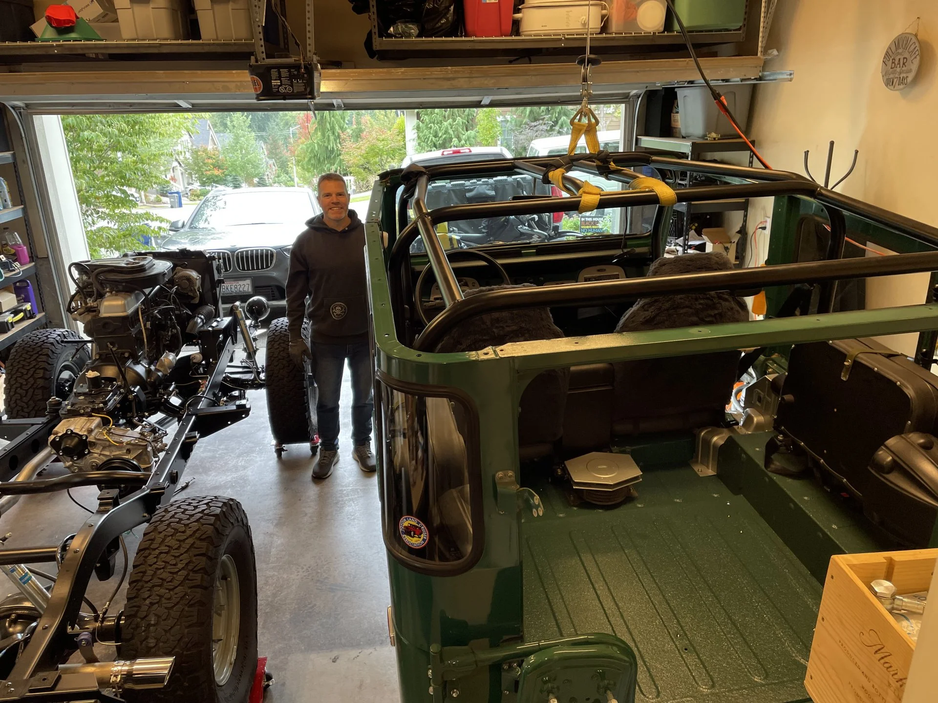

The trans/xfer case rebuild is going a bit slower than expected. Not a big deal, it gave me time to dial in other little details of this minor rebuild.

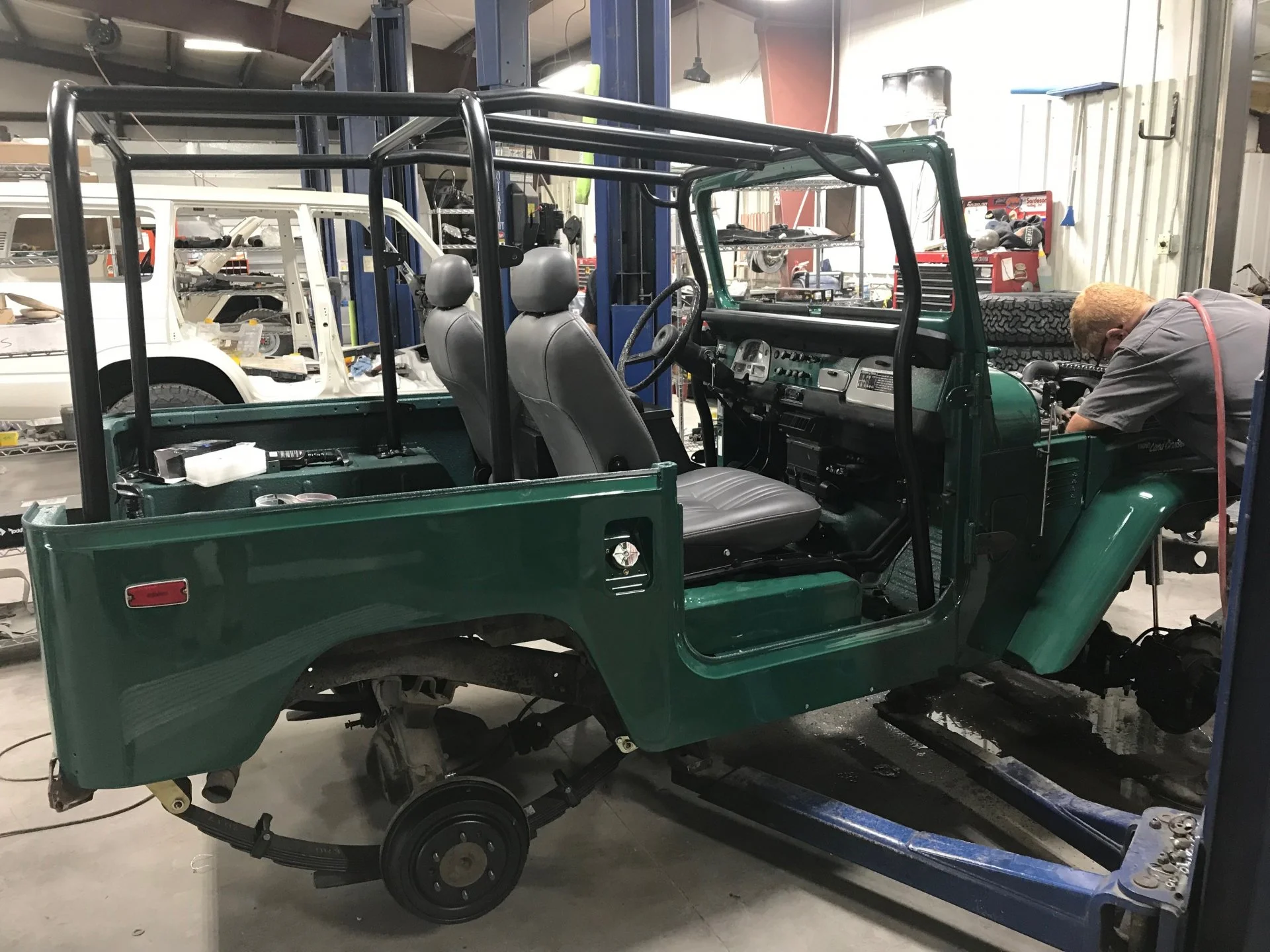

I also found some pictures that the previous owner sent me....
Before paint -
Primer -
Paint -
