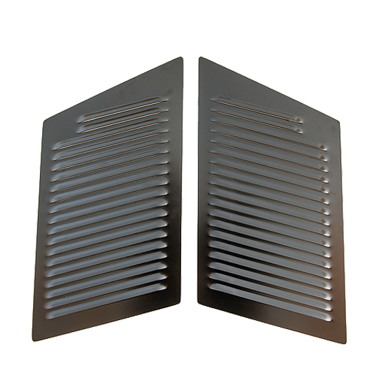

Also going to look at getting the hood louvered. Need a way to let some of the heat out when I'm moving slowly.
Cancelled my expensive PartSouq order. Chances of not being murdered by my wife: improving.
I had the same problem w/ vapor in the return line after my swap.
For hood louvers, i used these.
Happy with them.

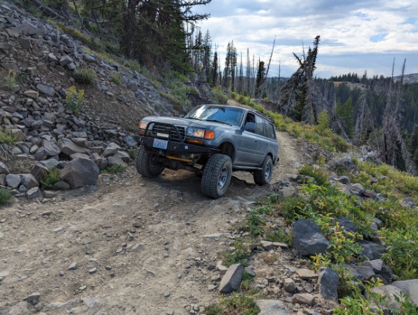

A little bit of trail grading at Walker Valley last weekend.
Well, I’m totally blown away by the fact that you didn’t s*** your pants on that drop. Cameras make things look smaller and more mellow, that looked neither. I was nervous on my couch FFS! Drove it like a Boss! 🤠
